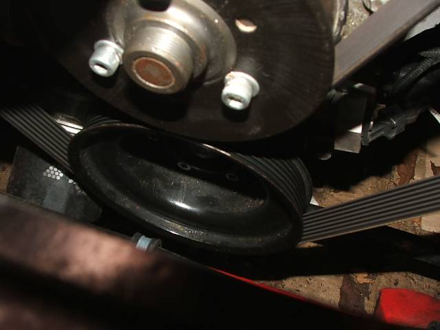

Measured the bottom pulley this evening, bit dark and awkward, SO hopefully i have got it right,
i got 6-3/4" across the bottom pulley if any one has a serp crank pulley to hand which they can measure it would be a help as mines sat on the engine in the car .
i think its too big, and im going to have to run a seperate belt and pulley for the charger

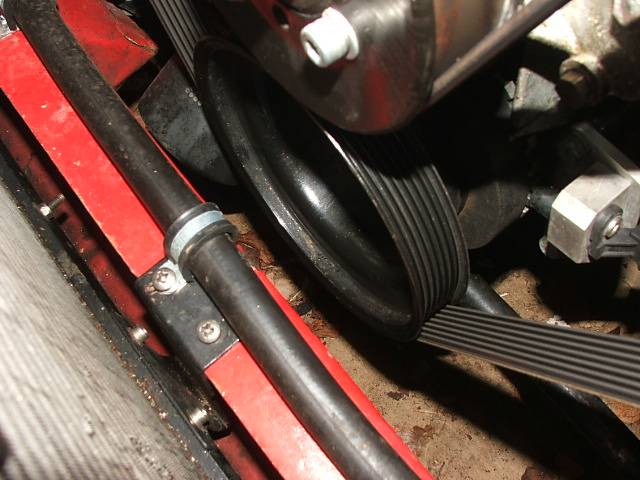

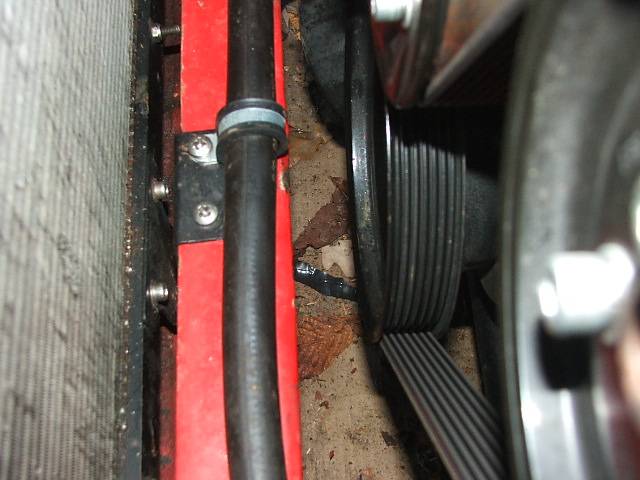

bottom pulley pics you wanted Marki,, sorry not that good mate, bit tight to get camera in

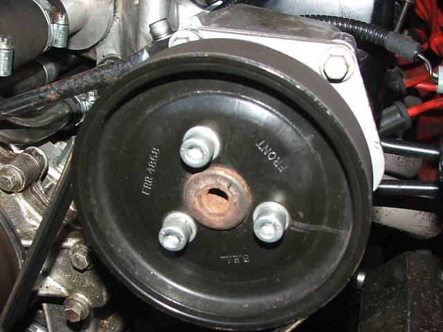

and the powersteering one on my engine which could vbe adapted for crank pulley for charger?

looks like may have a pulley combo to work to now, 5" crank (possible modded PS pulley) and a 3.75" charger pulley,
