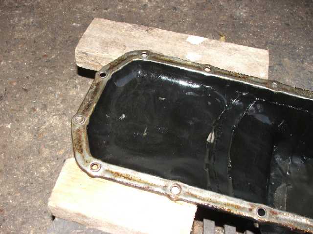

and to add insult to injury the sump had to be removed today
when building the bottom end i knew the tolerences were close crank/sump after some calcs i thought we had enough clearance,
but after doing a tighten up sequence on the sump bolts to stop an oil leak one of the front crank weights touched the ferkin sump on start up and clatered like a bitch
so it was strip the bottom end out and remove the sump and do some more panel beating
all good now and dont clatter on the sump
looking good for the mot saturday now.
