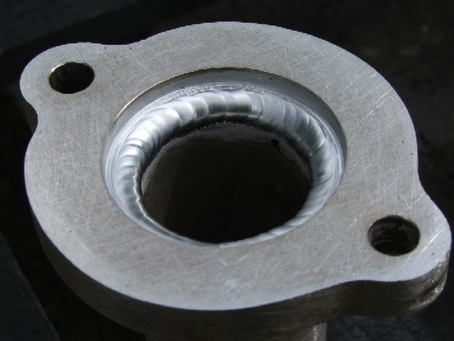

And Neil from www.caprisport.com (where my car is) sent me an email saying the stat housing has been finished and he has collected it for me,
the welding the guys did for me at the engineering shop.,
fink that looks quite pucker

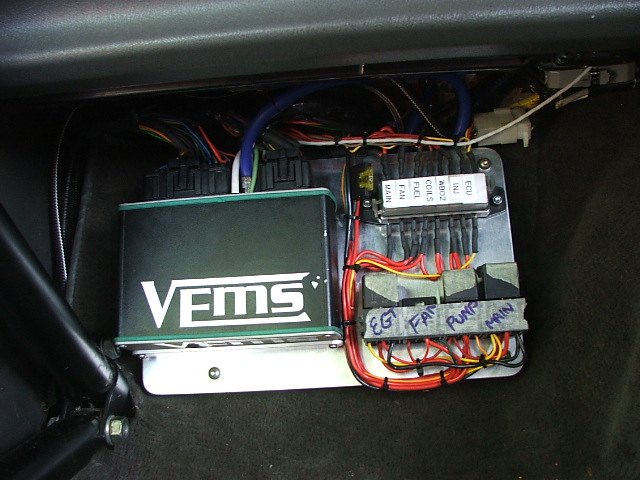

Right had another good day on the car,
finished off the wiring and installing the ecu,
ignore the masking tape on the relay bases, forgot the name tag printer, so could not change it to pucker printed lables today.

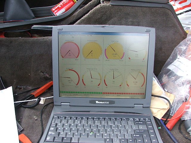

then came crunch time best i had test the system,
plugged laptop in opened MT and nothing,
tried the com port settings and still nothing,
saw the jack plug wires had crossed and looked to be shorting out bent theses outwards a bit then,
the ecu talked to the lap top PHEW
SO now the ecu seemed to be ok,

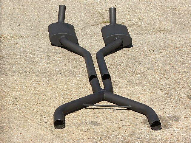

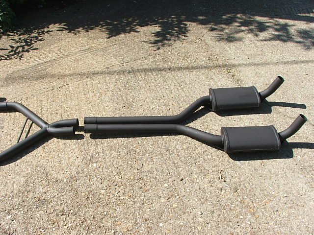

time to start on the exhaust,
The guys at caprisport went into hyper mode on the exhaust,
after stripping my old system down we came to the joint decision the boxes were fooked,
BUT they had a new system on the shelf for a customer which i now own (i paid for)

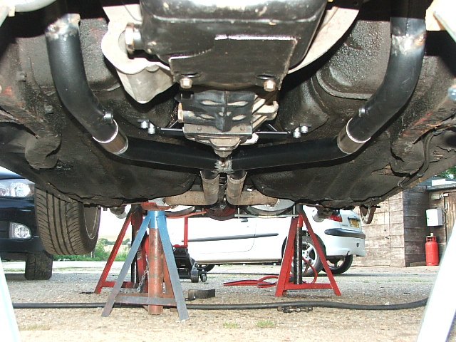

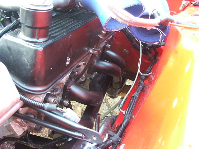

after sorting the new exhaust the down pipes had to be removed from the manifolds (hit the floor now engine and box sit differently)
Manifold on block with downpipes tacked in.,

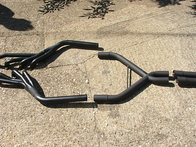

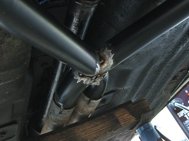

Exhaust pipes removed from box inlets and the middle pipes from my old system tacked in place to run the exhaust close together in tunnel,
and up near the down pipe the start of the 'X' pipe.
And after the downpipe interlink pipes have been tacked in place.
And how it looks all tacked up from the front of the car,

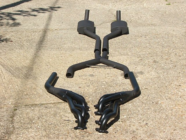

well Neil and Jon today completed the exhaust system,

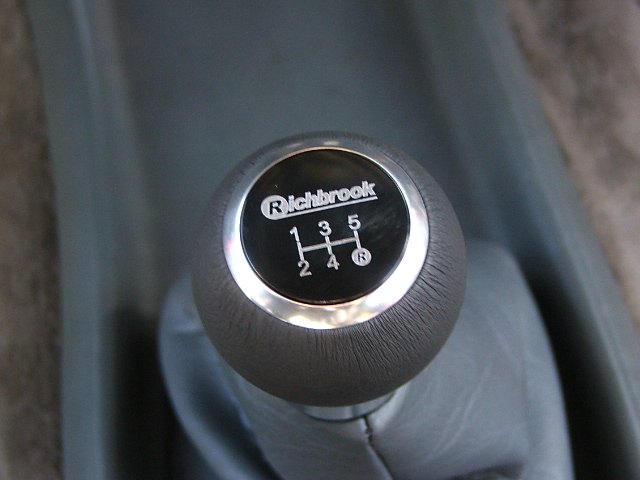

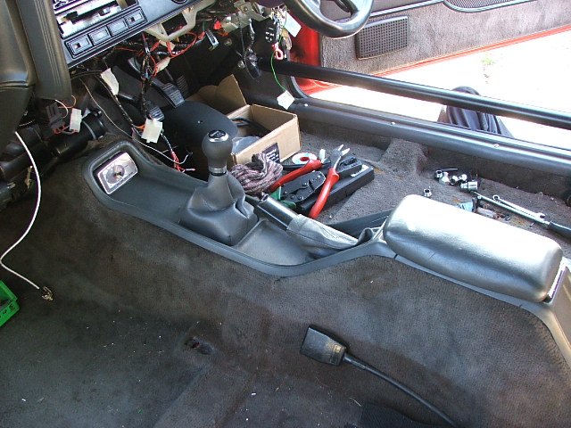

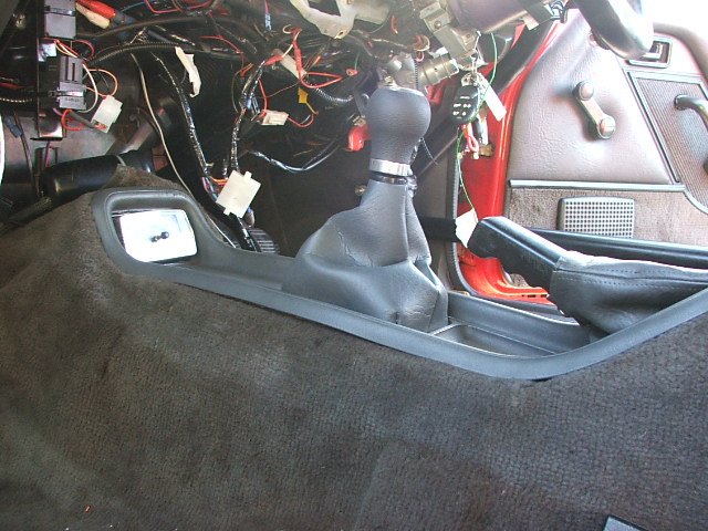

The center console has been fitted for last time along with new shortened gearstick and new Knob. (no not me)

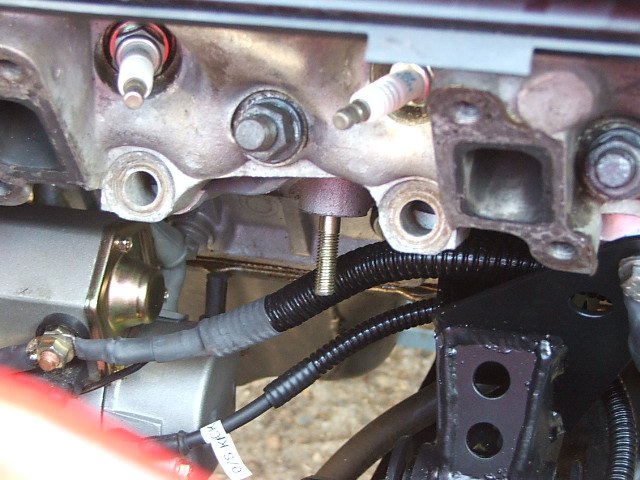

The new O/E knock sensor studs from land rover arrived and we fitted them along with the correct knock sensors this time

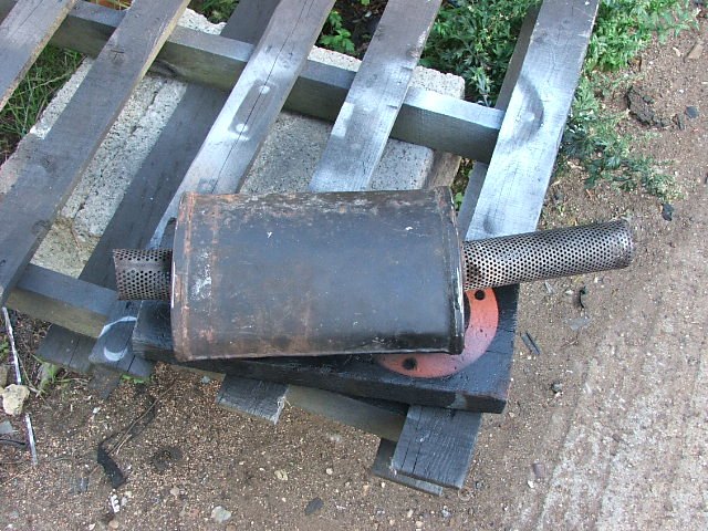

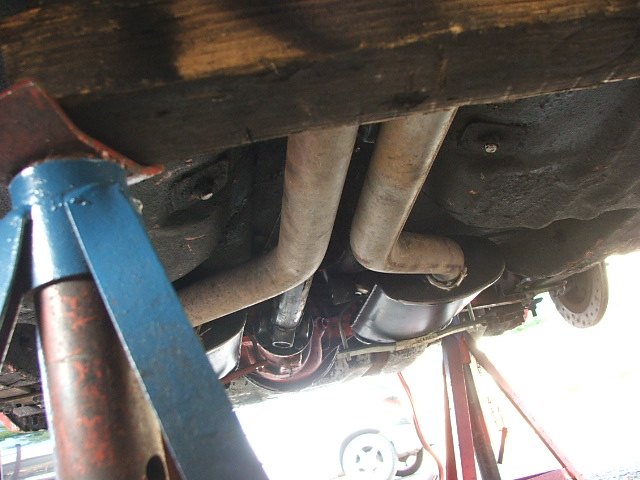

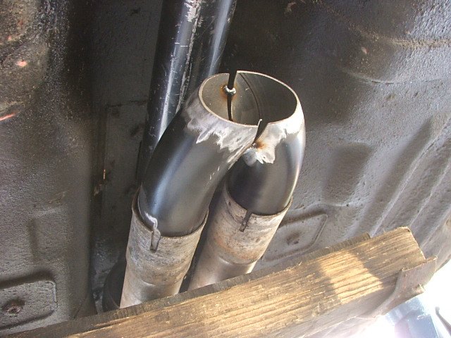

Oh and before i forget the reason i needed a new exhaust (not in the budget) would you say it fooked?
