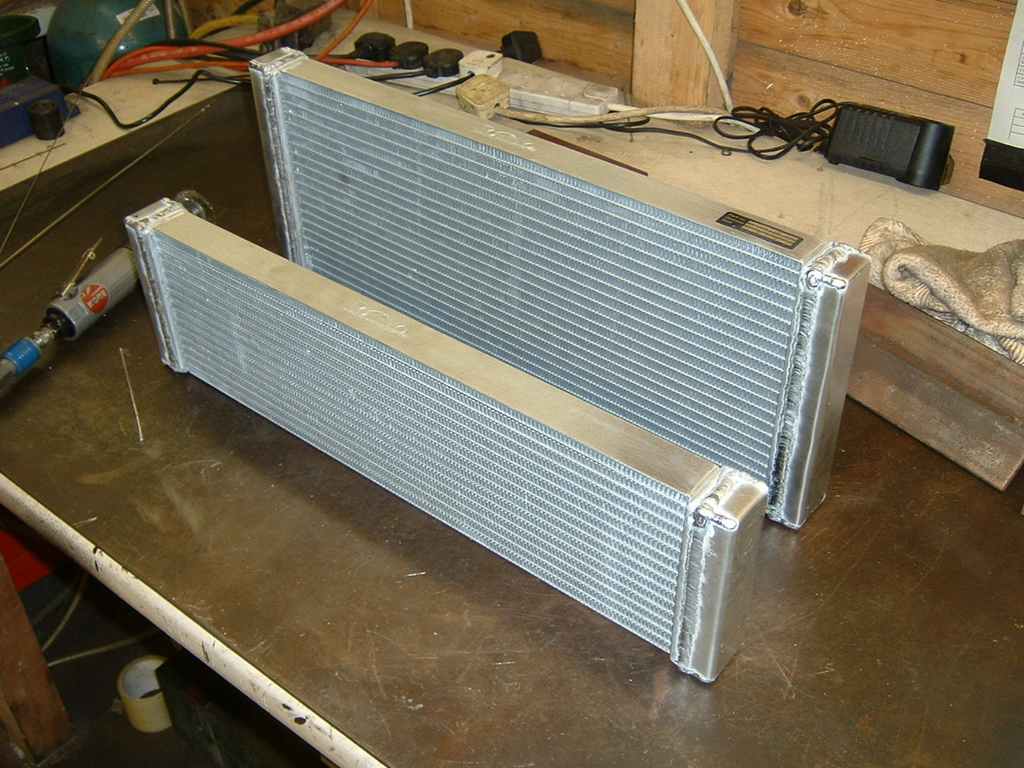

Phil, I still have my old radiators from my chargecooler if you want to have a play around with them - it might at least give you some ideas of the sort of size you need - as i dont think an oil cooler radiator is going to be suitable at-all.
(not looking a nice as that anymore though!)

they look nice. I've sent you a PM. Why did you not carry on down that route? What have you done now?
