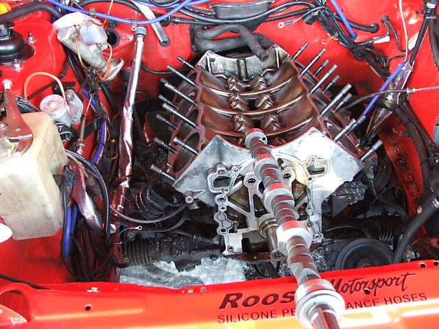

well not a very good day on car today,
got very little done which is not good,
the new cam timing wheel arrived,
decided to get a proper metal one now instead of the good ole plastic one i got.

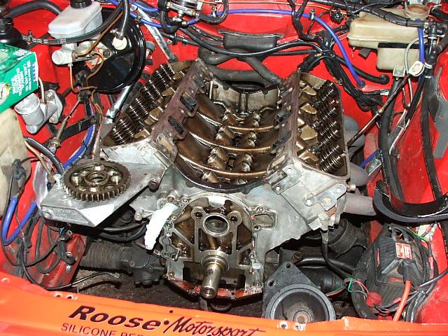

i got the timing cover off without damaging the sump gasket which is a result,
got the old cam out too and 90% of the two manifold bolts out,

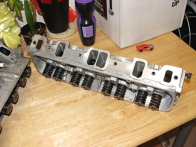

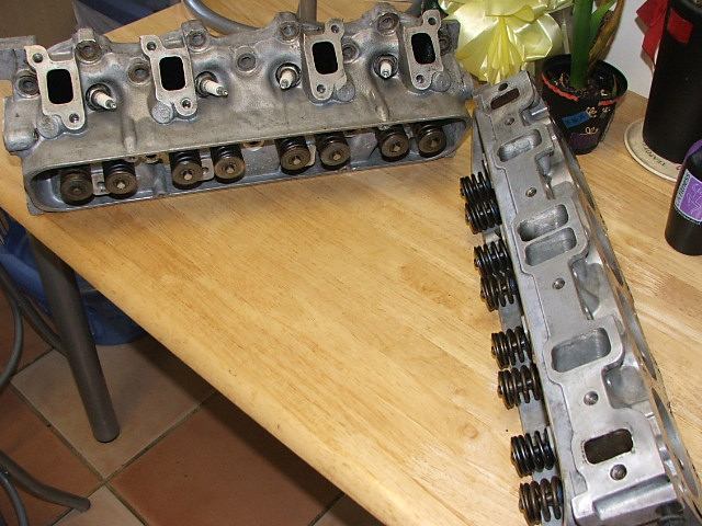

The heads are now ready to go on complete with new stem seals,

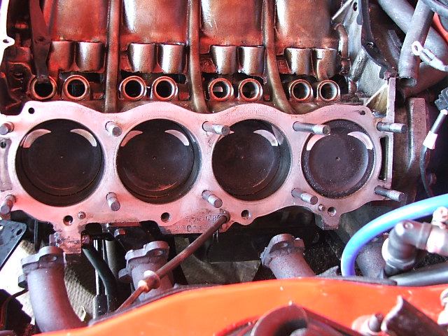

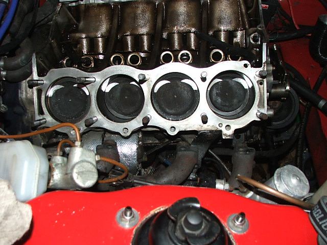

I got the reliefs cut today in the end, the exhaust one is very close to the piston edge though,
but they are now all done, that was the hard part, can now start reassembling the engine,
Stg3 head on just for a picture

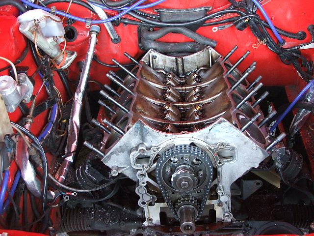

update 01-04-07
not every thing went to plan today.

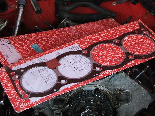

the head gaskets were the wrong ones
so had to sort that out which put every thing behind today,
BUT:

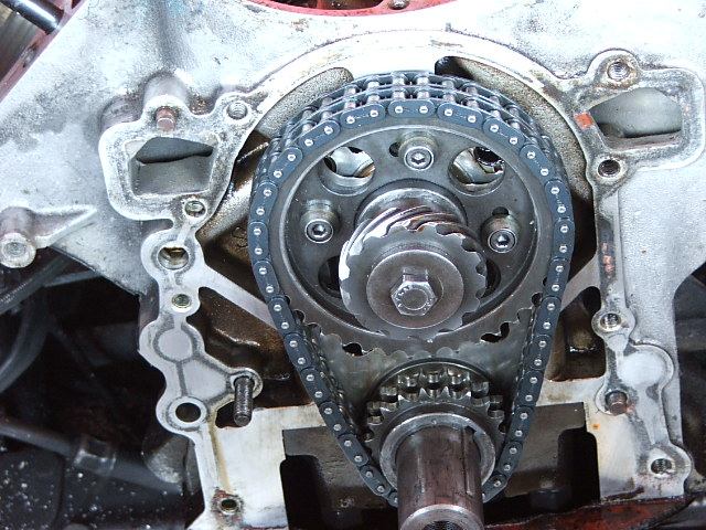

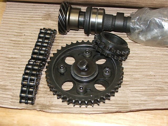

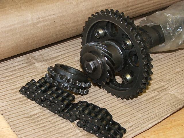

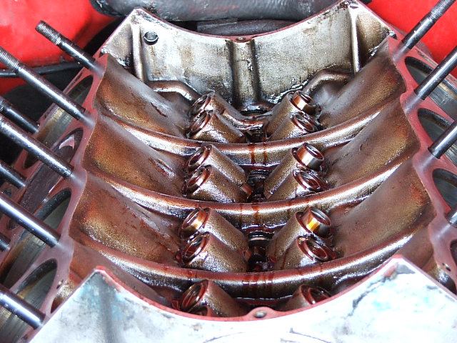

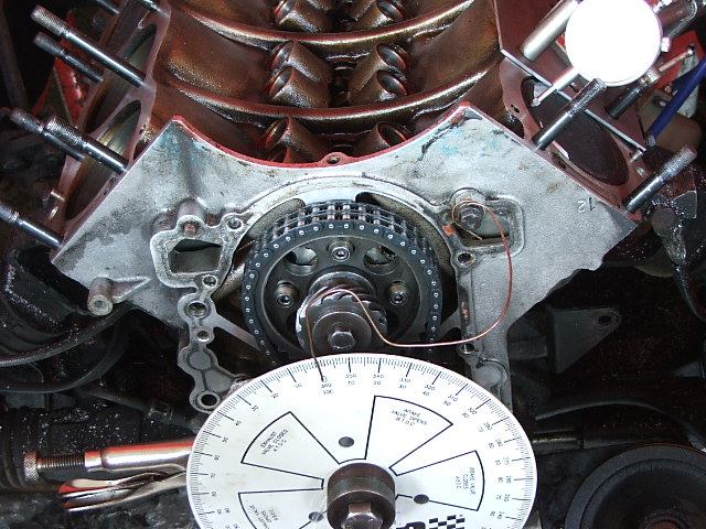

getting crower cam ready for install,
Setting number 1 pistons at TDC ready for cam dial in,
TDC
Lifters now fitted
close up of lifters along with cam lube,
close up of installed Duplex timing gears.
Correct head gaskets.

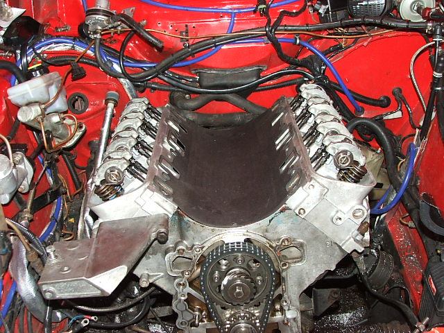

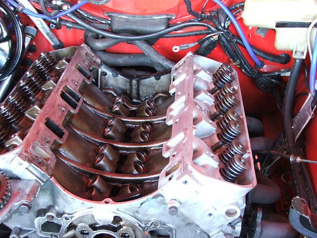

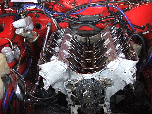

Stg3 heads now fitted along with adjustable pushrods.
Tuesday i hope to, finish the exhaust manifolds and paint, fit the new water pump and etch prime and paint the pump and timing cover, fit the rocker gear, and set preload, fit the manifolds back on,
which should leave for wednesday/Thursday fit rocker covers and injection fit servo fill with water prime oil pump and fire up and take for a test run.
TDC
Lifters now fitted

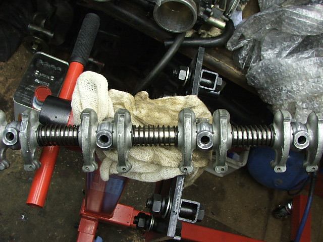

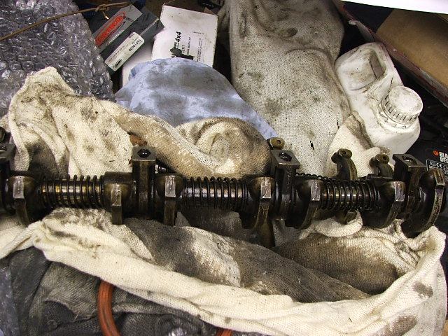

Well today got off to another slow start,
First job was to clean up the rocker gear,
the ones that came with the heads were newer but still dirty,
a bit of soaking and tlc and they look like new.
and then fitted to engine,

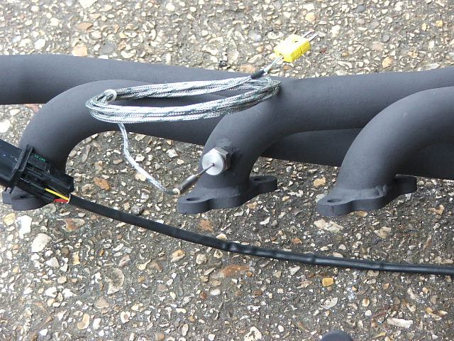

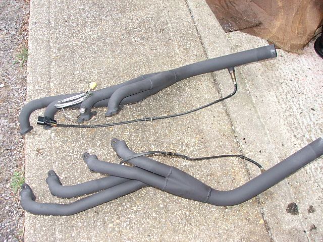

Welded the extra sensor bungs for the egt/af gauge in the drivers manifold, and wire wheeled and painted them both,

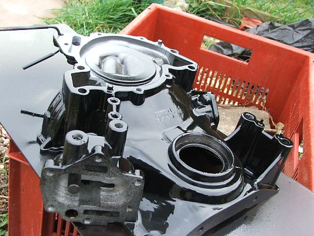

stripped the old paint from timing cover BORINGGGGGGGGG.
then degreased etch primered and then top coated
need to clean the gasket faces up now before oil pump and water pump are fitted.
