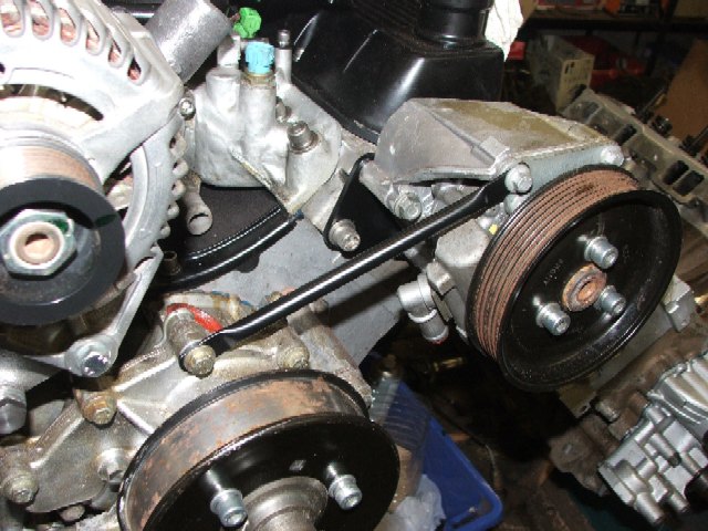

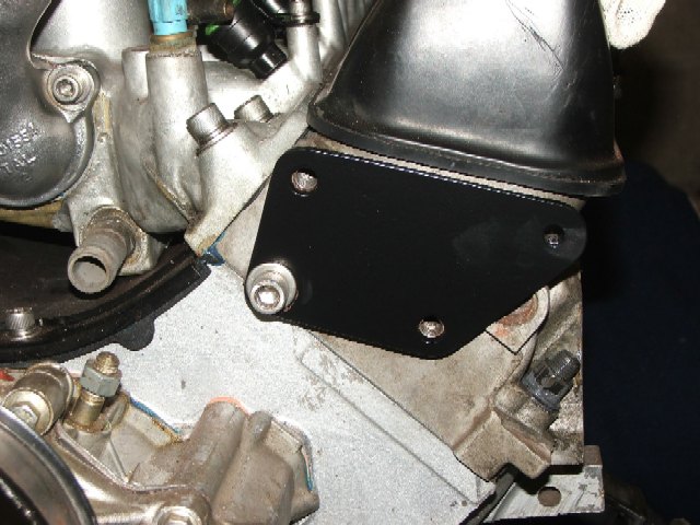

i also remembered to take a pic of the powersteering bracket caprisport made while i had it all apart for painting,
and steady brace for the pump itself,

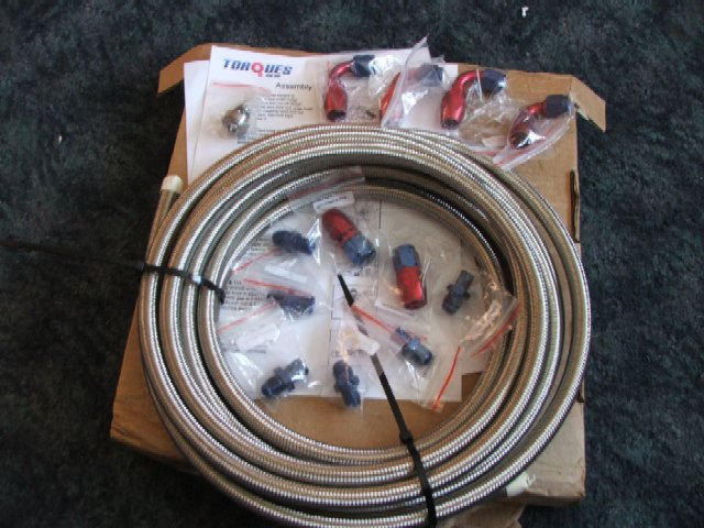

the hose and fittings are now here from Torques.co.uk.
i can see me being a busy guy again

Spent a bit on that hose I guess Tony! Seems to be so expensive I'm glad I have gone with solid ally under the car, if it is -6 stainless braid and you have any off cuts I may pester you for 400mm after you have fitted it all as that is the only -6 I need !!! Have fun putting it all on- always looks satisfying doing jobs like that
if you goto the discount section of the forum mate,
http://www.v8forum.co.uk/forum/viewforum.php?f=4
the guy i bought my stuff from is giving you guys on the forum 5% off on hose and fittings,

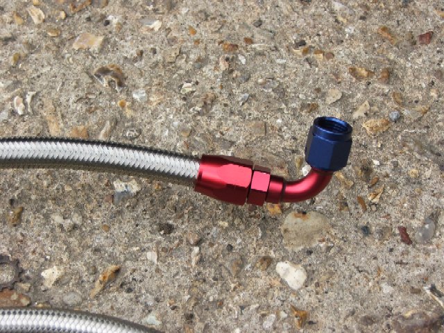

started making up the hose from the fuel pump to filter today,
and have the wounds in my fingers to proove it
does look might pretty though them anodised ends
, will get some pics next weekend,
Coops!!!
Watch out for those little sharp ends on the braid mate. They can be quite sharp. Oopps!! Too late
thanks for the warning Perry
here we go:
thats one end done
only 5 more to do
