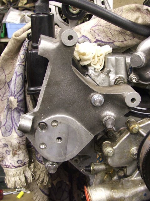

they are correct, on early heads there is a bolt hole missing on the upper outer edge (look at power steering pump bracket adaptor we made) where the nut is welded on the plate is where another bolt hole and lug on the head should be,

well had a good day today,tried 2 alternator brackets,
ERR4514 fitted a treat, (3.9 serp discovery?)
and also the bracket i got from forum member matchmetisse (no part number on the casting) which sat the alternator even lower than the above bracket for even more height clearance,

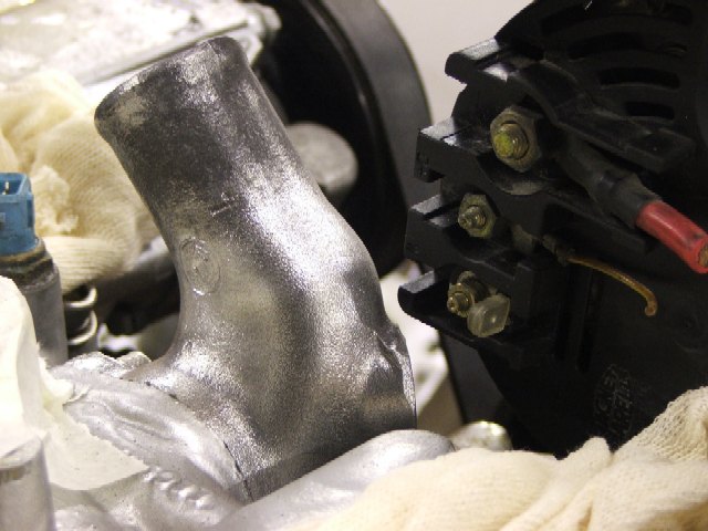

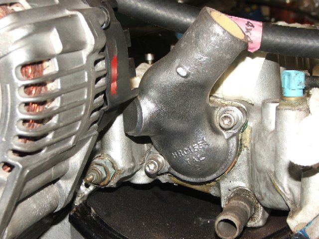

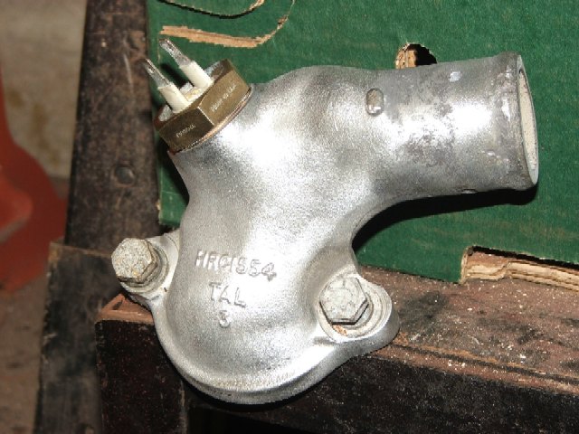

had to change the stat housing as my o/e sd1 housing fouled the alternator, But this one the sensor also fouled the alternator but the top hose outlet is in the correct place.
I need this one here: (this was borrowed from an engine for fit up reference) this has no sensor hole drilled.
This is how close it is with the sensorless housing.

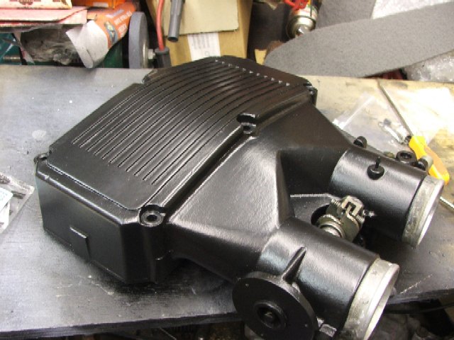

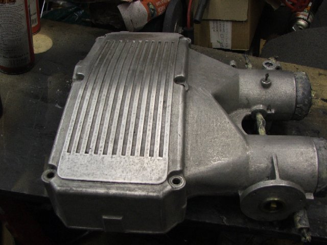

Well the plenum was looking tired and the paint was starting to come off in places,
so its been stripped back to ally,
been etch primed and awaiting top coat, (pics to follow)

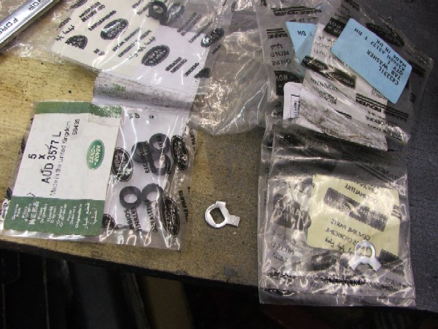

have new rubber seals and locking tabs to go on the shafts this time round also.

well the paint came out better than i thought this time round,
new seals and lock tabs were fitted this time while the plenum is off the car,

That is looking nice, is it black or gun metal grey difficult to tell from the pic.
