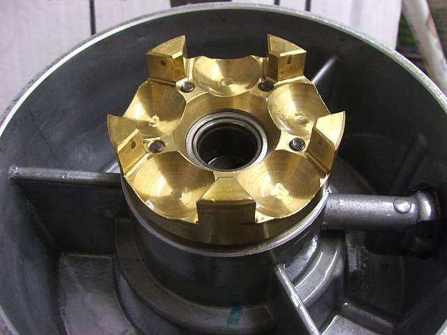

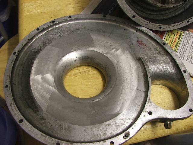

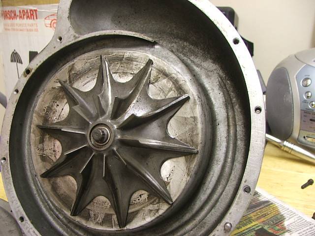

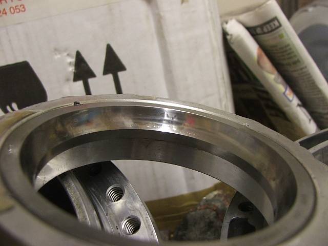

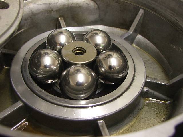

have taken the charger apart to check it over and it seems ok inside,
there does seem to be a bit damp in the snail housing, as if the seals have leaked or started weaping,
same on the front,
topcatcustom
Posts: 2965
Post by topcatcustom »
Still struggle to believe how those tiny little blades move so much air!
TC
i know same as mate,
when i took it apart i though something had fell off, :lol:
