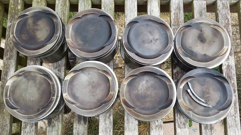

All 8 pistons (had started cleaning them at this point)
http://i3.photobucket.com/albums/y93/th ... istons.jpg

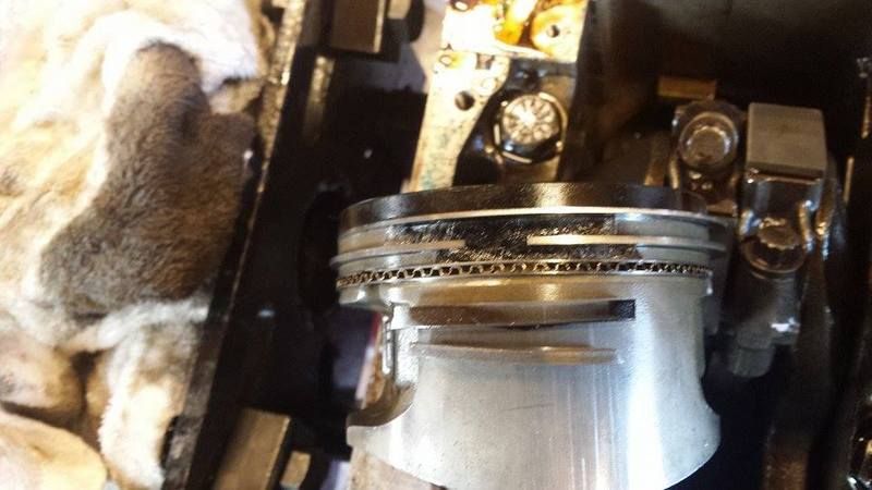

The only broken piston, Cyl 2.
http://i3.photobucket.com/albums/y93/th ... nbroke.jpg
- Posts: 4071
Not a lot of detail, but they do seem to be in good order.
Typically that sort of damage shouts detonation, but some weak pistons can break in similar fashion even without, or with even very mild detonation, if there is such a thing. The crowns and even top ring land of the damaged piston look to be in good order though. No pitting or marks that would suggest detonation
You'd almost never see a forged piston break like that, so forged pistons would make sense this time around.
Any hi res pics of the combustion chamber ?
Cheapest repair option if re-using the block, send Dave one of your pistons and ask him to have a set of forged made in same fitment and supply rings more appropriate to boost.
