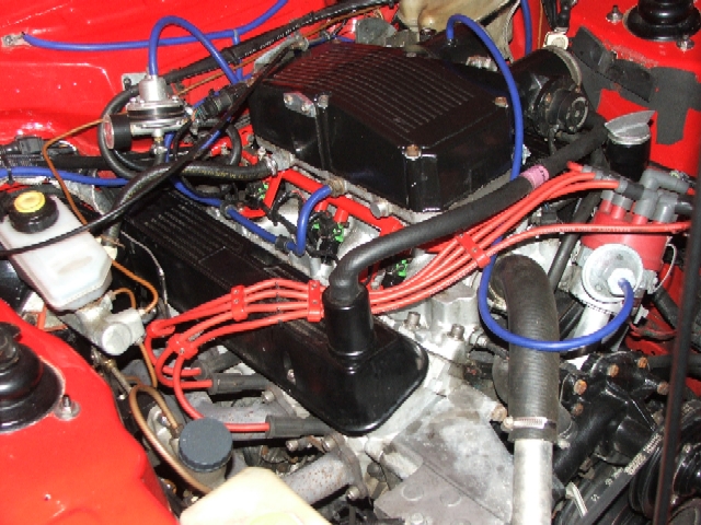

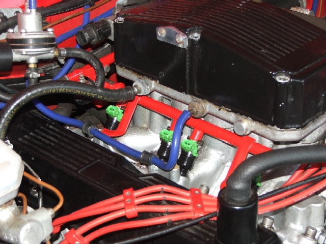

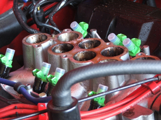

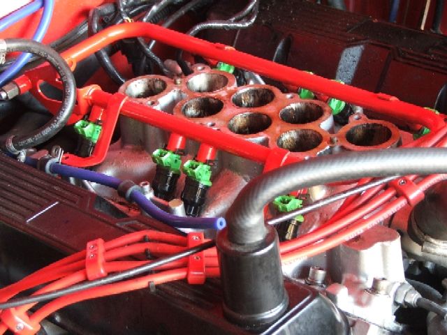

i decided to pull my finger out and start on the injector swap.
Trial fit, to check fittment.
New Bosch 440cc's 42lb/hr Motorsport Injectors and fuel rail fitted,
Trumpet base and plenum top reffitted,
A few minor things left to connect up, but it got too cold round the garage this evening (-2 on the car thermometer)
