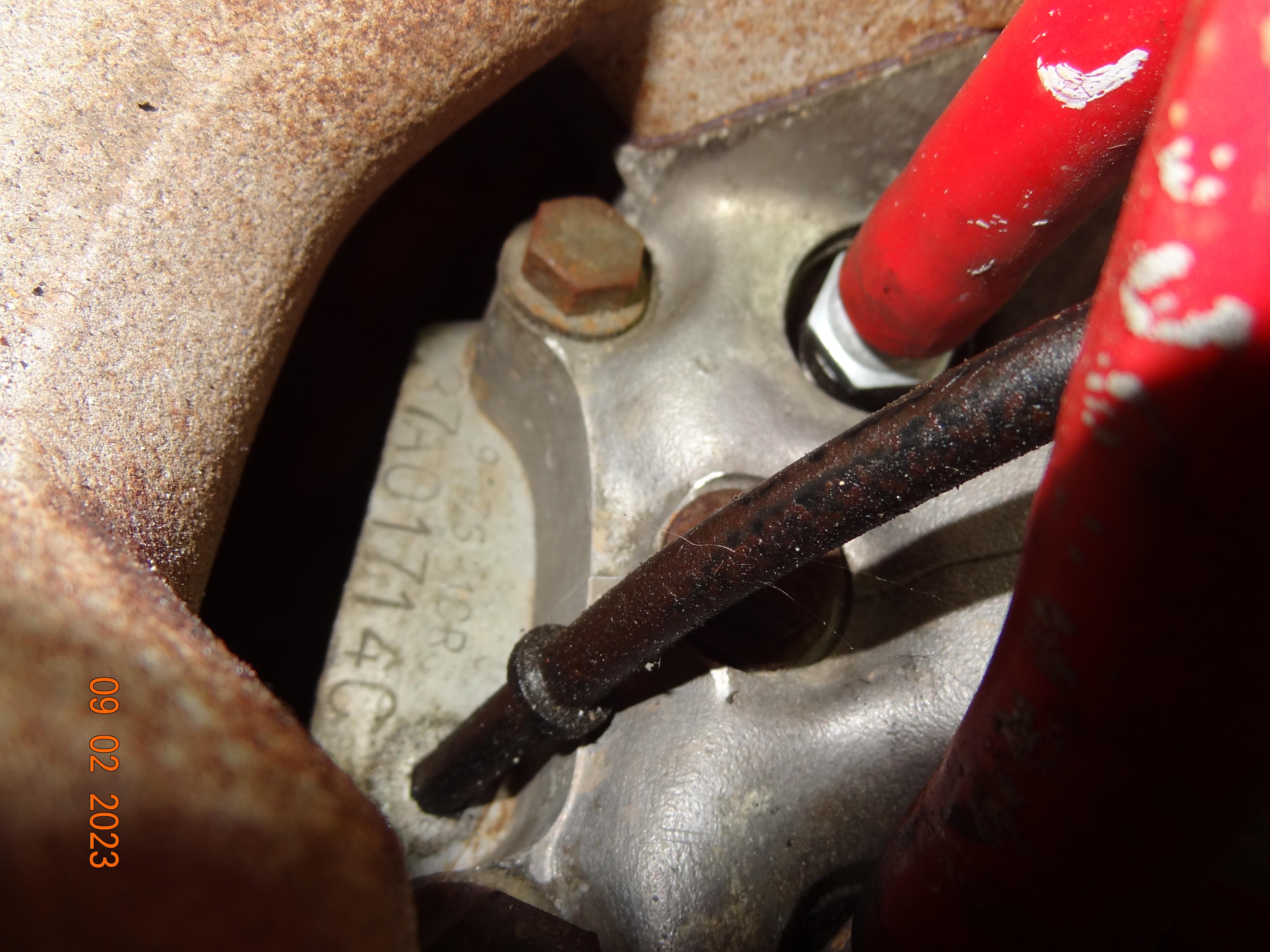

I would be grateful for help in identifying my engine.
There is a plate on the block just forward of the dipstick which reads 7A01714C. I cannot find this series anywhere.
It has Rover on the rockers and is fitted to a Scimitar SE 5A.

I would think there is another number at the start if you look closely, and that it will be either 1 or 2.
http://www.v8forum.co.uk/engineno2.htm
The compression ratio should be stamped in that area as well.

Thank you so much. This photo will blow up a bit.
I think it may be a 3 and the CR may be 9.75:1
If that it right it my be a TVR crate engine.
What do you think?
What do you think?
Re: Rover V8 Engine Numbers Updated:
Yeah, I'd go along with the TVR theory. I guess 37A is the crate engine as sold to a few small car builders.
37A with a 9.75:1 will be a TVR 350i engine
