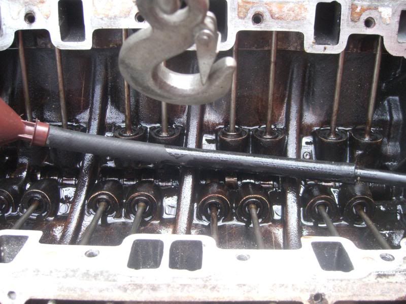

If one is soft, that's your noise.plastic orange wrote:I've not tried them for being soft, but they are almost new - 500 miles old.
Pete
If they are all tight ( ie loaded up ), it's unlikely they are making any noise. But it does sound like a lifter.

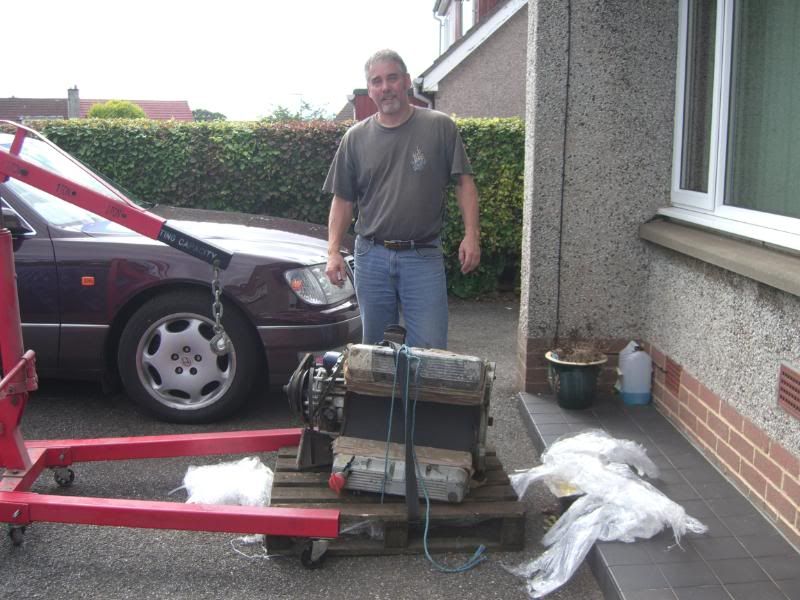

New engine arrived today. Externally it looks pretty clean, and valley and head area not too bad -(not as clean as my noisy engine though).
The seller also supplied a set of clevite mains and big ends, so do I just go for it and do a complete rebuild using my old heads, hurricane cam etc, or is that a step too far?
Pete

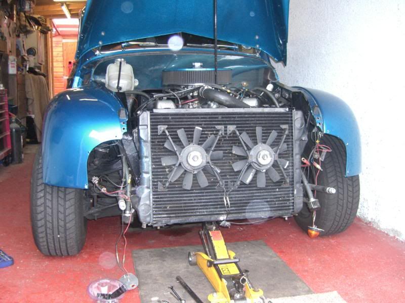

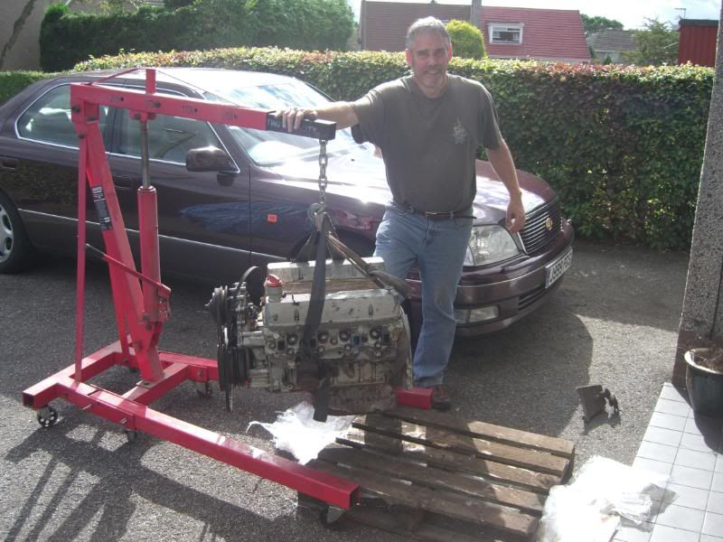

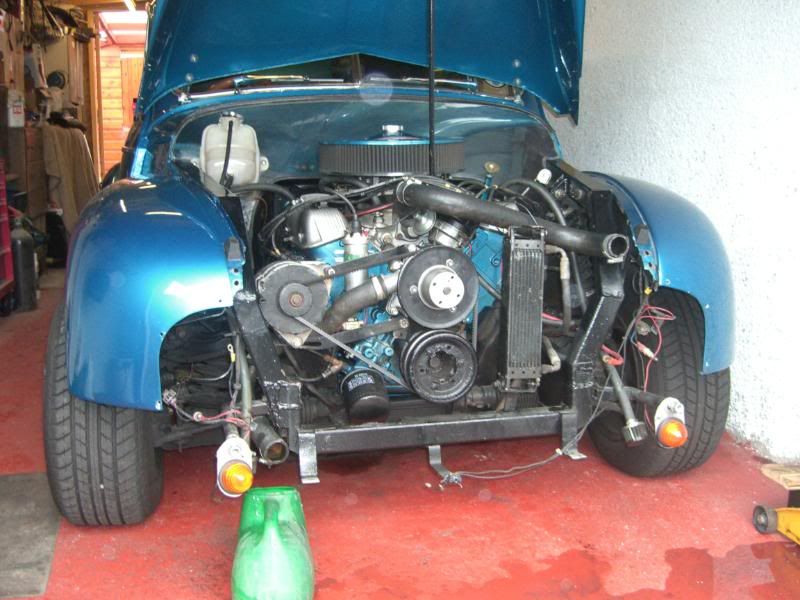

I've almost got the old engine out now, and checked the new one for oil pressure (with drill) to see what like. I primed it through the oil pressure gauge inlet, and after about 5 seconds of 'drilling' at low speed I got oil pressure.
About 100 revs of drill gives 20 psi. Took it up to about 800 and got 40 psi. Drill started to get hot, so made sure oil was getting around engine ok.
I'm going to try my old front cover (Sd1) on new engine and do the same test and if poor pressure, then front cover is the guilty party for my troubles.
I primed the new engine with a drill to check oil pressure - was fine
Pete
