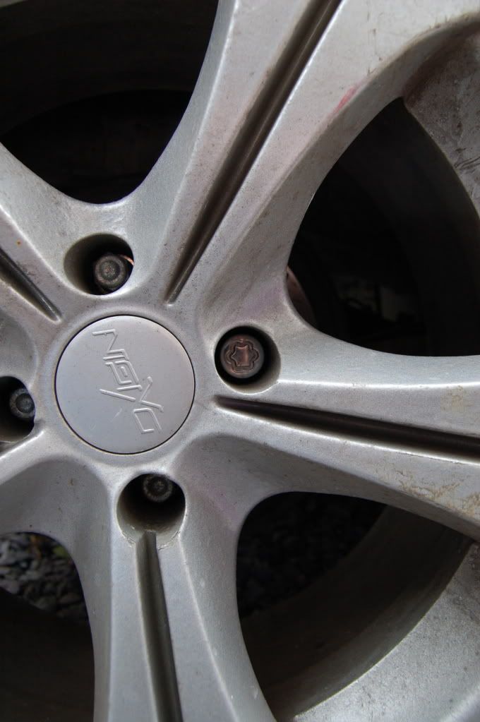

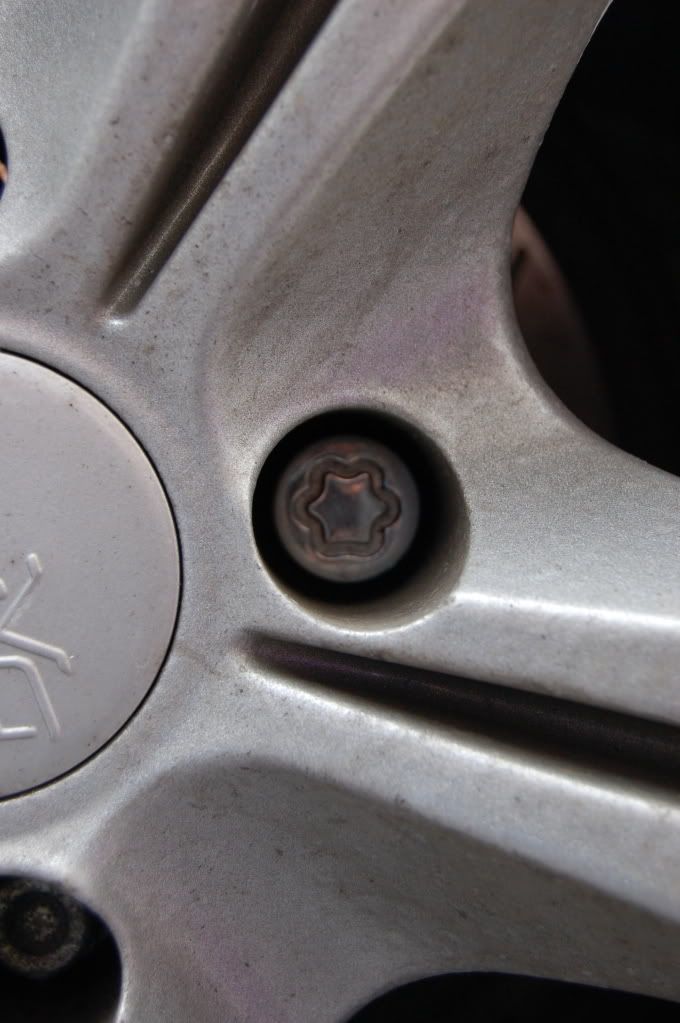

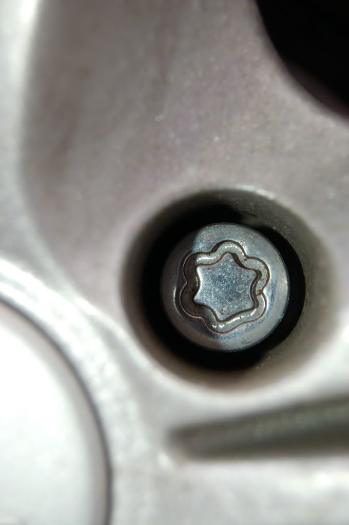

Managed to get a few shots today;

If you've got a socket the right size use an angle grinder & profile the outside of it for clearance. Should work a treat.

Those locks are very similar to the McGuard ones and I think that you will be very lucky to get them off in one piece TBH.
There is so little room in the tunnel to get anything of substance on to the top of the lock without damaging the wheel itself.
Are the bodies of the locks just cylindrical?
Hammering a socket over the top will not do much at all imo.
Unless you can find the key I think that there are few options but destructive methods.
P

What I meant was the 6 pointed star in the middle of the nut looks to be about an 1/8" of an inch high. So if you measure across the flats (4 points) then find a socket the same size you can profile the out side of the socket so that it will fit in the recess. Before trying to loosen it off find a piece of aluminium & using it as a drift give the head of the nut a good smack with a hammer to help loosen it.
