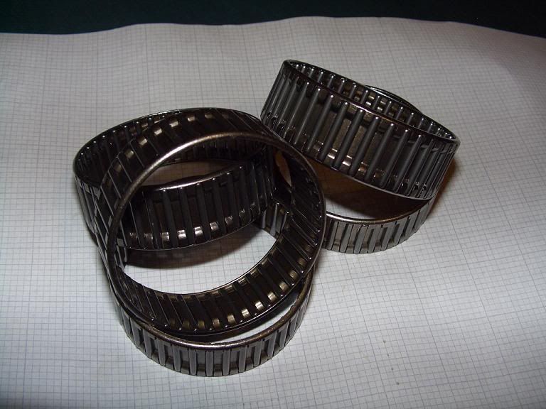

Hi Hairbear TE
do you know anything about expected service life of roller bearinged cams?
I have only heard of this set up on race engines, however that includes NASCAR use, so I assume they are good for 500 miles at 80 to 100% full throttle so they must have some life (and a guy last year was selling an endurance race chevy engine on racecars-direct with one in).
If you have any info I would be very interested in it.

Hi Kiwi, no I dont have any idea how many miles you could expect to get on the street out of a roller cam bearing set-up. As you know moving engine parts are supposed to ride on a thin film of oil and not in fact touch the bearings during operation but in reality this is impossible 100% of the time and inevitably there are loads placed on the bearings or they would never be any wear and tear. Stresses on the cam can be minimised by using the crank driven oil pump set-up (or an external system) and ensuring that the chain tension is correct but the force of the valve springs alone in this kind of engine (you'd hardly be running a soft cam) would be considerable. The thing is, because this is really in the realms of the serious racing engine, and serious racing engines get rebuilt on a regular basis, I doubt that there is much data available re the longevity of such a system on the street! I am told that some of the engines that used to race in the rover V8 challenge drag racing series used roller cam bearings so if you can track down any of the competitors they might be able to advise. John Eales and Ian at Wildcat will both have built rovers with roller bearings at some stage and would be the ones to talk to. Real Steel built the engine for Kev Jenkins rover drag car a few years back and that probably had roller bearings so they might be able to advise. The bearings themselves are available from a company called Tyco I believe. Keep us posted if you have a go at building such an engine.

Thanks Hairbear
I shall ask around further, I am building a chevy rather than a Rover so will ask what contacts I have about this combination, I am going to be running a 5 port dry sump set up with a belt drive to the cam, mech roller set up (comp 287TKR-6 but on 112 LSA) and want to run the top end as dry as possable, with oil stand offs in the valley and a roller rocker set up so the roller beearing cam bearings would be a good idea on this front (and I generally like the idea of reducing friction and therefor heat!).

I've got a set here that were intended for a SBC that has had its block modified to accomodate. The outside diameter is 60mm and the inside is 55mm (a popular oversize for cam journals on racing chevys). There just isn't enough meat in a standard rover block for me to feel comfortable about using them. Another style of roller bearings is available that are encased on the outer of the bearings but the external diameter is larger still for any given inside diameter.
Thanks Hairbear much apreciated
Those are small bearings! 2.5mm. I will have another look at the comp cams website and see what size roller bearing cam's they do and talk to the people Ill get to prep my block and see what they think. I am building this for a car I don't expect to do more than 3K miles a year in so if it works out as a strip and replace every couple of years it may be practical, not sure In need to know more.
