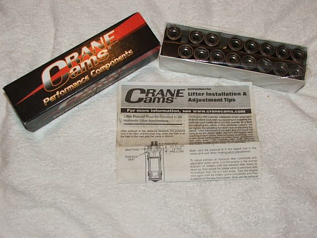

It's Arrived :-)
Got home from work today,
and came face to face with a parcel from Paul at v8 tuner,
was well impressed as only phoned him monday afternoon,
in the box was a crower 50233 camshaft, and a set of crane hi-rev anti pump up lifters :twisted:
