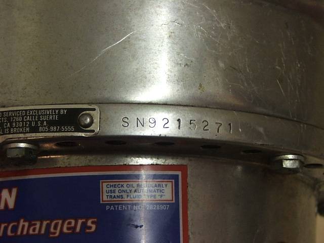

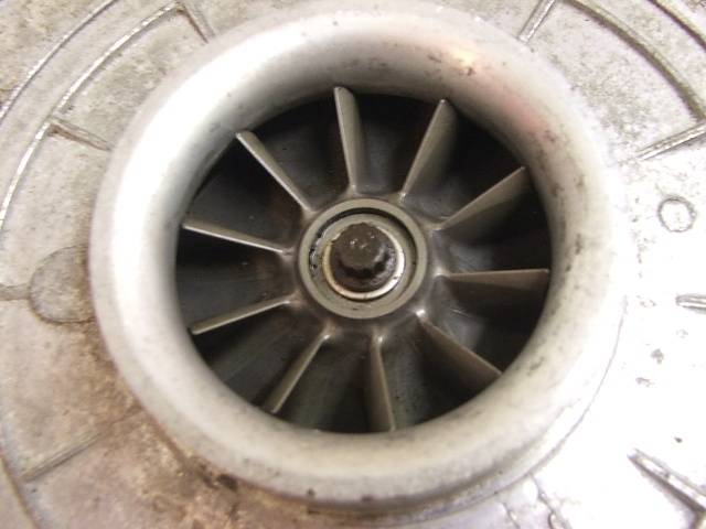

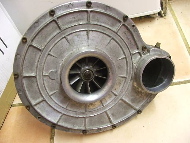

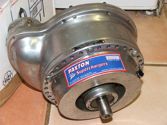

well i popped out this evening, came back about an hour later and the wife said,
you have had a parcel delivered,
told her not expecting anything till mid week.
open the box and inside was:
so yup i defo now have the paxton charger
