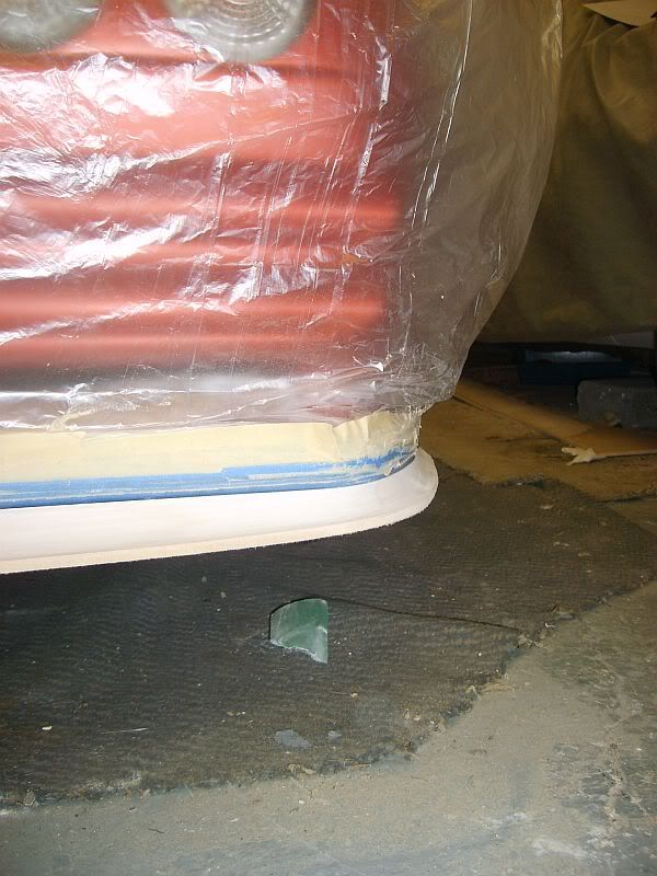

Good evening Gentlemen,

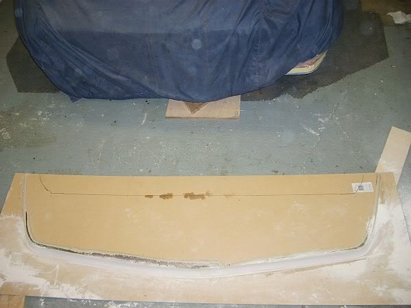

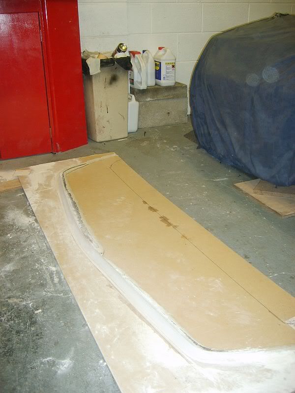

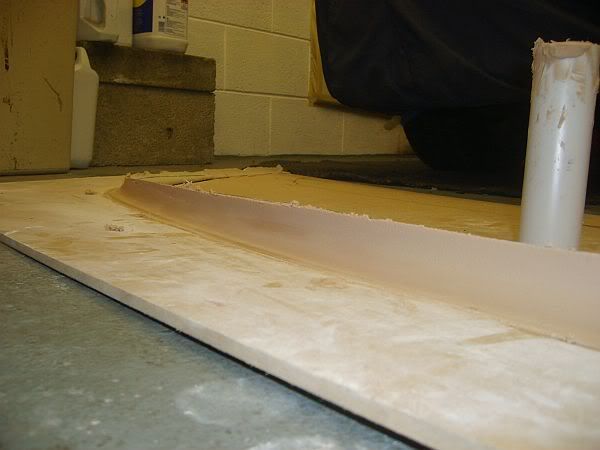

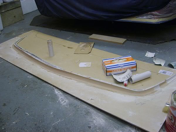

Have been working away out there tonight and things are looking okay so far.
I did want to show a pic of how the template was released but bugger me backwards,three taps with a soft faced sledgehammer
and the thing fell off, literally.
As it fell it did leave three small sections behind but these came off easily as well and were bonded back into place with a smear of plop.
I have spent some time with the sanding paper wrapped around the waste tube and have got a really nice profile already and as I have sanded the paper has just about self calculated were the edge of the splitter should be.
How cool is that.(More luck than judgement though)
Now all I have to do is to make the whole thing smooth and cut to shape and then I can start prepping for the mould.
Anyway enough rambling here are the pics....
This frontal area needs a little bit of tidying to make it square.

Hi All

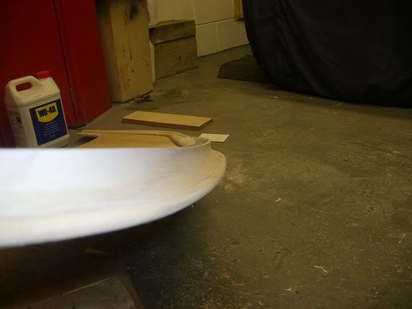

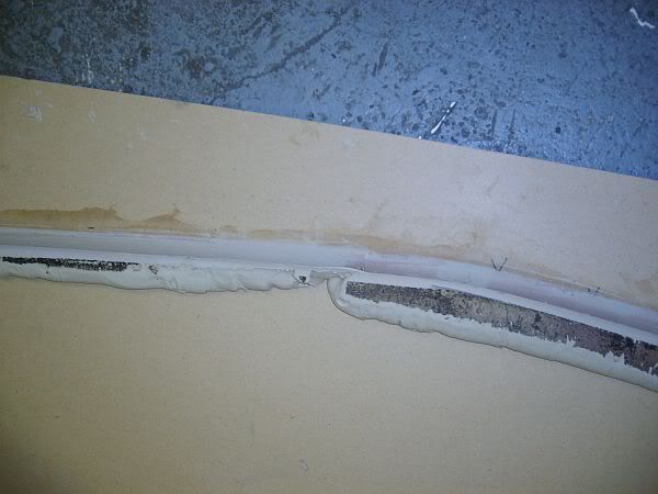

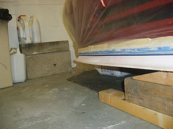

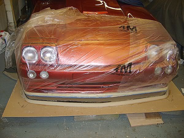

Had another good evenings work out there tonight.got the front final skim on and flated back on 120 grit paper and have done some on the sides too.
By the end of the evening tomorrow it should all be flatted down and finished on 400 grit.Thats the plan anyway.
Heres a few pics...
It is starting to take shape as you can see and once all of the sanding is done I can then cut the final shape and then the fun stuff can start,just hope the neighbours love the smell of (napalm)resin in the morning!

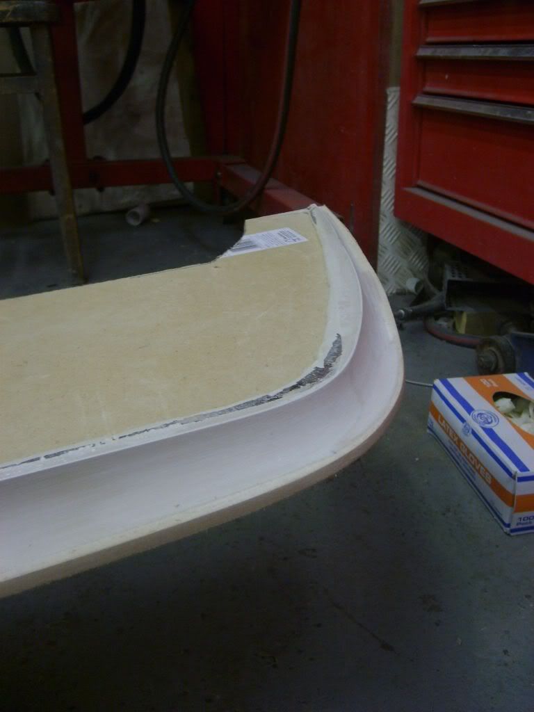

Hello My Little Darlings

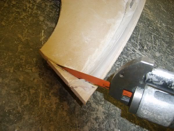

Had a great session out in the workshop tonight.
Decided to profile and then cut the splitter out rather than do the finishing on 400.
As it is so much more managable I can move the thing round and check that everything is square on the front edge.
The curvature I'm very pleased with because once it is all black you just ain't gonna see it without looking and thats what I'm after.
I havent finished the back edges as yet because I will fit the unit back up for a final check before the mould prep starts.
May not post tomorrow night as I have a monster day at work and will probably be Donald Ducked.

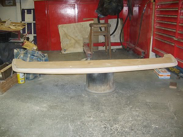

Hi All

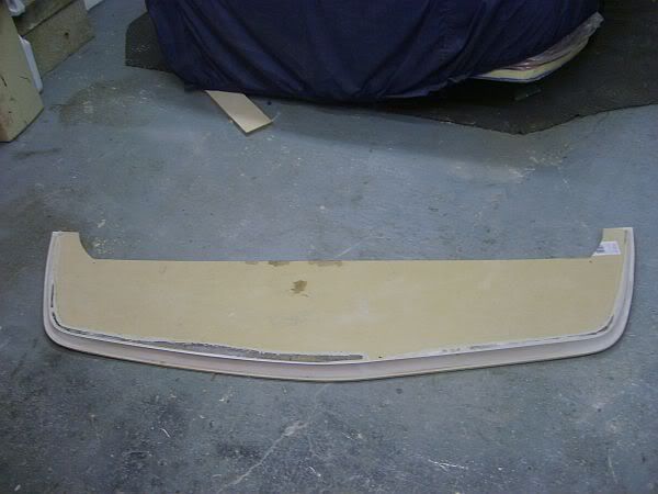

Work prgressed well again tonight.
I have offered the splitter back up,profiled the leading edge and made sure that the edge is as parallel as I can make it to the curved face that sits up under the spoiler.It has also been cut to shape at the trailing edges too
I may get another chance to work on it tomorrow night but a huge emergency job has come in today and we have very little time to get it sorted.
I have to completely rebuild the back end of a Princess 54ft motor yacht by the end of play next Tuesday (gulp) so it's one of those whatever it takes jobs plus get the other jobs that need to be sorted by the weekend complete aswell.
Once we have these jobs sorted I will continue with this project so will catch up with you all then.
Here's tonights pics....
