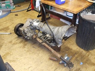

crayefish wrote: only £150 quid?? dont suppose they do a 4wd version to take a transfer box?
Adapter is straightforward. I made one for a 4L80e which is the 4 speed electronic version of the TH400 - Shares identical output shaft and bolt housing.
Full write up: http://www.mez.co.uk/4l80e-1.html
or this fella sells the TH400 to LT230 adapter:
http://cgi.ebay.co.uk/LAND-RANGE-ROVER- ... 911.c0.m14

^ That is so sick. One day I'm going to explore that possibility before I'm 30, lol.
