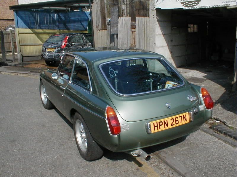

Nice car but someones nicked your bumpers!
