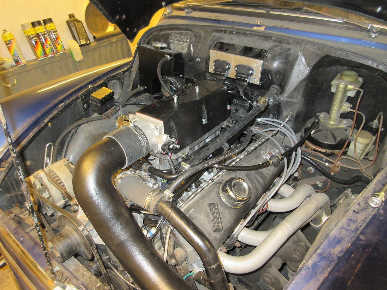

Those with keen eyes will possibly note that this is not an MGB but even other makes have same issues. My rad is underneath the water pump pulley, I ran into space issues when I did this conversion 25 years ago.

A question about your top hose: is the hose higher than your rad cap ? It´s hard to see in the photo. Mine did and it never bled the air in the top hose and consequently tended to run hot. A simple hose lead to the expansion tank cured that. The attached pic is a later version with the EFi manifold, with carb the top hose ran even more upwards. With this setup I thought that the bleed hose was no longer necessary. First test drive proved me wrong

Yes, it's slightly higher as the rad cap would have originally fouled the distributor cap. Of course now I've converted to MS, the distributor cap is no longer required so I will move it to its highest point.
I would have preferred to have the expansion tank higher but it's at it maximum height now.
Many thanks for the observation.

The way you have your cooling system setup means the height of your overflow/catch tank isn't important - could be anywhere in the engine bay. The Important part for your system is your radiator cap in the top hose which feeds the bottom of this overflow tank. This needs to be the highest point in the main pressurised part of your cooling system so any air in the system will collect there and get released into the overflow tank.madmal007 wrote: ↑Fri Jun 18, 2021 7:40 am Yes, it's slightly higher as the rad cap would have originally fouled the distributor cap. Of course now I've converted to MS, the distributor cap is no longer required so I will move it to its highest point.
Mal
If you had an expansion/header tank system then yes it is very important this is the highest point in the cooling system.
You mentioned previously that you are using the standard MGB rad cap - but I don't think this is the correct one for the way you have the system plumbed. The rad cap in your top hose needs to be one with a double (rubber) seal in it, the standard MGB rad caps look like they have a single rubber seal designed for an expansion/header tank type system - NOT and overflow/catch tank system.
https://www.moss-europe.co.uk/cap-radia ... soc=108626
Additionally regarding the pipe you have looped back from the manifold into the coolant pump inlet pipe - this can be blocked off. With this plumbed in you have 2x thermostat bypasses (3 if you have the heater circuit open) which are coolant loops which miss the radiator. You only need 1 bypass circuit so that when the thermostat is closed you still have a small coolant flow.
Also have you checked your fan belt is tight?

That's interesting, thanks. I'll get a new rad cap. Its the small format rad cap and its proving difficult to identify from parts drawings as they don't always specify size. I sourced the last one by taking it to a car parts supplier and getting them to find one.
I'll also look at blanking off the small pipe.
The fan belt is tight so I'm sure that's not the problem.
