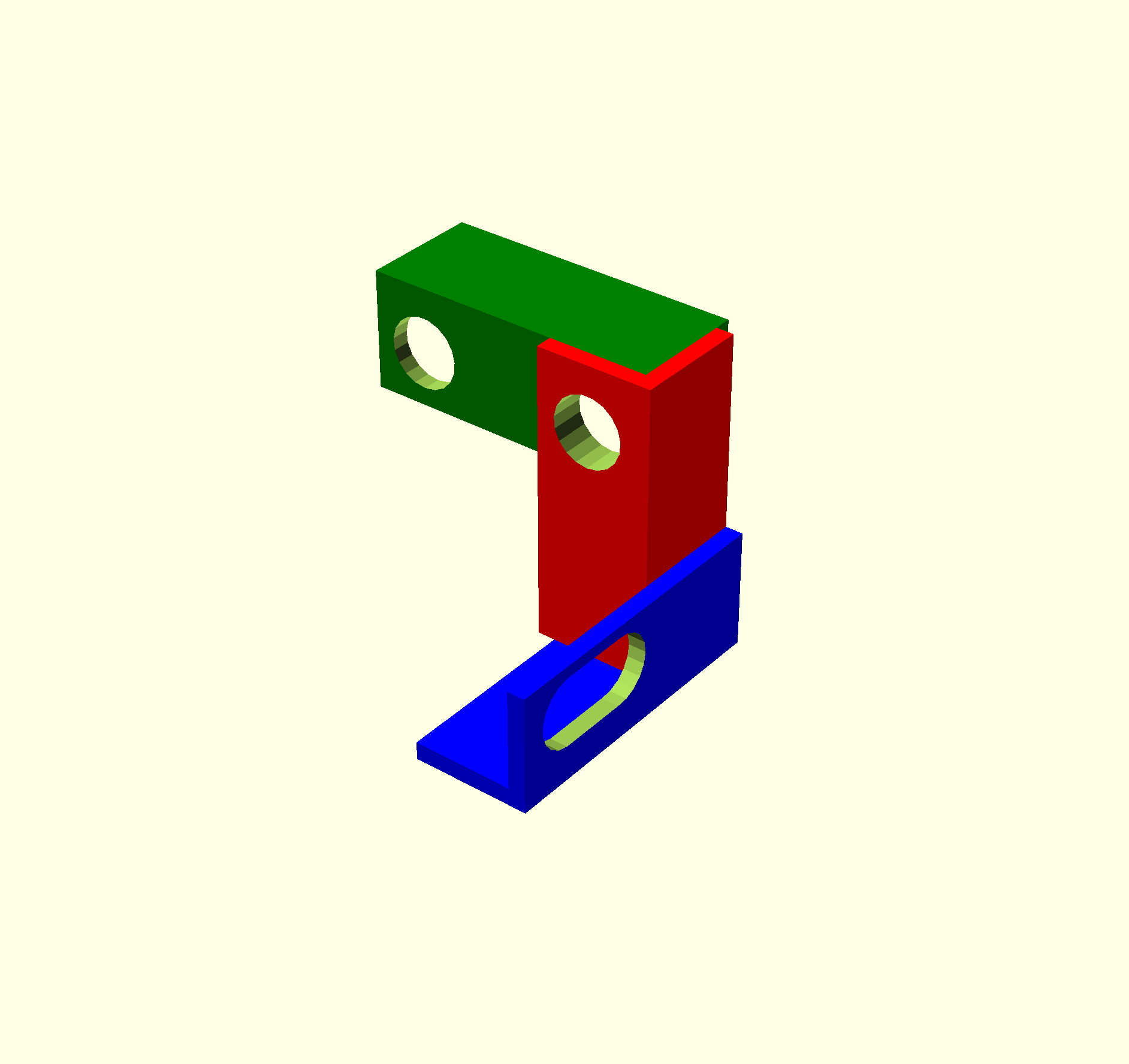

My next battle is my crank sensor mount. I've gone from a VR sensor to a hall-effect one. I bodged it into the mount I had previously made, but it was offset towards the rad by about 6mm and didn't really line up well. The engine runs, but I have a lot of dropouts to 0 rpm so I'm making a better one from scratch with more adjustability.

You need to get a better cat. Endless supply of scratch if you need it. My cat is actually quite timid and gentle so I thought I'd better use steel instead. This is a mock up of what I'm planning to hang off the oil pump. Dimensions are all made up, I was just getting fed up of playing 3D Tetris in my head trying to figure it out. Flap disc in my grinder should make the welds look better when I make it.
