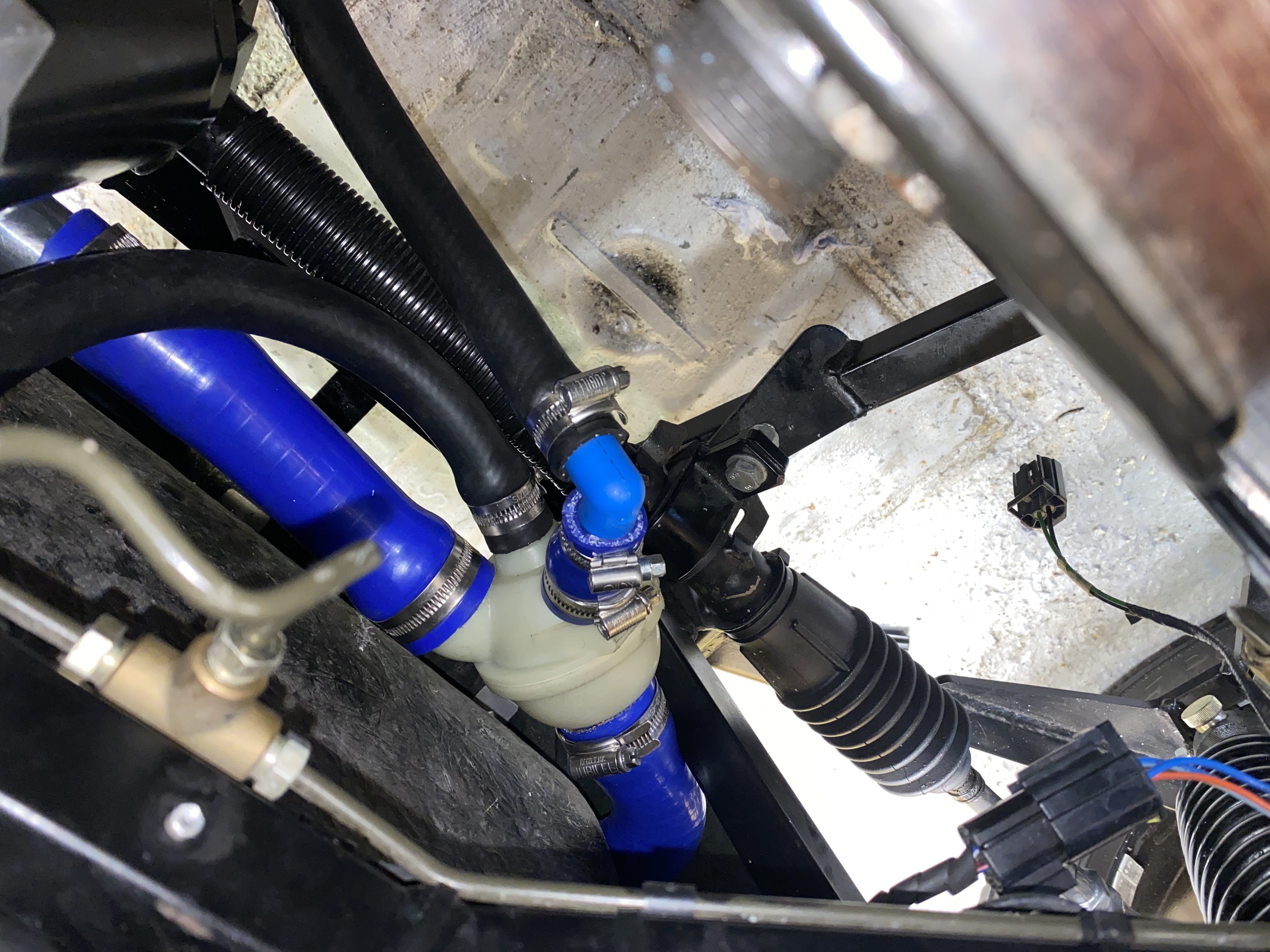

I received the thermostat today....it is indeed 82degrees...i wonder if they started doing some after market ones as my Haynes manual also suggest they run at 95...
And here it is installed...definitely an artificial heart!.
Building a westfield V8

Re: Cooling issues.
Another benefit of the remote thermostat housings is they close off the bypass circuit as the stat opens so you get 100% flow through the rad - doesn't look like that billet one does that?
