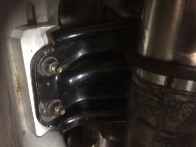

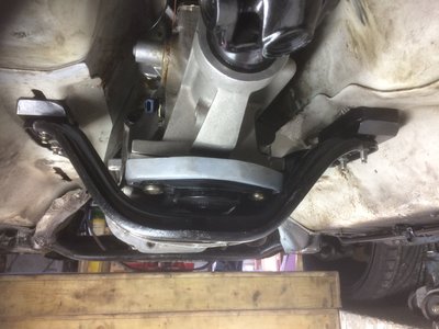

Yesterday I sorted out the gearbox support. I used a sierra
4x4 steel mount and spaced it down from the standard floor floor slots with aluminium blocks. I made new inserts with longer bolts to slot into the rearmost factory floor slots. As the gearbox mounting surface is at an angle I bolted a tapered ali block to it to get things level and inserted a standard 4x4 mount rubber into that. The plan is to probably get a poly mount which will be more compact and neater. The 4x4 cradle needed a bit of grinding out in places and local restrengthening to clear the gearbox casing but only because I needed it to be as far forward as possible to minimise re-positioning work on the exhaust. In hind sight shifting the exhaust boxes rearwards would have been easier.

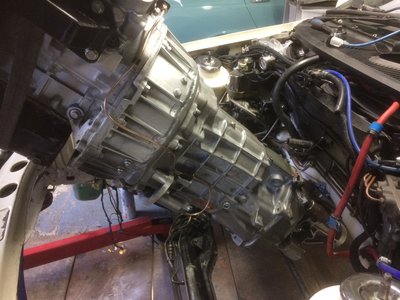

Engine and T56 now going back in and a few hours left now to get everything back on it. Roll on Monday. We previously modified the clutch to hydraulic operation so a slave cylinder has been grafted onto the gearbox to push the clutch arm forwards.

Job done. Engine and t56 in place and working fine. The shortened prop seems ok but we will get it balanced just to be sure.
