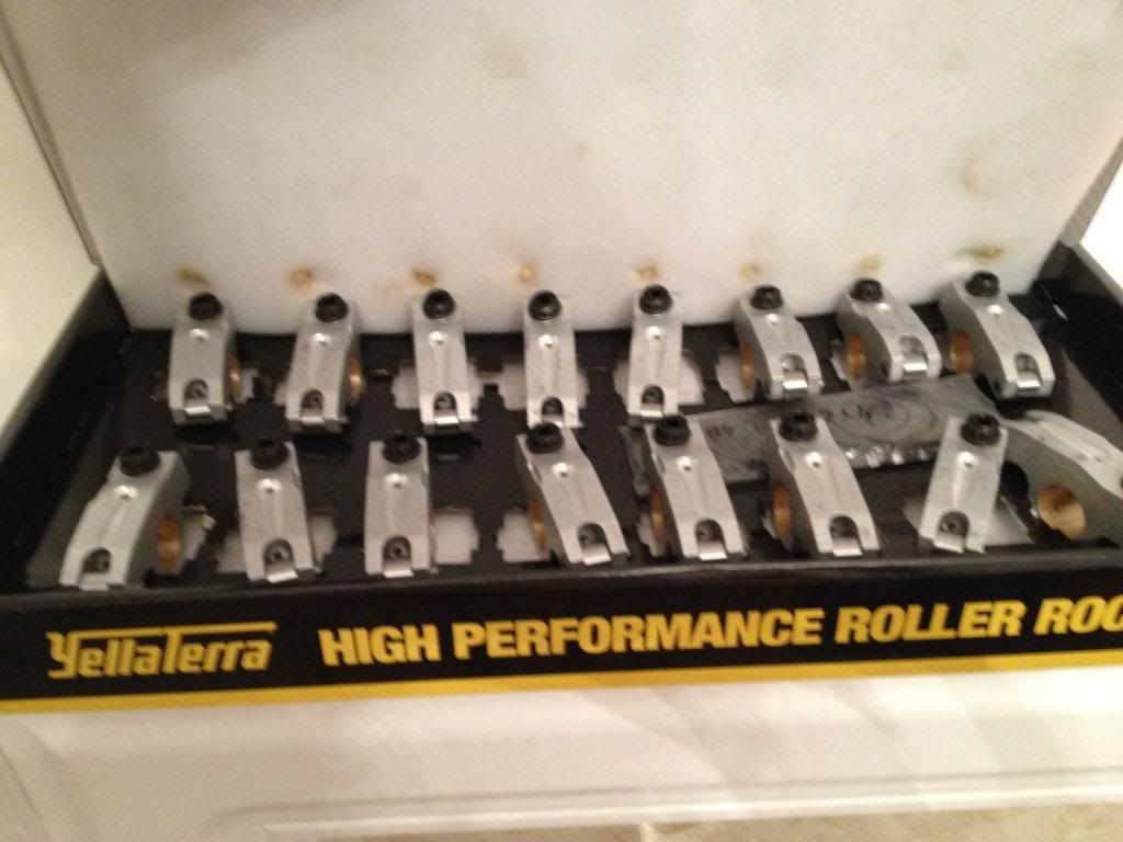

DaviesDJ wrote:Started re-assembling. Roller rockers arrived today! My god they are to gorgeous to use! The yella terras certainly look the part! Will post a pick. Wonder what BHP all this nonsense will land me?? And what ET at the 1/4 mile???
Ideally Dyno first to set it up and then the drag strip :)

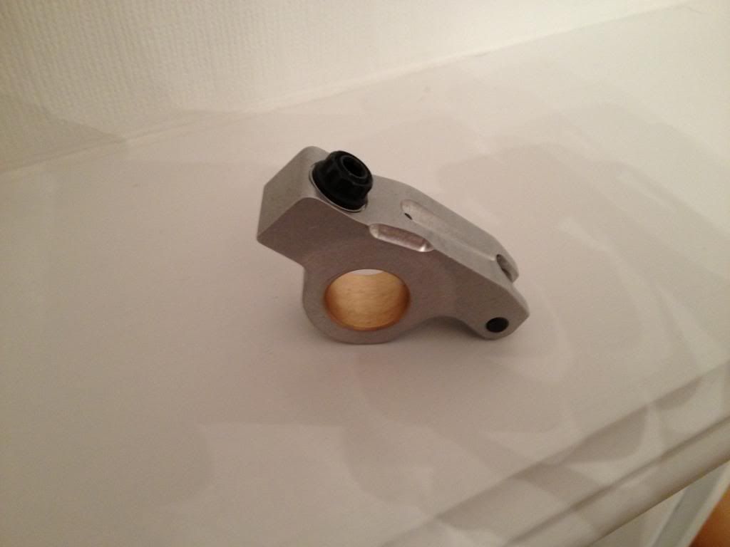

Apparently (not test fitted yet) the roller rockers will require lifting the rocker cover slightly, thinking about using 2 gaskets but an adaptor plate would be better! Does anybody know where these can be easily squired, don't have enough time to make one. Does anybody have experience of these??
