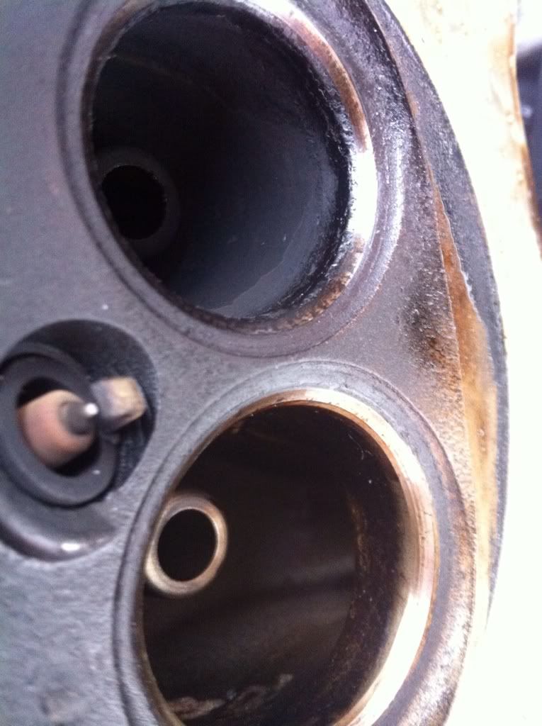

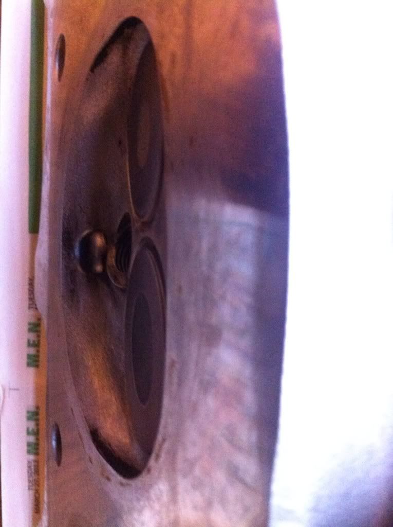

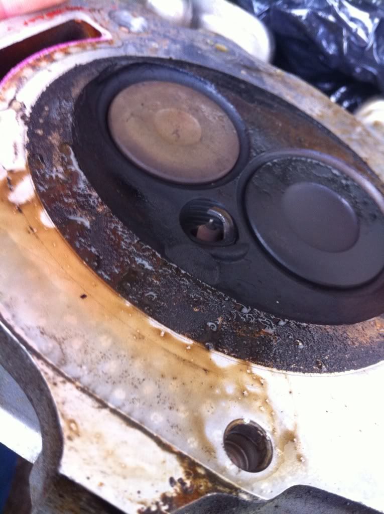

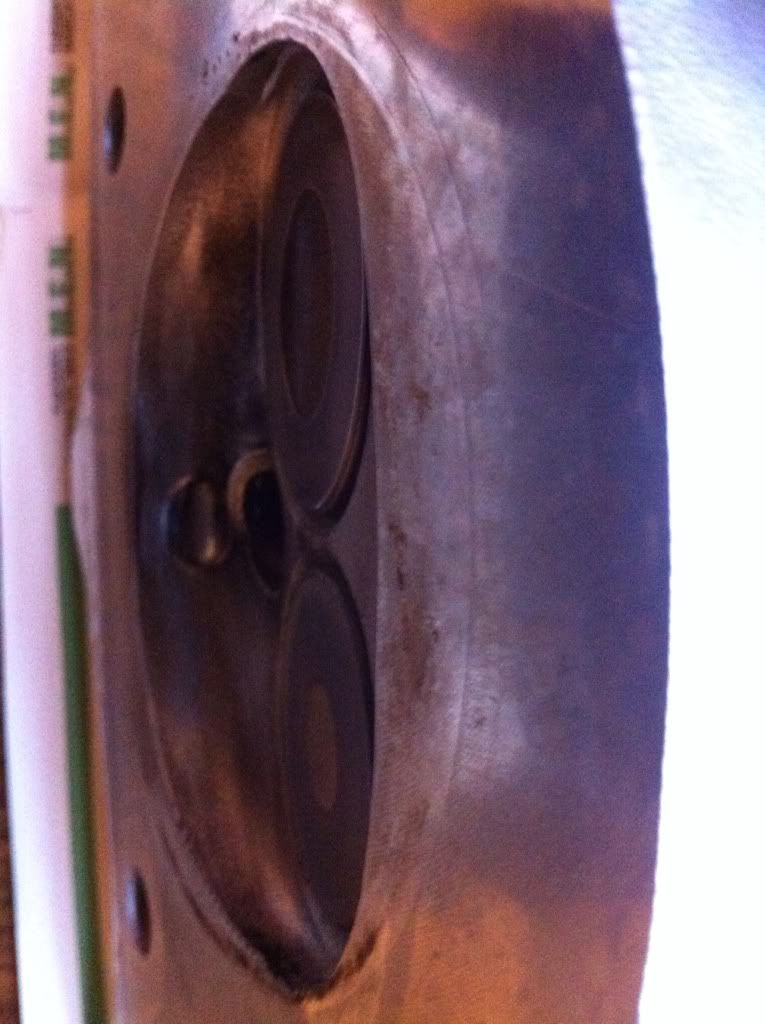

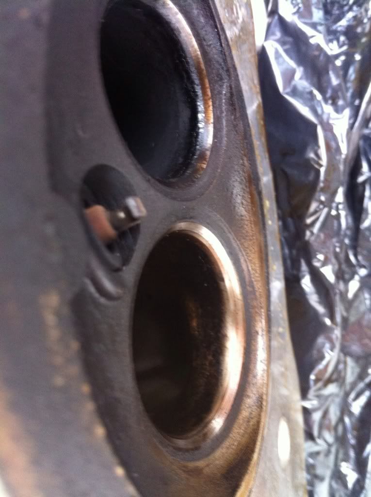

No there not sold as stage 1 or anything just as gas flowed, what exactly is the short side and I'll get a photo. Cheers mikeDarkspeed wrote:Are the heads stamped with the modification stage by the tuner? If they are then I dont see the issue with a photo of the stamp to name them - if that's what they put their name to on a specific stage tune then they must be happy with it.
To be honest there are more than a few heads out there that look very nice but the material is removed from the wrong place and offer no more than casting falsh removal with an emery band.
Your photo does not show the critical area for modification on the port short side.
If they were listed as "xxx" S1 it would not surprise me.

The short side is what you have in a picture above showing the route out to the port - they are not gas flowed and the power would be as stock as the area of main restriction has not been touched.
They are stock heads with a bit of scratching about done with a rough stone in a hand drill. Looks like no harm done but definitely no benefit to flow.
