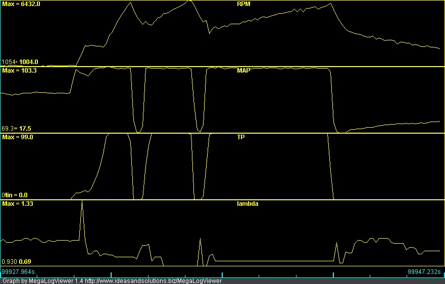

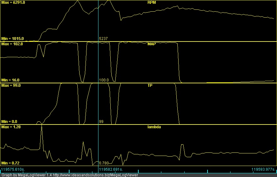

Did some datalogs while on closed loop and running on and off gas today.
On Gas:
Off Gas:
