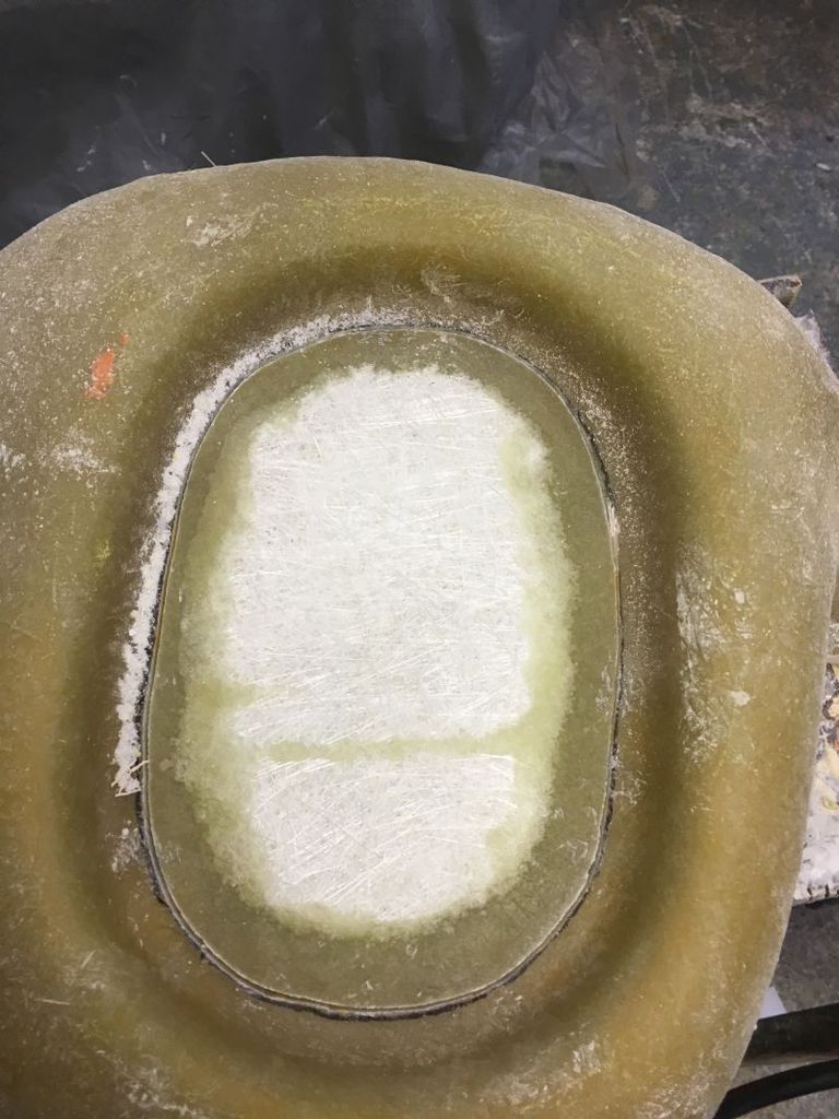

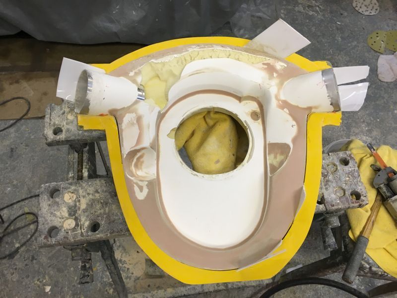

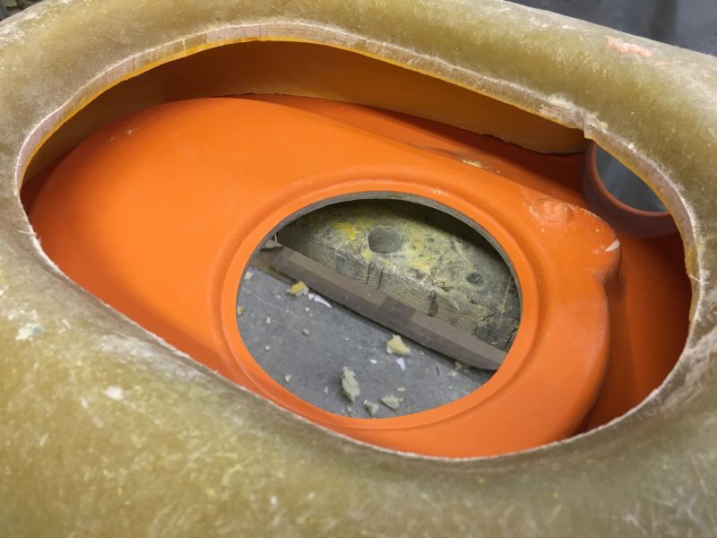

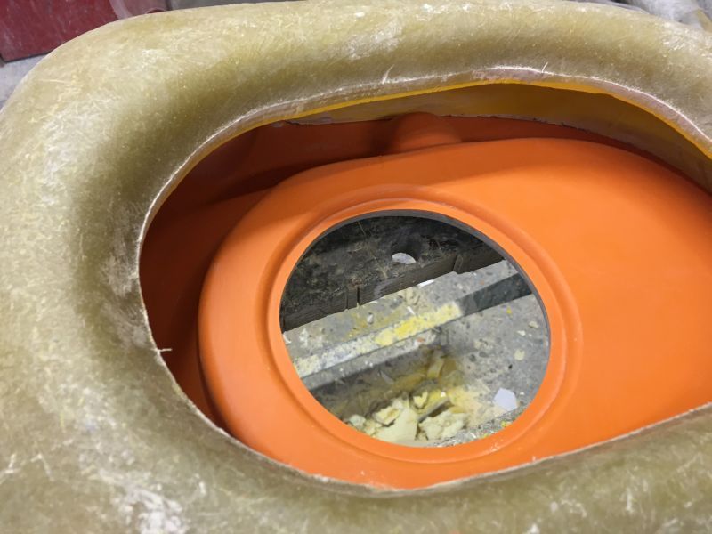

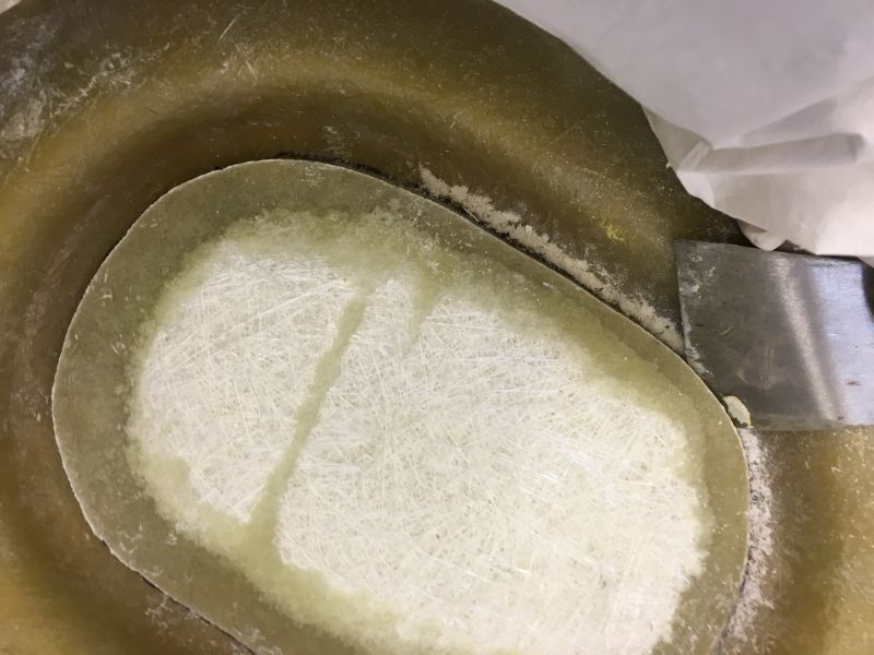

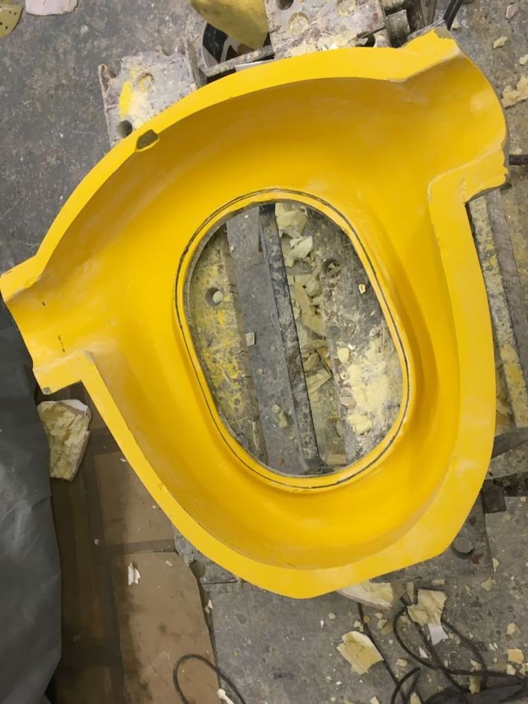

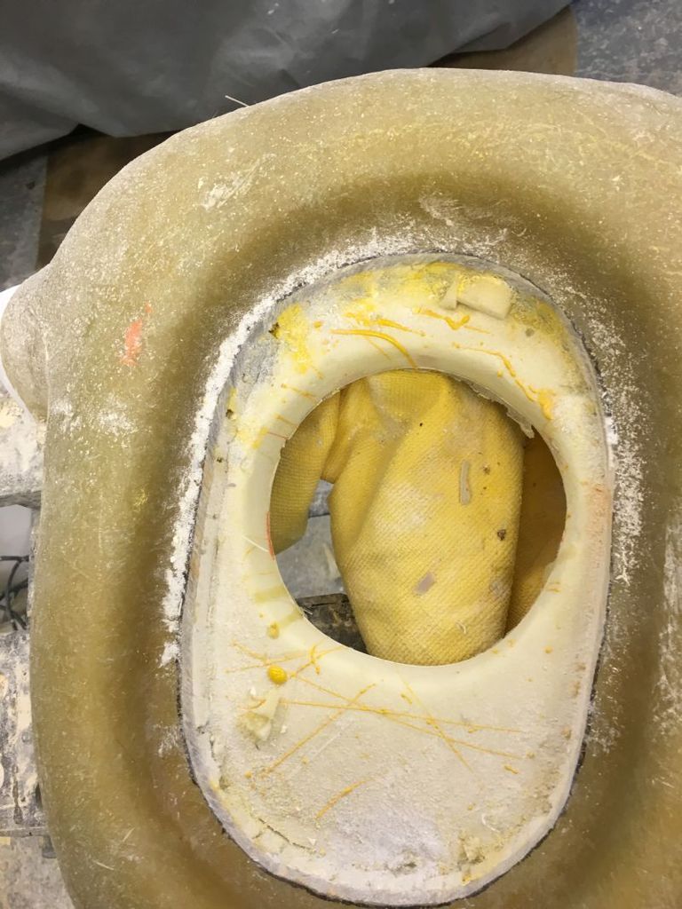

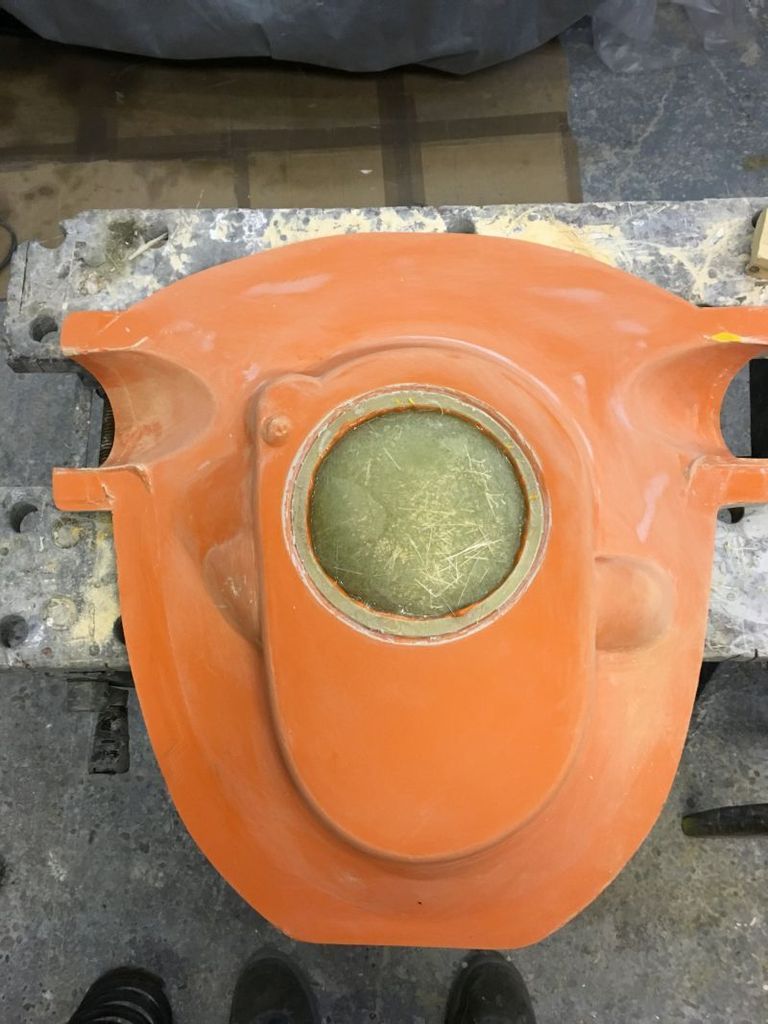

Hi All
I have managed to get some time out in the garage this week and whilst progress has been made things did not work out quite as expected.
Having released the lower section and given that a sand down on 120 and then 400 grit paper it was obvious that I needed to do a few small repairs to make everything as it should be before final finishing on 1200.
I turned my workshop and works van upside down looking for the orange pigment to the point that I thought I was losing the plot as I knew that I had some but could not find it anywhere.
So that part of the project had to go on hold so attention was turned to the upper main section.
Out with the stanley blade pin hammer and a load of spreaders I set to in releasing.
Initially things where going well as the plug could be heard as usual popping and cracking as it released but then it stopped moving up out of the mould which had me scratching my head for a moment as I could not work out what was stopping it.
Ah ha cut out the glass from the top filter rebate you FOOL
Air hack saw in hand I soon made mincemeat of that little lot and this was what was left.
A point of note here it that this area of glass was always to be cut out as it does nothing for the mould at all.
Then it was back to the spreaders and hammer plus a lot of patience as after all of the work that has gone into this i did not want to mess things up now.
Slowly and surely the plug came away from the mould but it was taking damage as it (the plug )was only made from foam some filler and a skim of gel so in real terms damage was inevitable.
The last bit of releasing was a bitch and in all honesty I was maybe a little too sure of how it was going to release once I got to this stage.
What I had missed when prepping the mould all those post ago was a very small lip right at the base of the top filter rebate and this was locking the thing in so tight it just did not want to move.
I only found this out after some severe carnage to the plug which I had hoped to show released and all but intact but the humble pie gods had other plans for me last night!
With everything finally released I could see immediately that there was a small amount of damage to the mould but this is very simple to repair and I will show how this is done maybe a little later on today.
I also need to get rid of the little lip /defect at the bottom and then sand the whole lot down going through the grades and then a good polish up so I can make the real thing.
As the final unit will be just a shell releasing of the upper section will be much easier to do he said hopefully.
With the two sections together you can see that I will have a large internal area for the carb to draw from and with luck it will work out fine .
You can also see that I do need to do a little bit of final finishing around the filter rebate but this is just a few minutes work.
Oh and the orange gel pigment that I went mad looking for?
Yeah my son had it in his van but never told me he had took it from the garage.
What a bizzare way of handing your notice in........

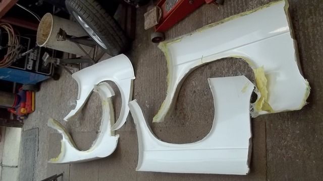

I will hold back from doing my normal repair method - and see how the professional approaches it -

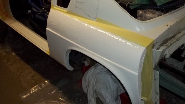

A bumper mould I made - I forgot to releive the gel around the edge of the part and a bigger chip than usual.
I have also been doing a few "splash" moulds to repairs to Ginetta G15's I have a front end to assist in repairing.
I have also bought some 288g satin weave and some 225g glass to make a bumper part from - will see how it goes.
For a standard wing panel lay up I find that - gel/ tissue/300/450/450 makes a nice strong panel around 2.5mm thick the 300 wets out quickly and forms to any tight curves easily and then the 450's just work well taking the resin.
Using the Gelmonkey wicking up resin removal method I ended up with some of the nicest lay-ups I have ever done - I owe you a few beers for that.

Bit a thread hi jack - apologies Paul,
These moulds are not typical as they are not complete panels - although that is a bit difficult with a G15 as there are only 5 panels for the whole car. There are not any parting "shutters" on these where the moulds return back on themselves which would normally make the mould impossible to remove. On these area;s of the panels I only lay up tissue and 300 - this makes it flexible enough to remove but still provide a " lock in" for location.
First off I always use PVA - not great as it does not produce a perfect mould - you do need to work on the surface after - but if you plan to paint and not just leave in gel its not so important.
Three coats of wax over the PVA - I then mask out an area about 3" wider than the PVA and mask it - Gel / resin will not stick to masking tape the silicone release on the paper itself prevents this.
I had to extend the return on the wheel arches as these had been cut back on this car so I built them up with cardboard and masking tape to lay up against.
If needing to make up shutters for multi part moulds 3mm foam board is good stuff.
Hope this helps
Andrew

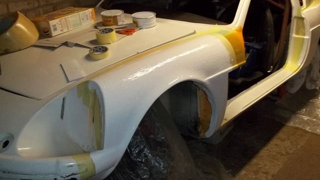

Also you will have no need to sand back any ripples or overlays from masking tape thus cutting down on working time.
If using the tape to hold the cardboard in place then why not use hot glue instead and then just soak it with acetone when ready to remove as this chemical makes the glue very brittle and it just falls off.
The other thing I noticed in your previous post was no cradle on the bumper mould unless it cannot be seen from the angle of the picture.
A small simple cradle would help stop the mould from moving around as you worked on it.
Again just a thought and PLEASE correct me if Im wrong
Hi Paul,
I am no more than an enthusiastic amateur and learning all the time - it always seems to be freezing cold when I do any of this and the gel coats when I done anything has been a single coat - which tends to end up about about 0.25mm thick at a guess.
I did note your 2-3 coats comment and thought of doing a couple on one the o/s pair of moulds but I only had a litre and it was going to be close getting all the moulds out of one tin.
I am all ears to how you do these things - With 6 glassfibre cars I am eager to learn. And please - I will not be offended if you put be straight on things I am doing wrong far from it.
Andrew
ETA
- I would have used the hot glue gun but when I came to look for it - AWOL - just a bag of glue sticks.
The masking tape just give me a nice line to work to no real need for it on the body - With the arch it allowed me to produce / build up a working return angle .
Andrew
ETA
