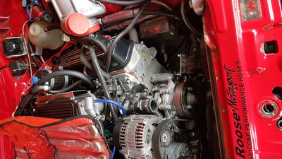

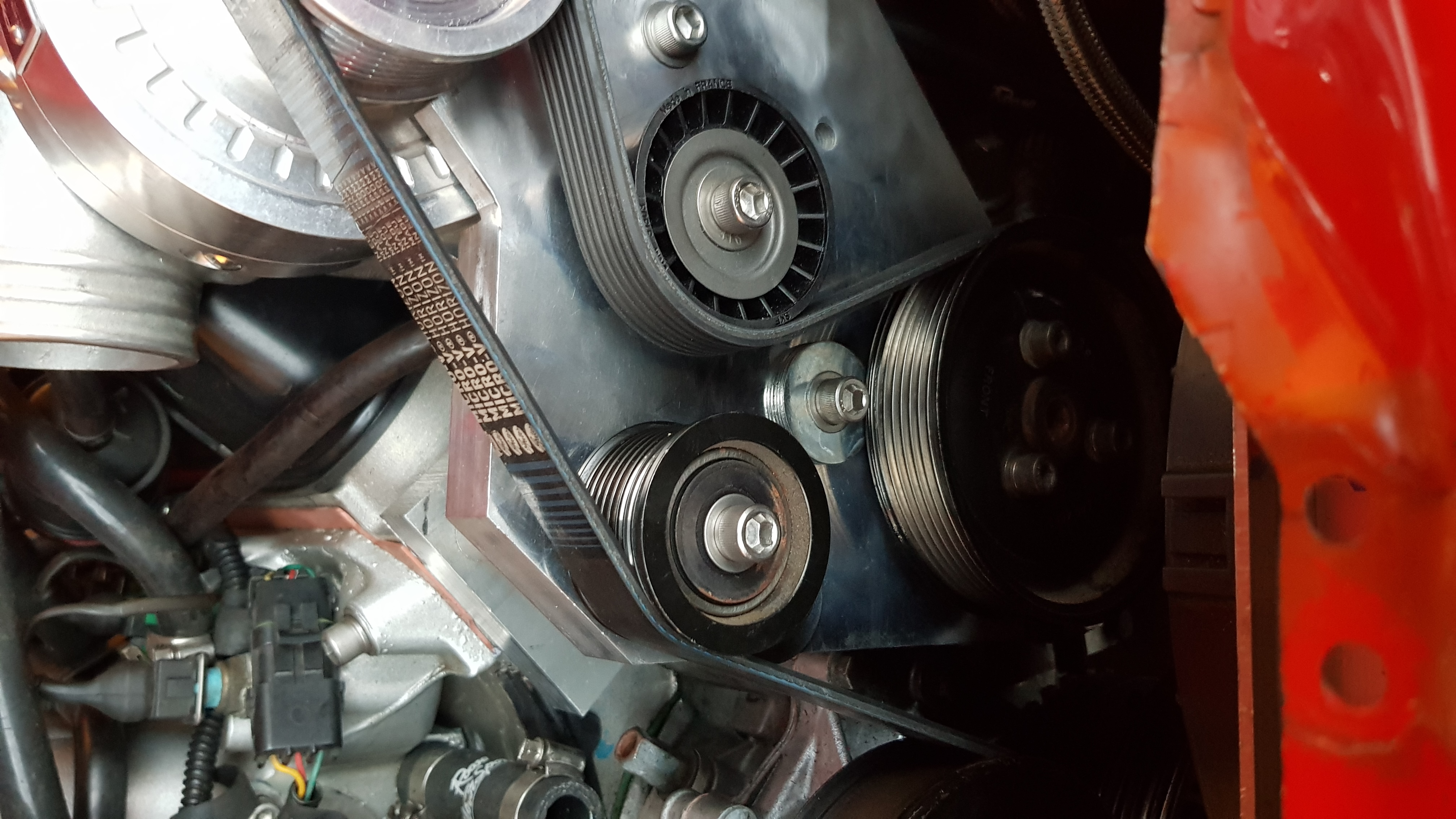

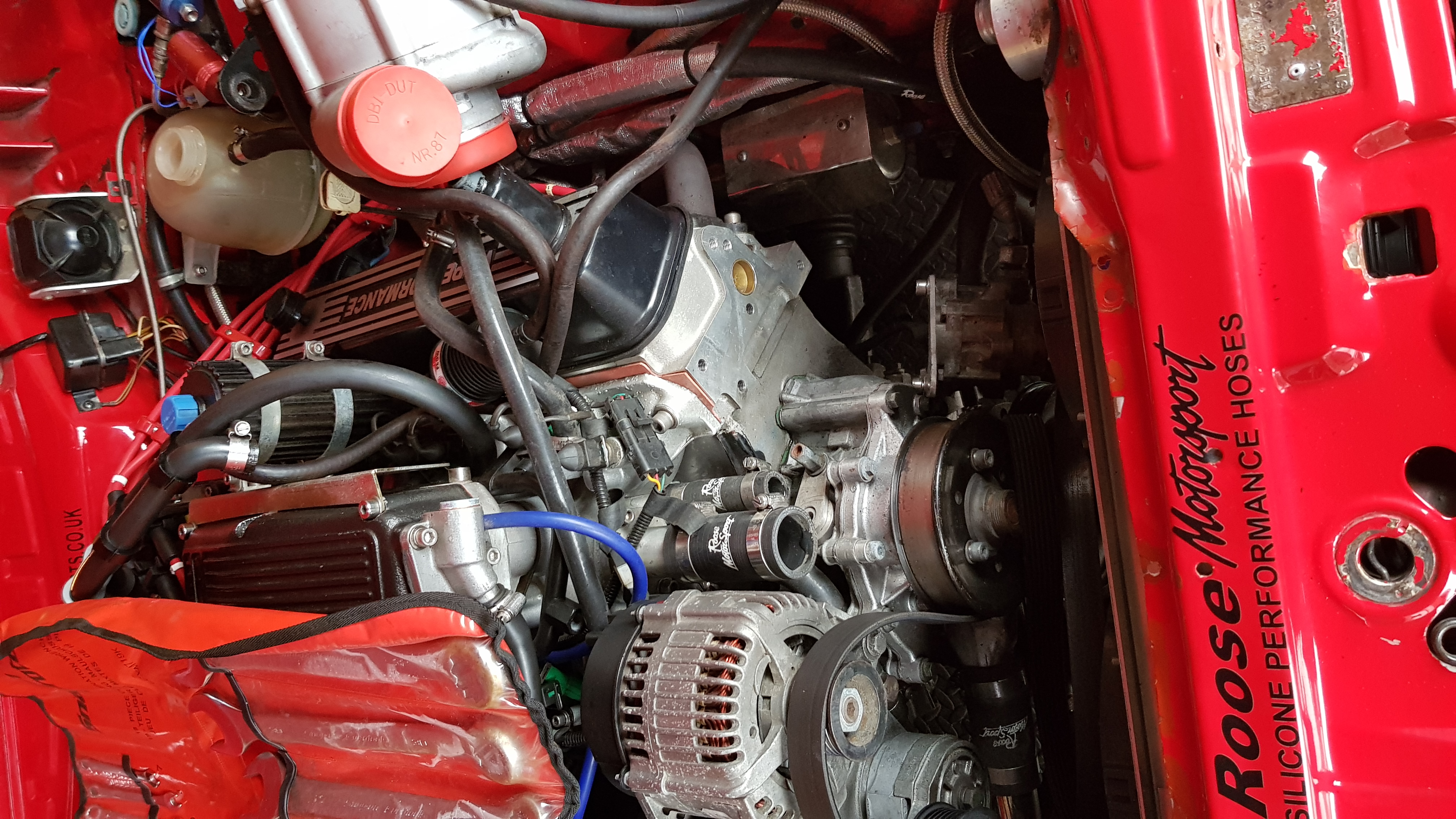

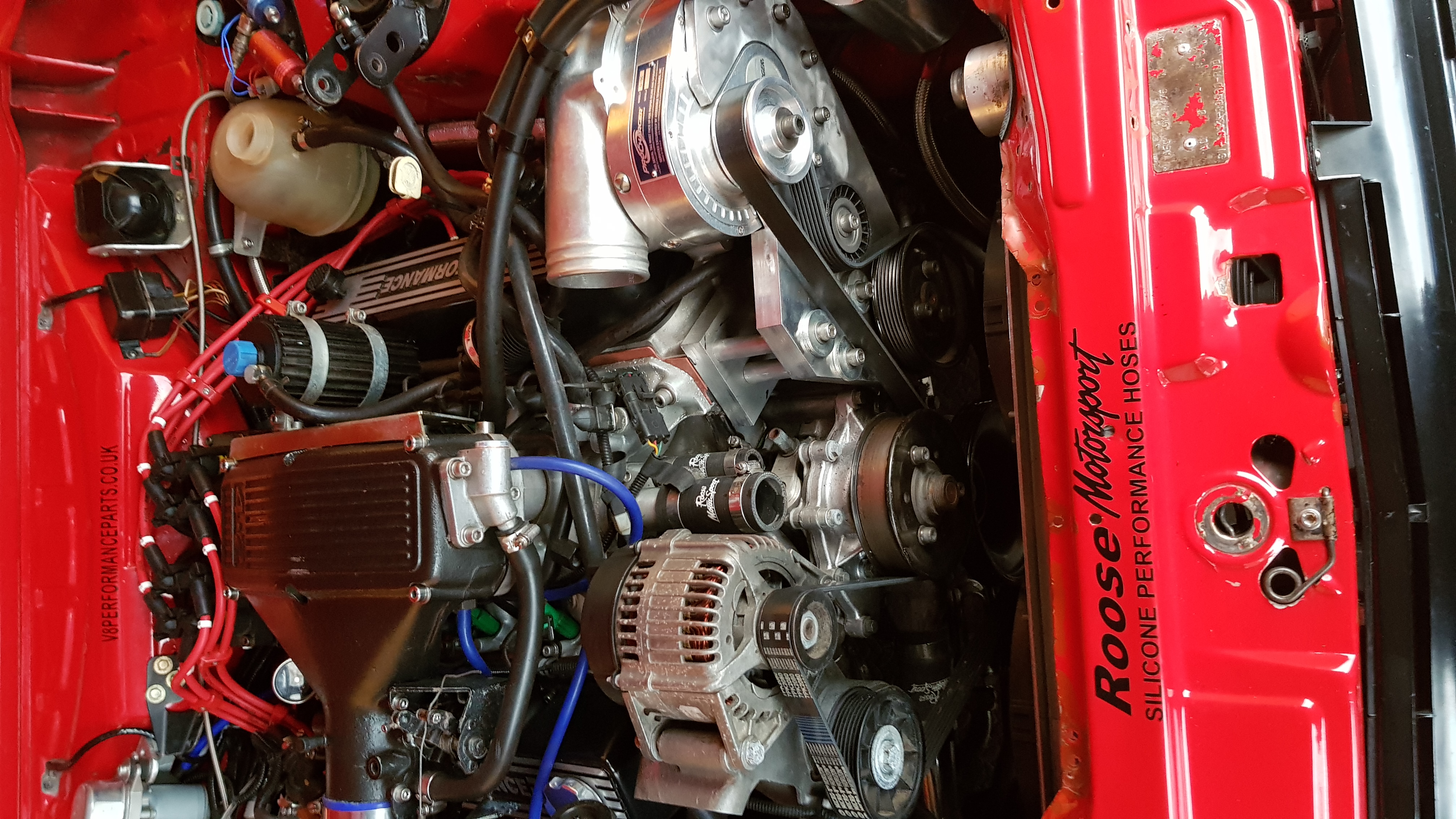

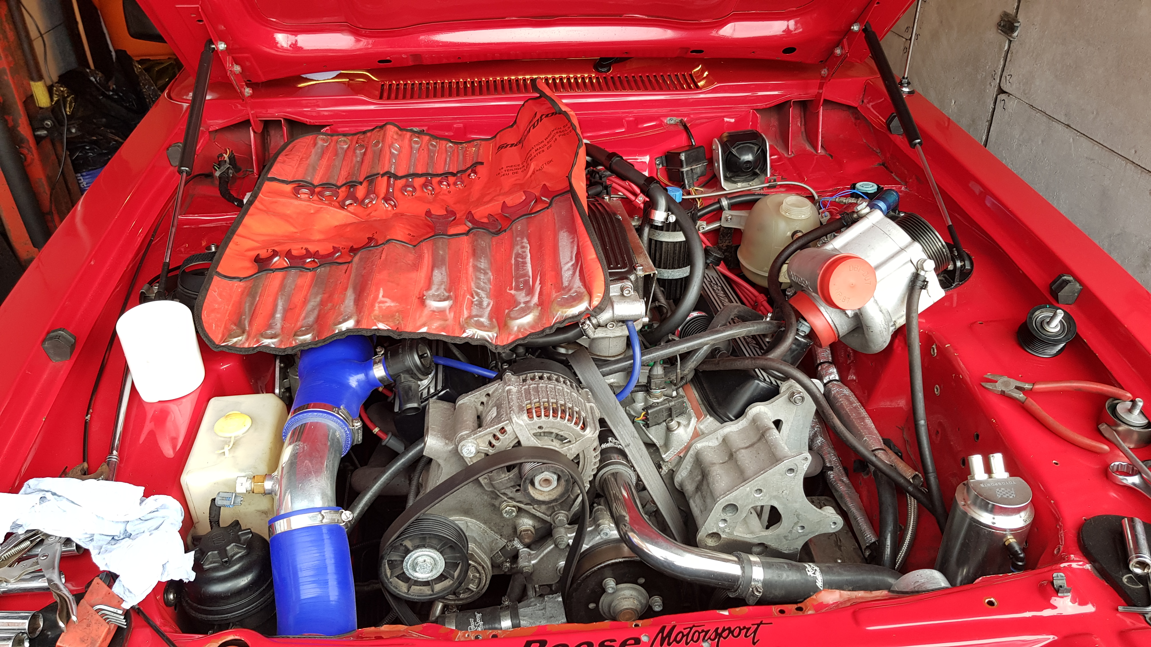

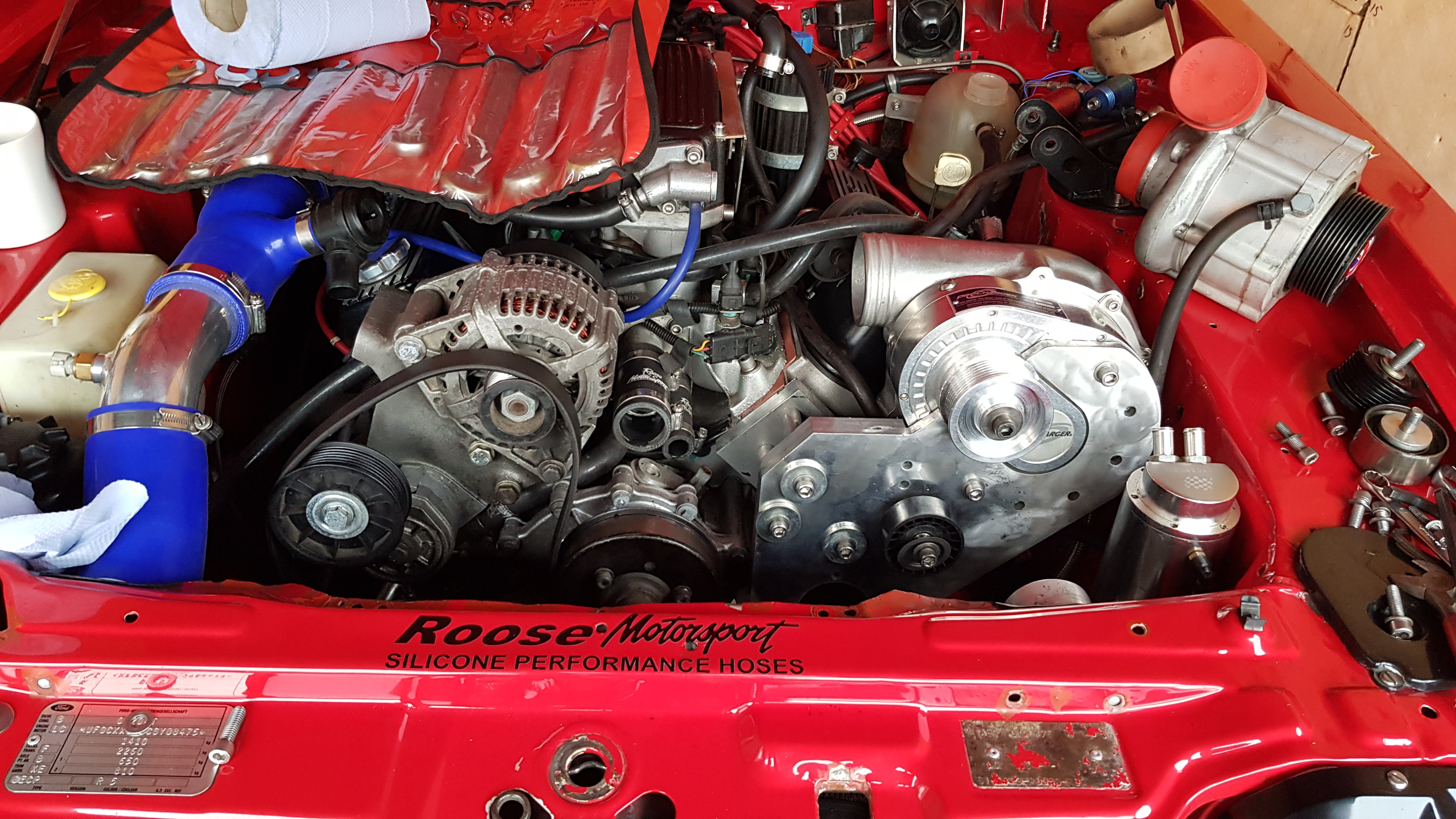

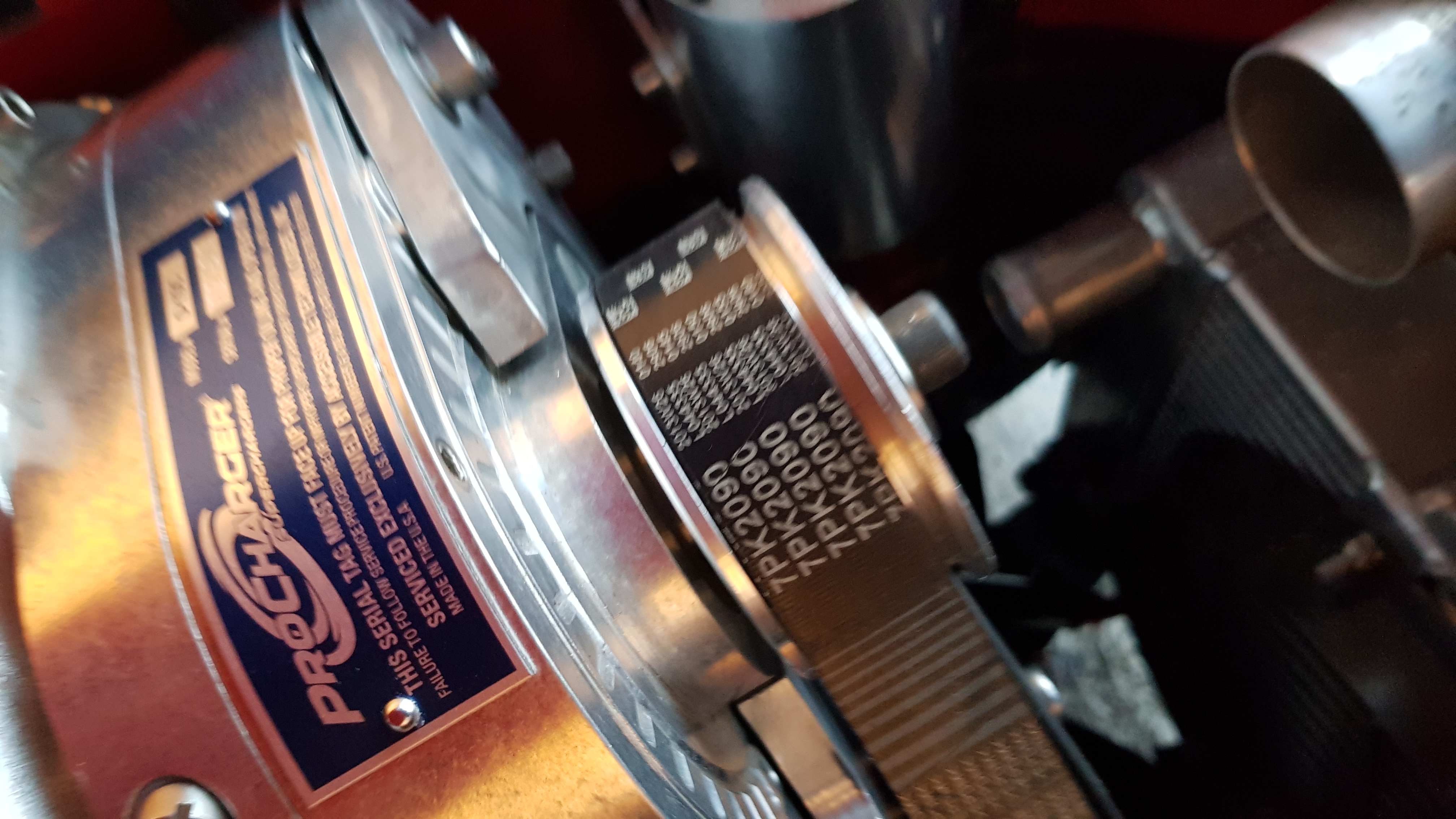

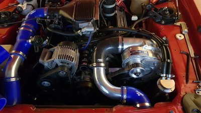

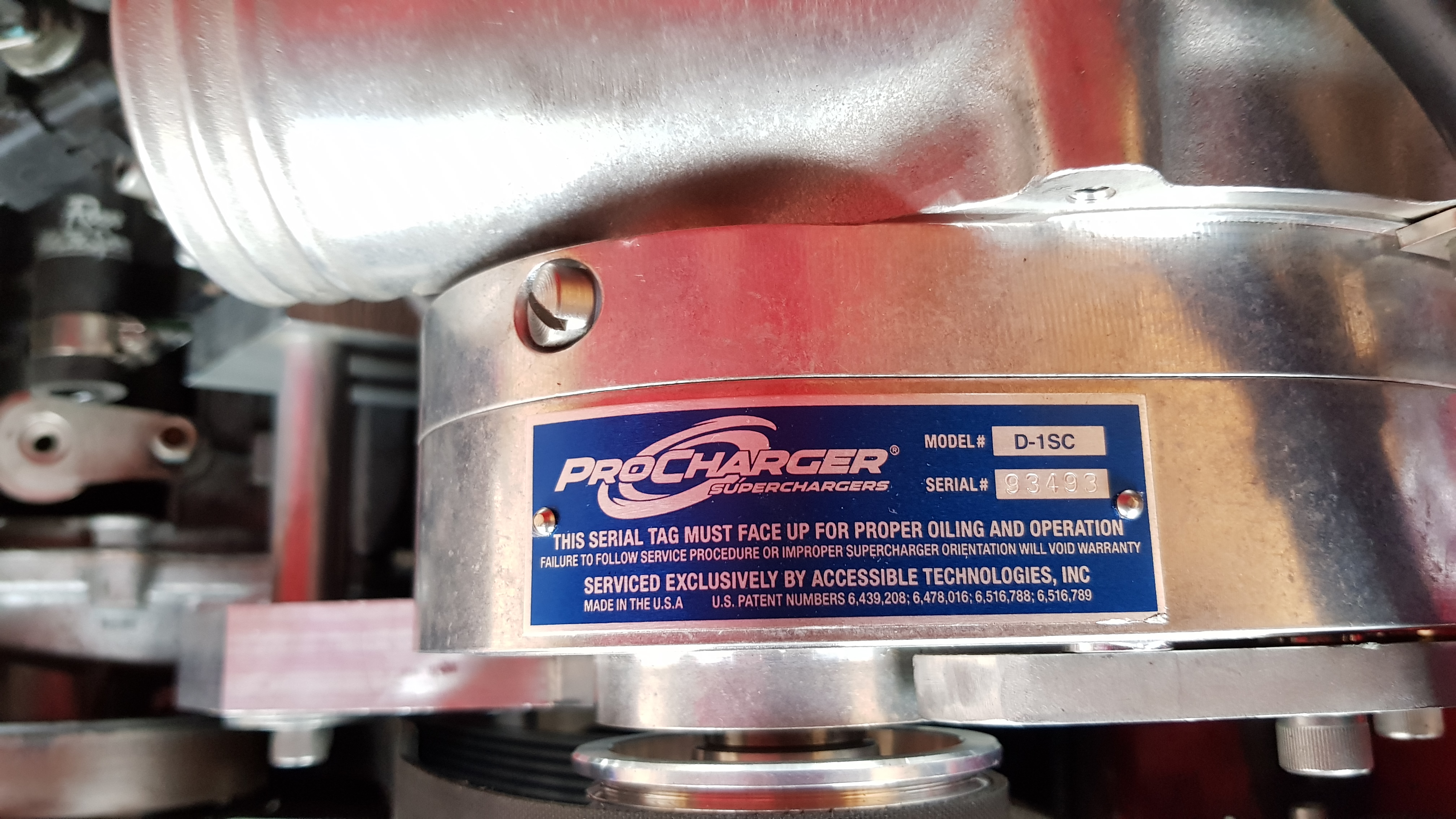

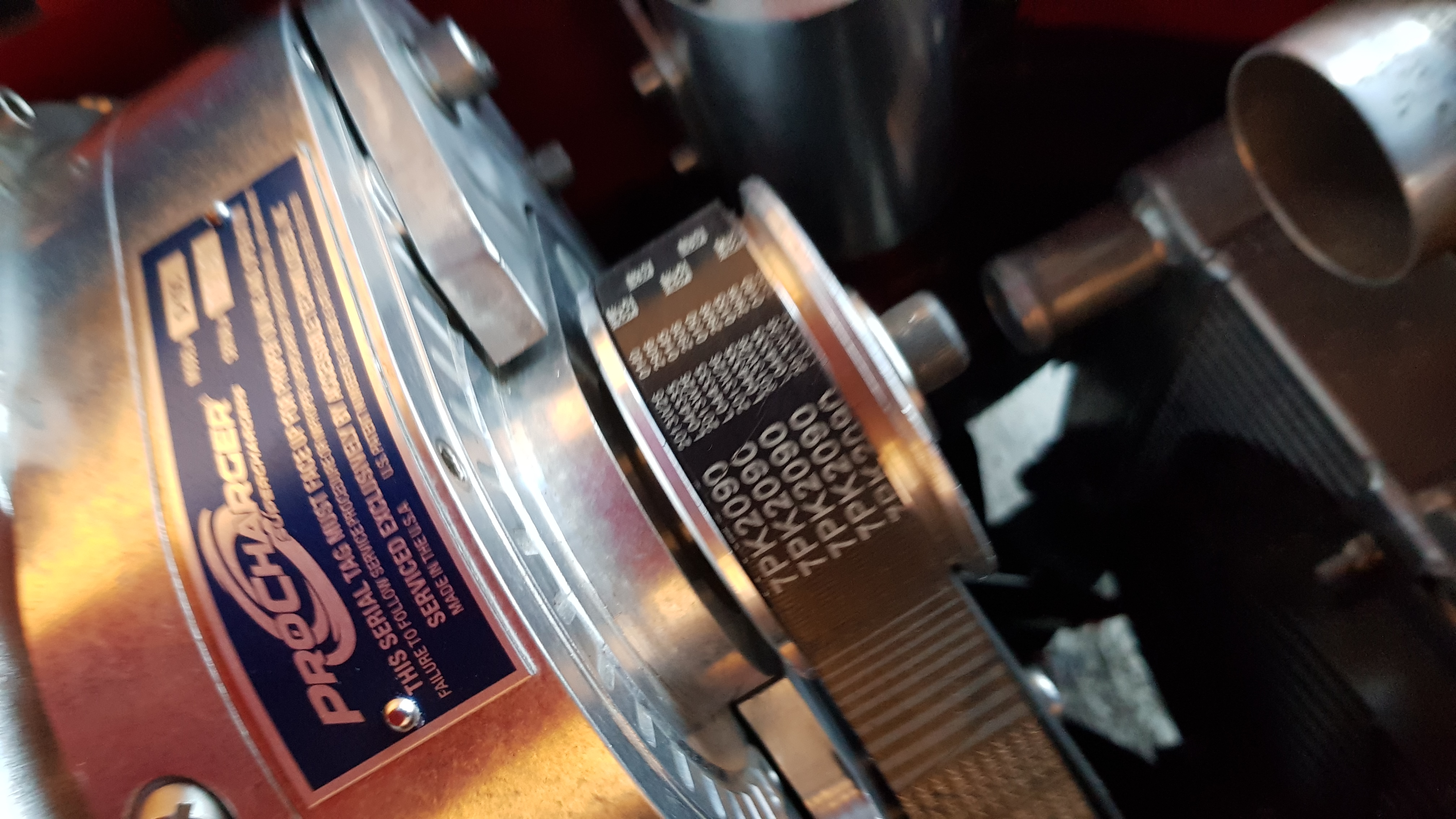

Rotrex Charger Off, Brackets Off, Procharger And Bracket In Place, Belt Fitment, Second Idler Needed Too, D1SC Charger, Off The Shelf Belt Too, Belt Fitted And Under Tension, Second Idler Now Fitted, Boost Hose Installation, Top Rad Hose Still Fits Too,
The procharger sits under the bonnet a lot lower than the rotrex, 95% of the hoses seem to go back in the same place, need to source a couple though due to size difference in the two chargers,
And the charger inlet is slightly touching the rocker cover so the bracket is currently back with Allan being modified as we speak,

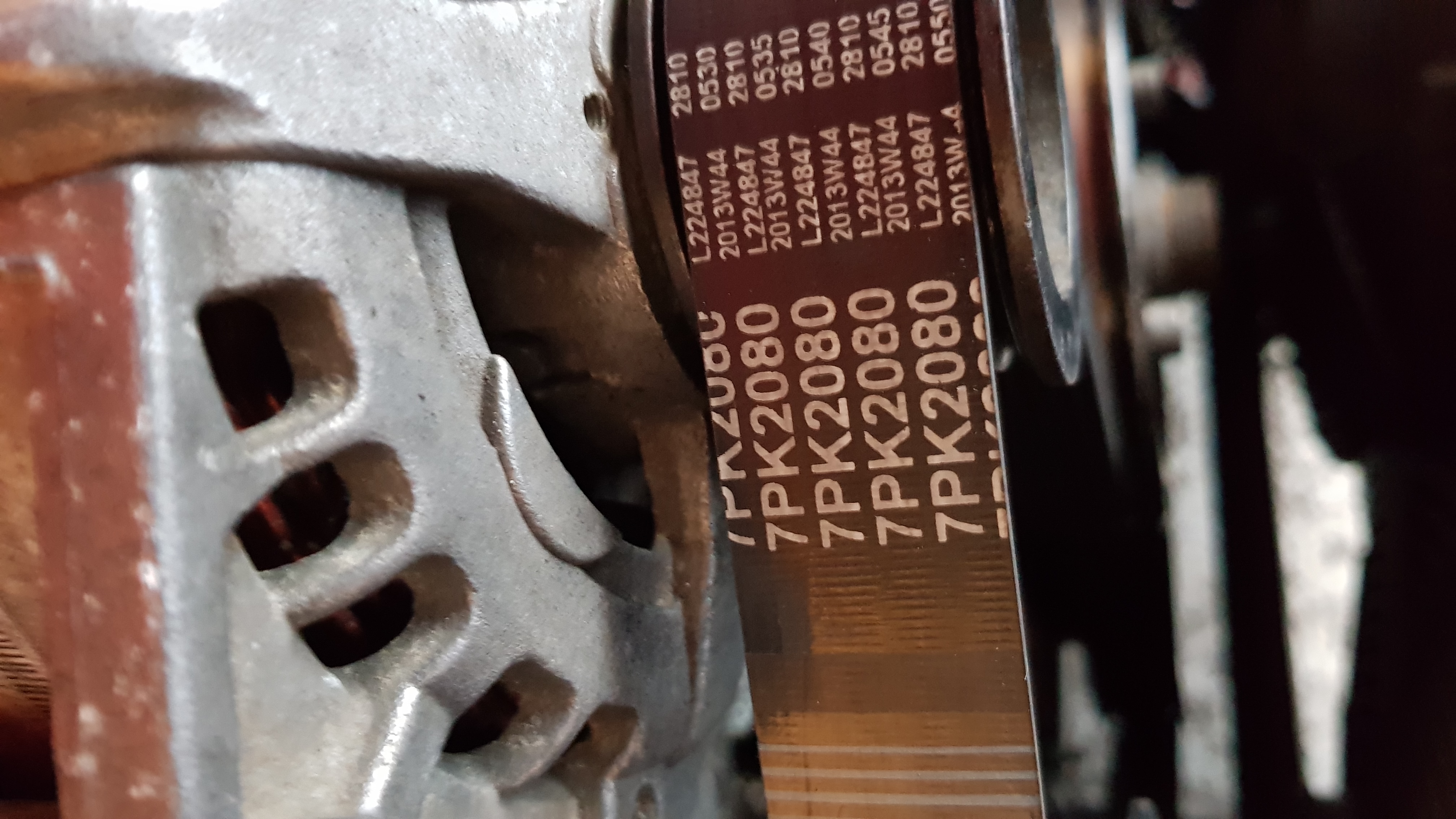

And also having a 3rd Idler gear fitted now down by the bottom pulley between it and the power steering pulley to put more wrap on the crank pulley to reduce any chance of the belt slipping,

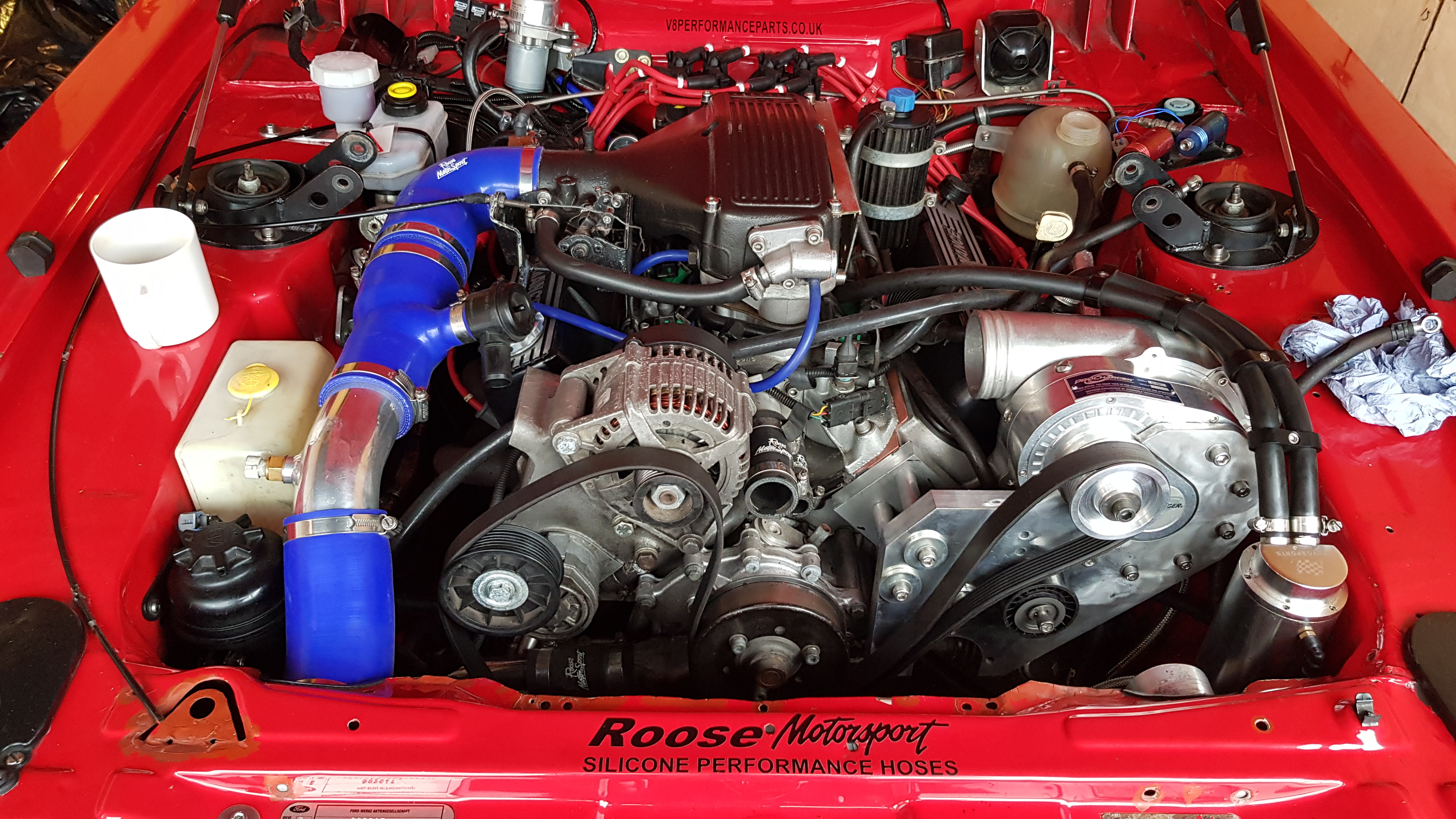

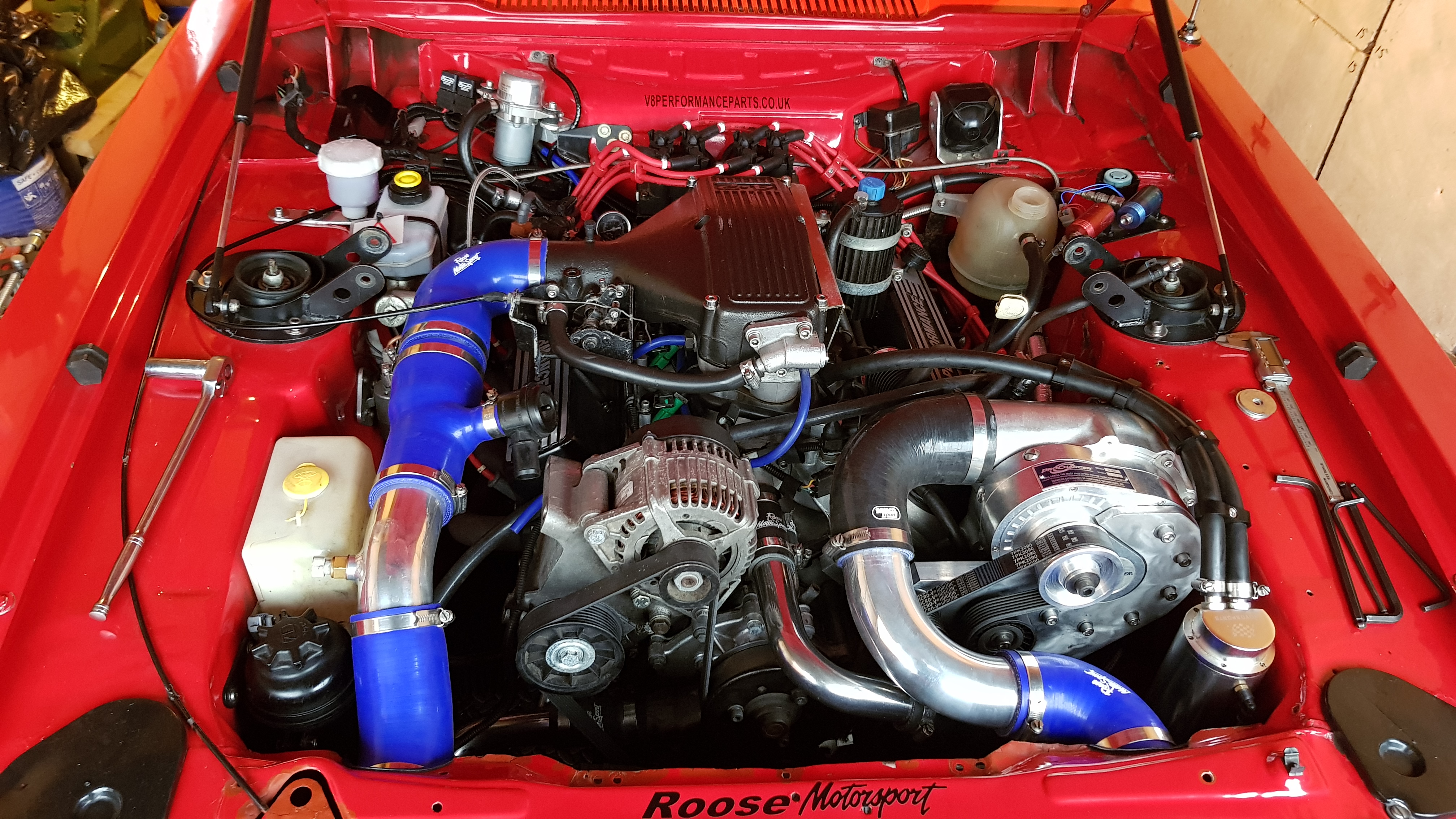

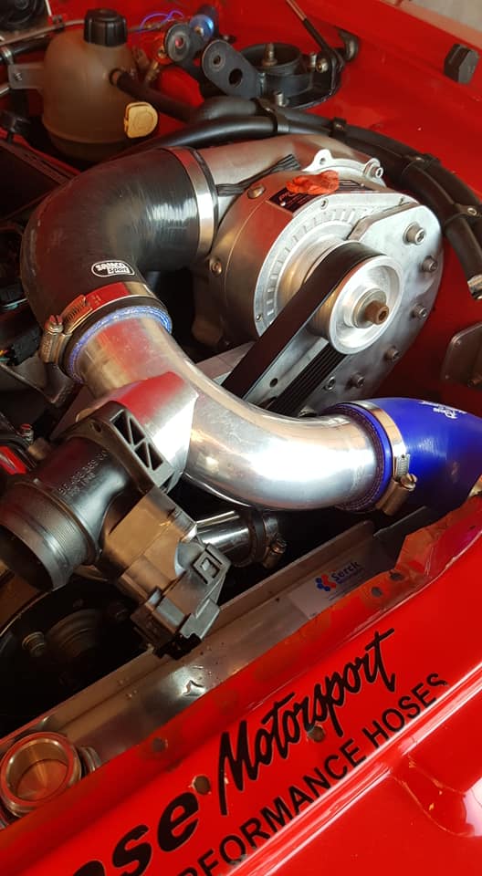

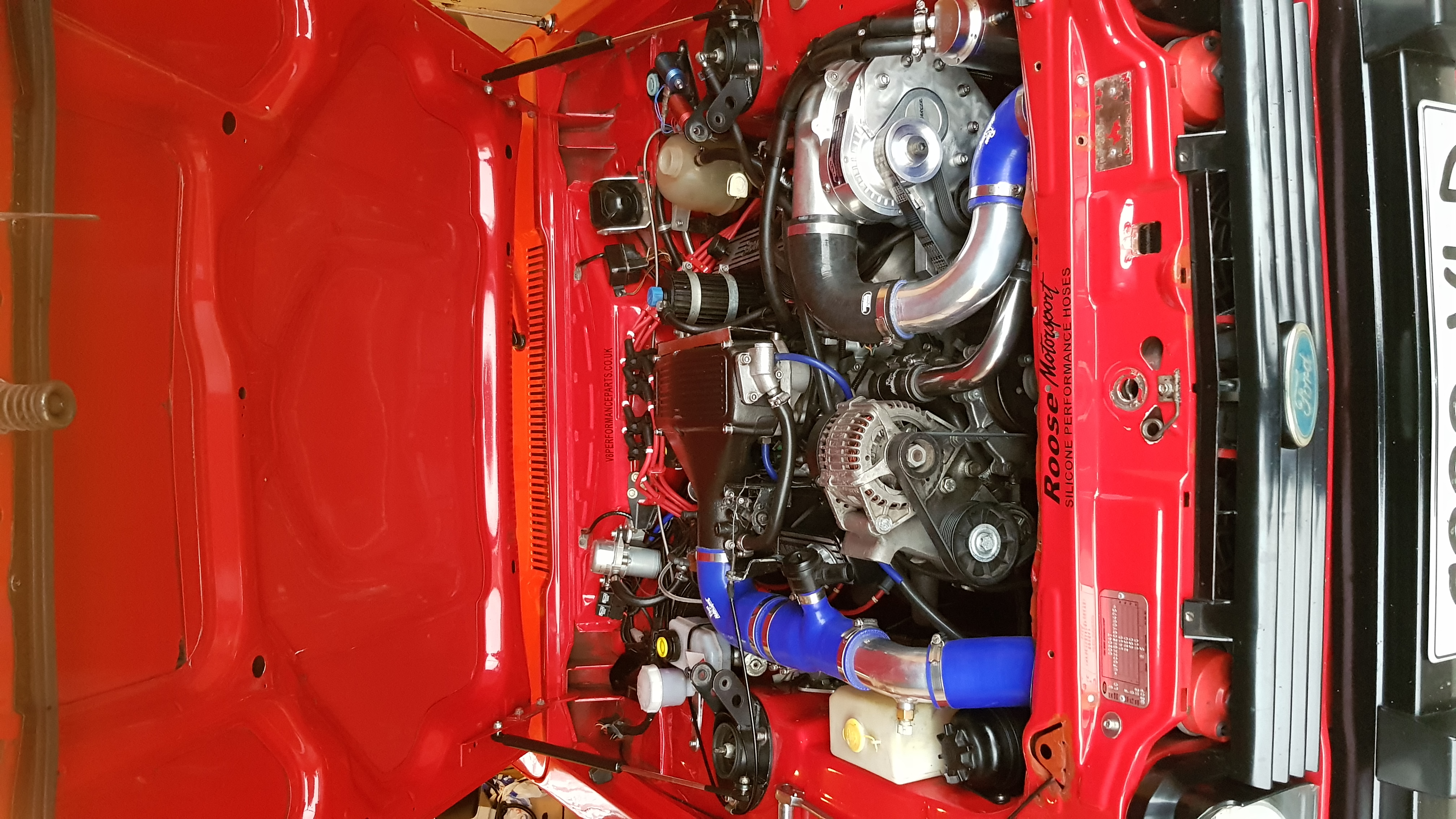

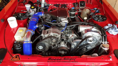

The D1SC procharger is now on, bonnet needs a little bit of relieving work doing on one of the strengthening ribs where it hits the charger now after we had to move it away from the engine,
Servo has now gone due to having to run vac pumps etc due the cam, and been replaced with an ABS pump from a sierra (minus the ABS setup) using it as a power booster for the brakes instead of a servo,
starting to make the cradle now for the water canister to be mounted in the boot for the water injection kit,
And the pipework is back from being machined for the boost controller, next job is to get it welded to the charger outlet pipework and get it wired up to the ecu,
IAC stepper motor has now been ditched for an extra air valve for cold starting etc, this is also needing fitting and wiring up,

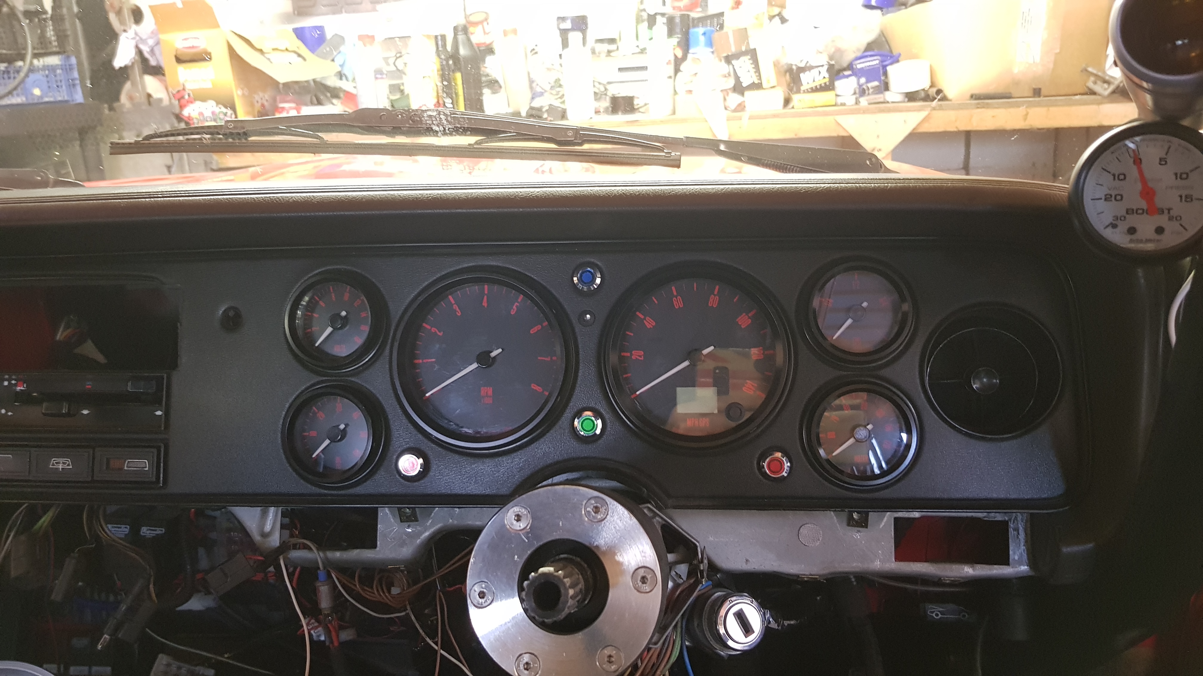

Capri dash dials have now gone due to electrical gremlins and been replaced with a set of speedhut revolution gauges , gps speedo and programable fuel gauge, along with shift light rev counter and telltale recall,

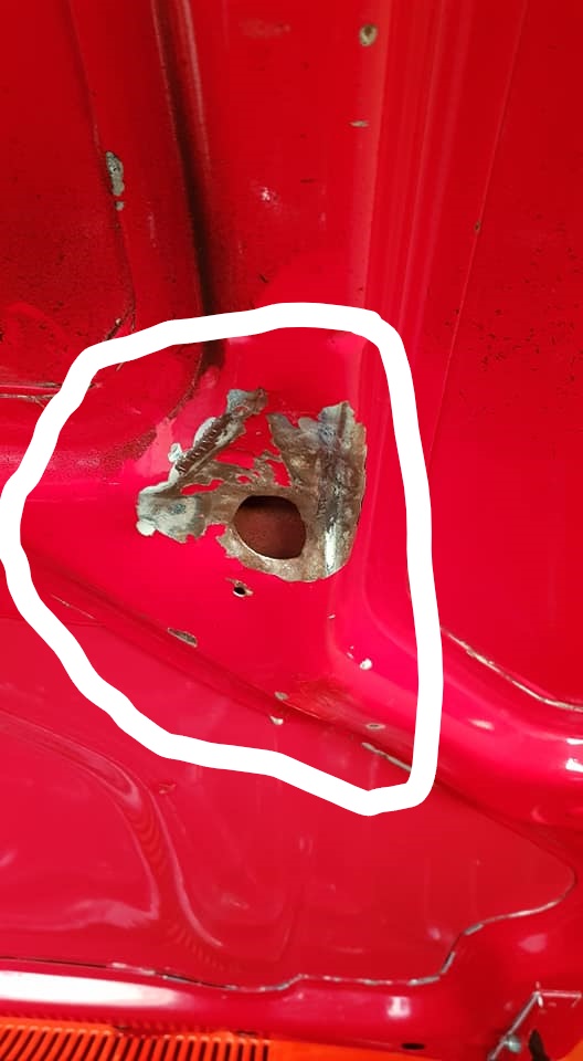

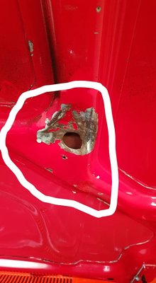

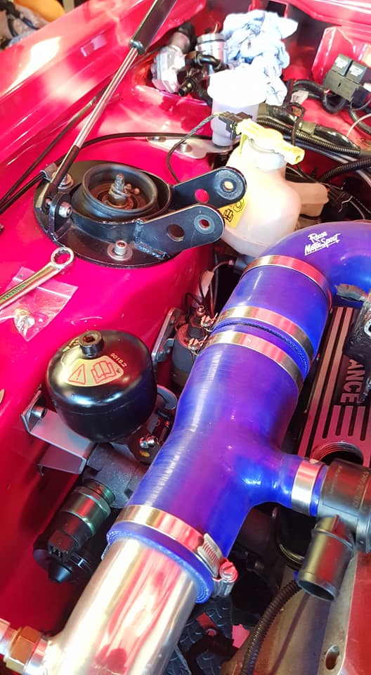

ABS main pump fitted to inner wing prior to plumbing in, Reservoir/master cylinder in the background, Boost valve, hammer rash to the bonnet- this will be cut out and shaped and welded up once weather allows the car outside with no bonnet on,
