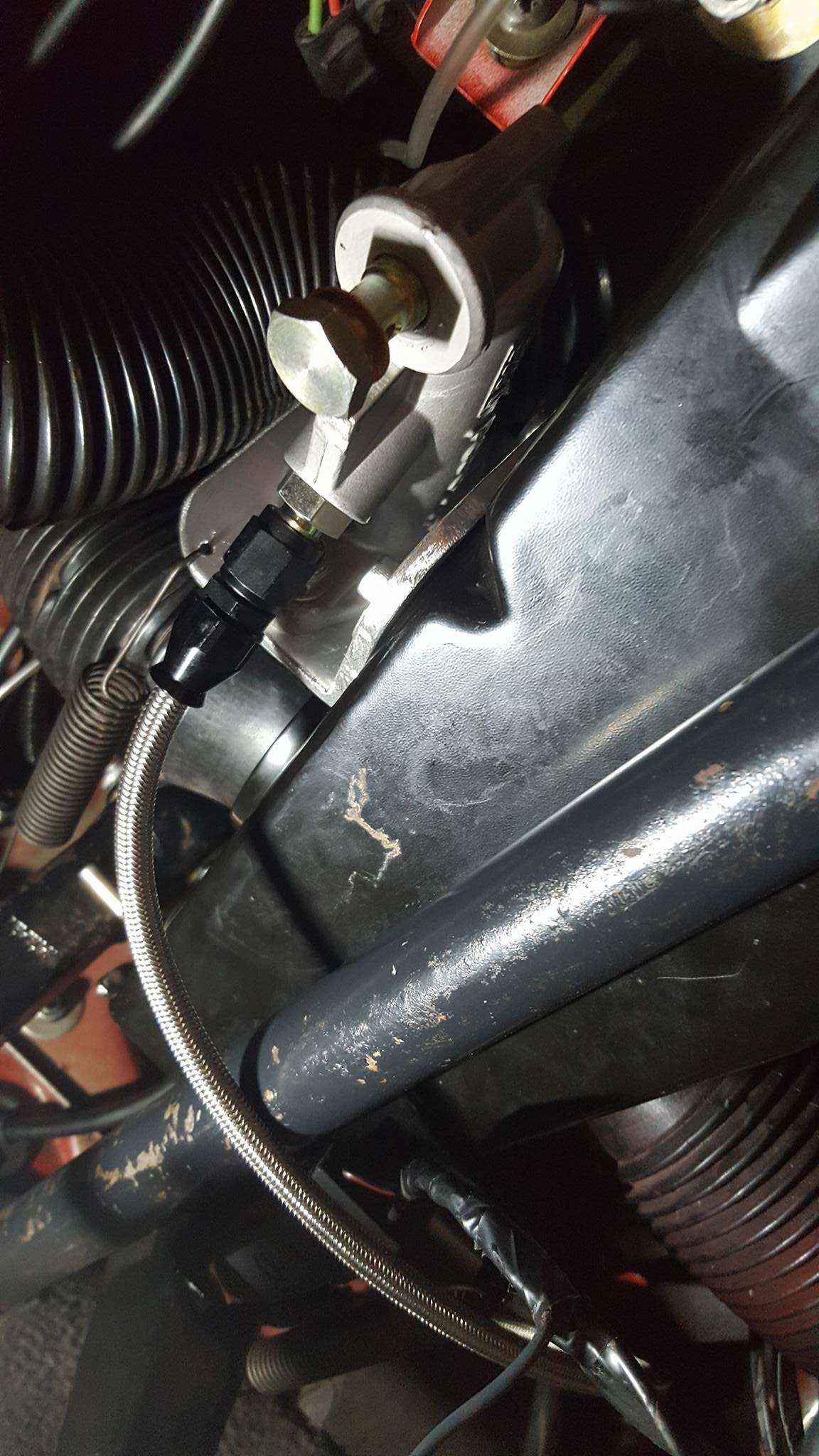

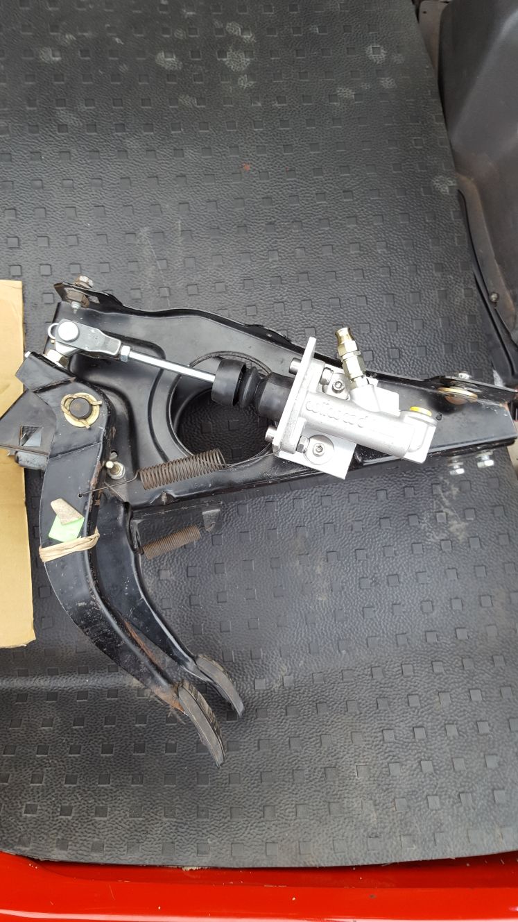

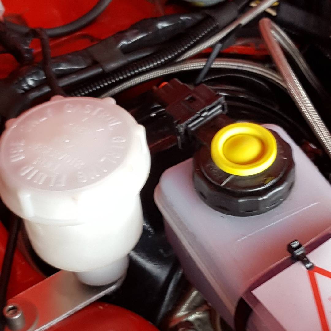

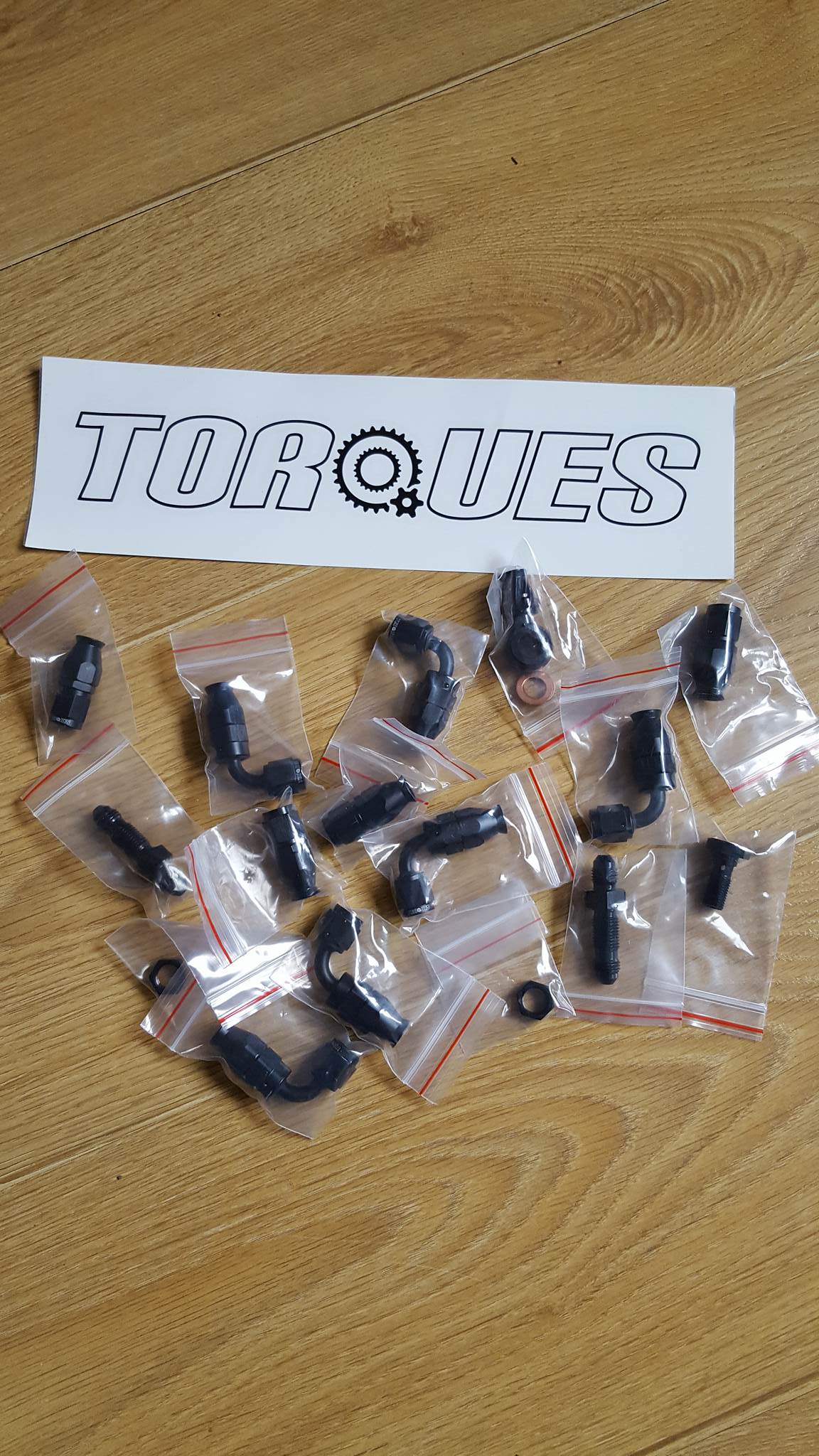

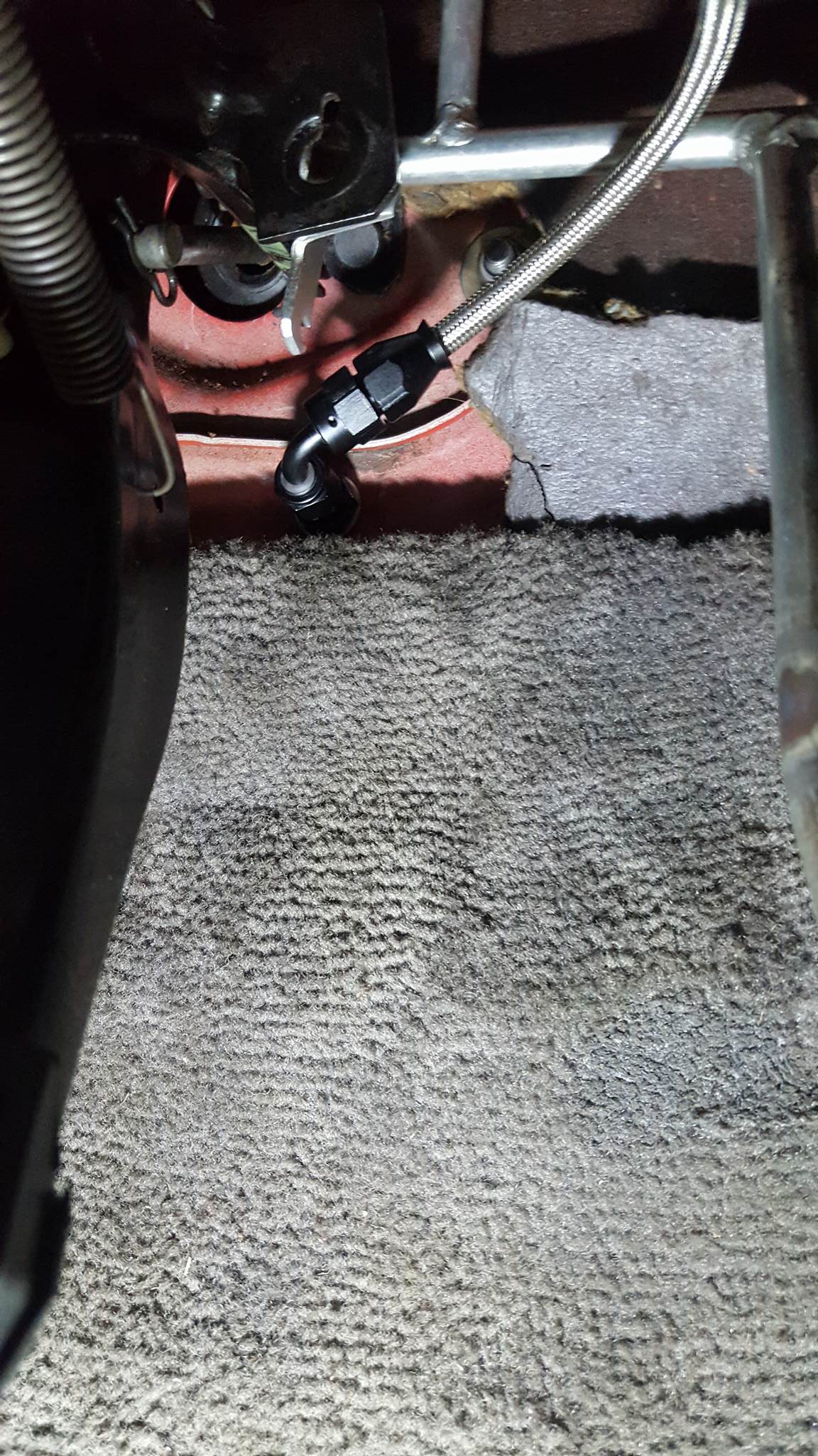

A few of the hydraulic clutch conversion
