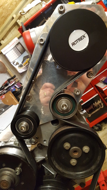

wont work mate the belt sits 3mm off the face plate so will sit right across the current mounting bolts lol

I have a catalogue coming next week of all the ribbed and smooth idler pulleys available on cars in the uk,
so maybe able to come up with a slightly smaller smooth pulley which will give me a little more scope using a ribbed pulley too,
will also try the larger charger pulley tomorrow to see if that gives better clearance as that is the pulley we more likely be using to allow the charger to be not over reved at 7k,
there is the option of possibly changing a couple of the bolts to countersunk ones if needed but until I can get hold of a few pulleys to play with I'm a little stuck lol

I'd say there are very few passenger cars using an 8 rib belt.
As the ebay link shows, probably more common on big engines, whether lorries, plant, whatever
The same link also gives part numbers, for Gates and other suppliers which you could search. But it wasnt expensive even from Latvia or wherever it was listed for an 8 rib idler.
Always room for one somehow.
Although you could try it as is, you'd know soon enough if it is going to cause problems
yeah true mate,
i'll see what its like with the new charger pulley on then take it from there

been there all ready checked that mate lolJP. wrote:That might be a challenge to fit the Capri's engine bay....Coops wrote:........now the charger has moved sideways 25mm, ......
after a bit of shopping around and a few let downs I now have a few selections of 7 and 8 rib pulleys coming for the charger belt,

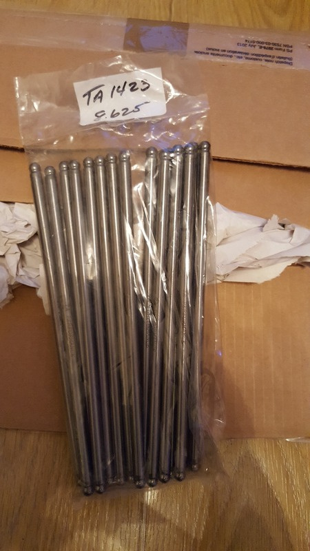

Push rods have arrived. And fit a treat Ordered a ribbed pulley from the USA as the UK is useless

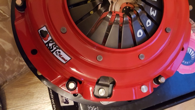

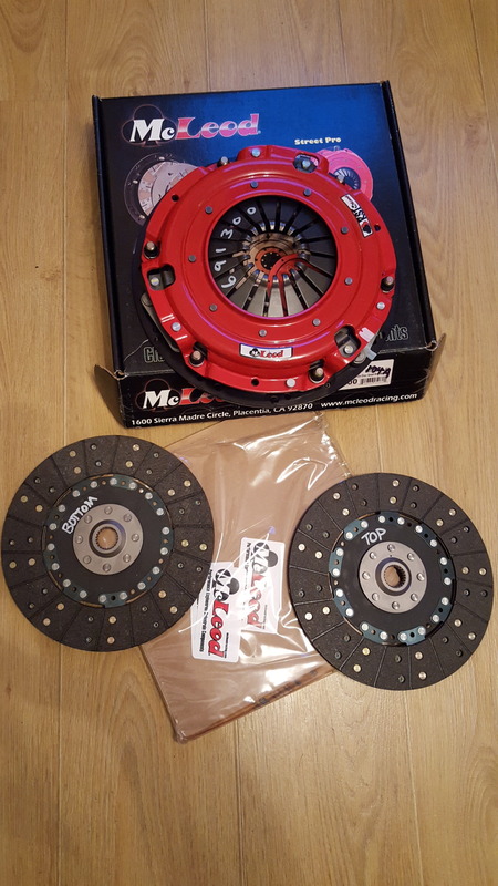

And fitted it along with countersunk bolts behind the belt route. And the new clutch is here. Just waiting on the new cover plate bolts to arrive. The Flywheel can go off for facing and redrilling then balancing again.

trying to source a 7PK 2187 belt is a right pain in the arse, all they keep asking is year and reg, once you say its for a one off installation the reply, sorry can't help you without a registration number,

The flywheel and clutch are away at present being faced, redrilled to take the RST clutch then rebalanced,
I now have a few measurements to work with to try and see if the release bearing carrier needs machining to clear the RST clutch, and if we have the correct travel on the release bearing as not to damage the pressure plate,
handy thing a cable clutch conversion just change the pivot arm point in relation to pedal v release bearing travel if needed lol,
