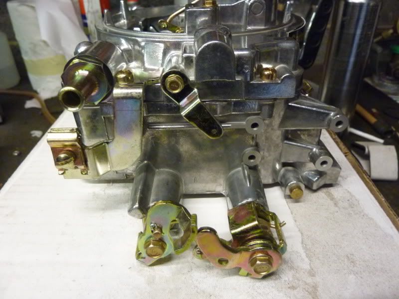

Just trying to attach my choke cable to the edelbrock carb and the screw hole seems really small, any ideas where i source such a trunnion screw to fit to the cable and lever,

The hole is not really meant for a screw but you can always drill it out if you wish. You can bend a 'Z' into the single strand choke cable and feed it into the hole on the lever.
On my carb I soldered 'clevis' that you can buy from model shops, I don't use the threaded adjuster the you get with some, I just solder the thing straight onto the choke wire.
BTW alot of people don't use the choke including me, I have removed the actual choke flap, I only use the fast idle part of the mechanism.
Finally if your carb is brand new you should re-jet it to suit your engine, if you don't it may well run rich which is very bad for the cylinder bores.

The engine was built up by v8dev and they had it up and running before i picked it up so should be all set up properly.
I think there must be a screw fitment of some sort rather than soldering and thought i would enquire here before making the hole bigger, any other suggestions appreciated,
