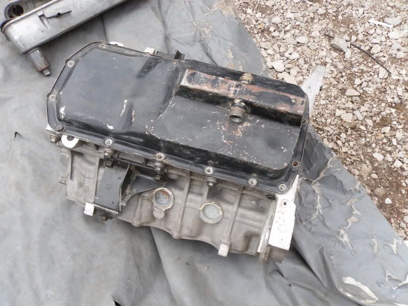

Dry sump pan............

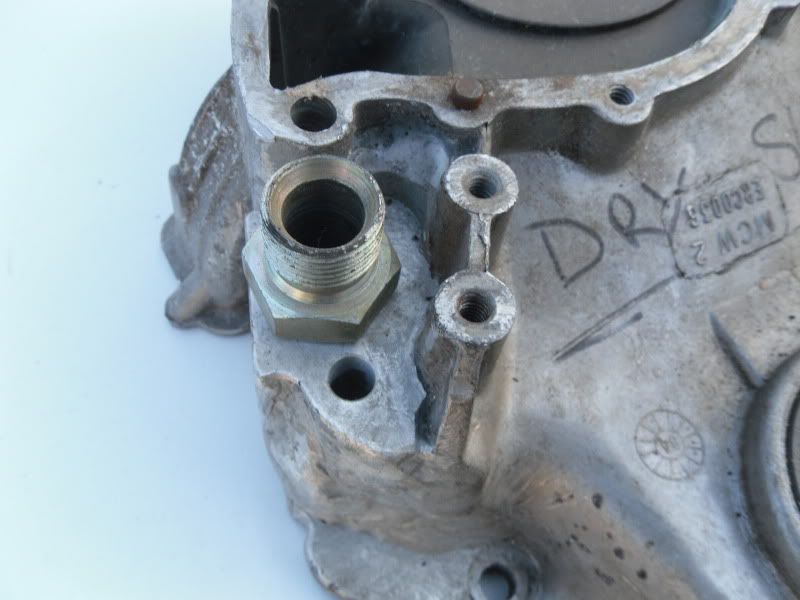

Modified cover..............

I think with those roller rockers you just have to use plain 3/8"UNC bolts to restrict flow in the pedestals. I have a set on the shelf like that, just run a bolt down the pedestal and it will be pretty obvious to the eye (the std Rover bolts are waisted for the oil flow up the pedestal).
Those rockers have no offset (ie not LH + RH pairs) so be very careful with alignment, I would advise making spacers + wavy spring washers and dumping the springs..

The rockers look great but I would certainly ditch the springs for spacers, you can make your own from some tubing.
Don't know if spends fix will reduce the flow enough, it's normally done by reducing the oil holes in the heads by as much as 50%
I may have already said this :lol: but do double check that the oilways to the rockers are clear, they do get gunged up especially the redundant ones which are there so the heads can go on either bank and if you fit the heads so they are reversed to the way they were originally fitted on an engine you could have no oil supply at all.
Kevin.

This is what I did to adjust oil flow.
Regards Ged
