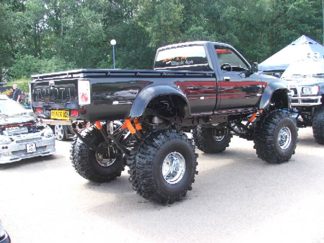

Heres one we built earlier.
It's a while ago but I should be able to remember stuff.
Think the springs are + 12" or there abouts and 3" on the body
Very pretty machined alloy spacers - don't buy an "off the shelf kit"
You'll pay too much for a load of useless stuff you don't need.
Someone on here will be able to get some alloy machined up and I think we have the longer bolts still.
Think the tyres are 39 1/2 x 18
Discs all round and hand brake on the rear prop (don't do this - use Sierra calipers on the axle)
There are some problems to get over with fuel injection but nothing
a bit of thought can't fix. We went for the polished alloy swirl pot and lift pump solution
rather than try to modify the tank.
Have more pictures if you need them.

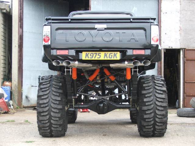

You only realy need 2 shocks on an axle but he just had to have 4 so we
made the 2 spares look like they were doing something.
If you want it to drive safely, you have to stop the axles swinging about so that means
stopping twist and latteral movement. We still have poly bushes and tube to do all this.
There are some pit-falls and some people you need to avoid.
Not going into it here but if you PM me, I'll tell you.
You know what I mean - experts that are just not and want your money above all else.

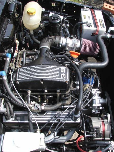

Progress so far.
Post by Risky »
Here's where i'm at, coming on Ok but no doubt the real fun/headaches start soon.
Engines getting there, still plenty of things to do but starting to look complete.
Attacking my truck, fingers crossed and away I go
Out with the old motor
Clean up the bay area
So coming along nicely. I'm now thinking ahead at the issues of fuel pumps, ignition coils, oil coolers, radiator, electric fans, sump clearance issues?...header issues...timing of the ignition and carburation...fitting gauges, oil pressure, water temp, RPM etc..etc etc :idea:
