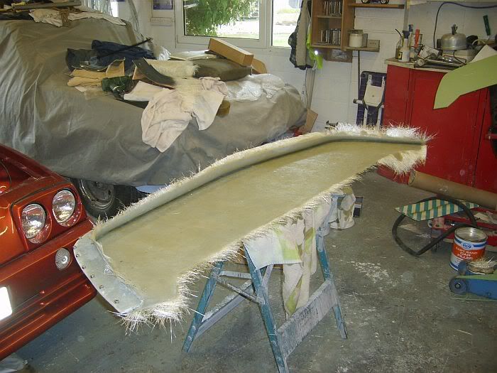

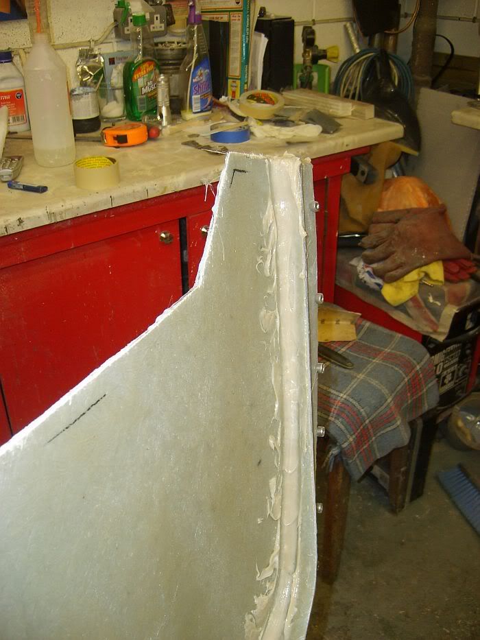

The gel cured off and then it was out with the laminate.
Putting the mould in the workmate and I glassed the tight radius first as I did with the gel and then layed the mould down and did the base.
I used just one layer of glass for this part of the project.
It needed a quick trim as usual and the mould looks like this after trimming.

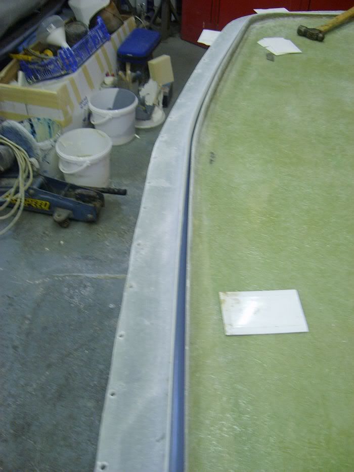

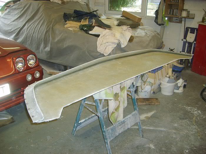

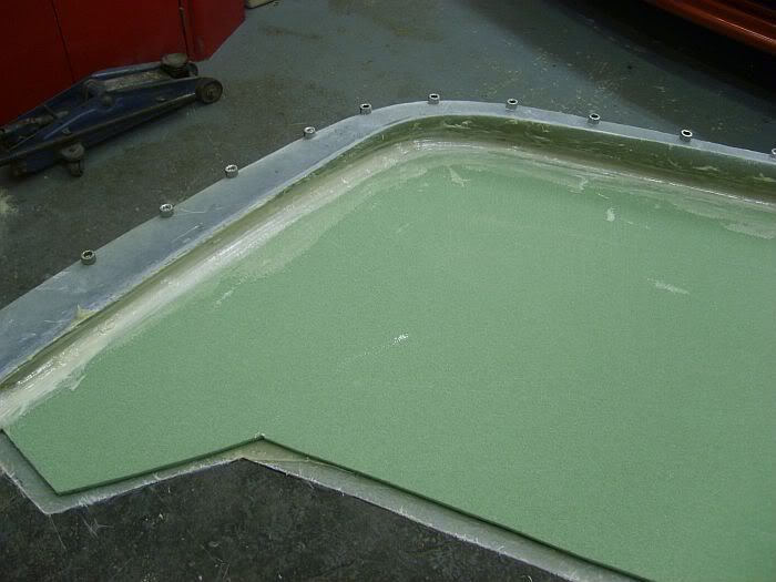

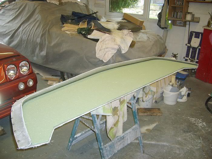

Next I got out a sheet of high strength PU foam and cut this to shape.
It has to fit quite snugly up at the front as I will be using a very strong bonding agent (Crestomer Jelly)to fix the foam into position.
This will give the splitter a great deal of rigidity and yet will be very light even with another layer of glass over the top.
This will tie the whole thing together and ready for the last stages of this project.

Hi Tom
The foam is rigid.
It has been the most expensive part of the job because I had to buy the sheet.
All of the rest of the kit that has been used is stuff carried in the vans on a daily basis.
We do use this kind of foam but quite a bit thicker than this (6mm is what is being used here).

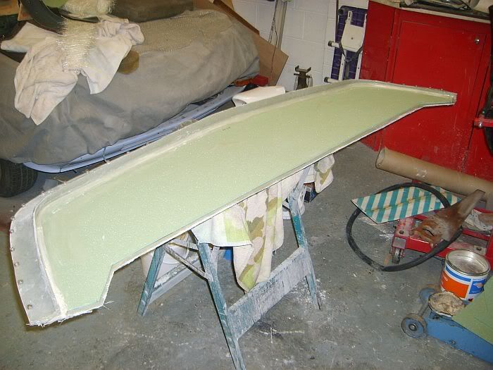

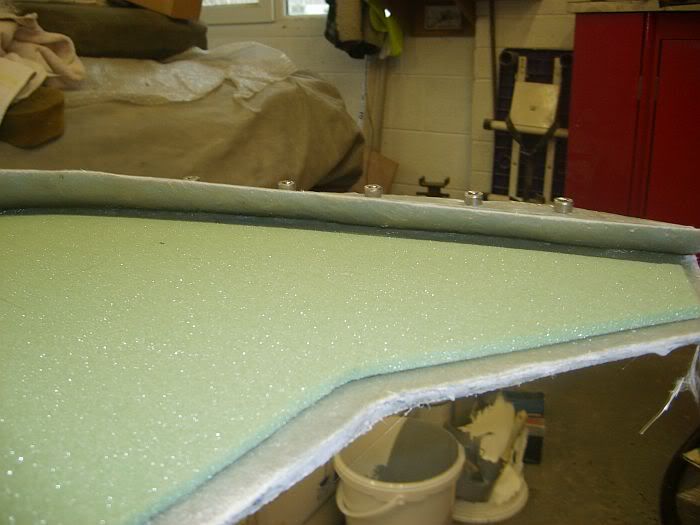

Here's tonights progress.

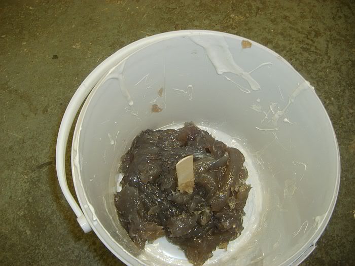

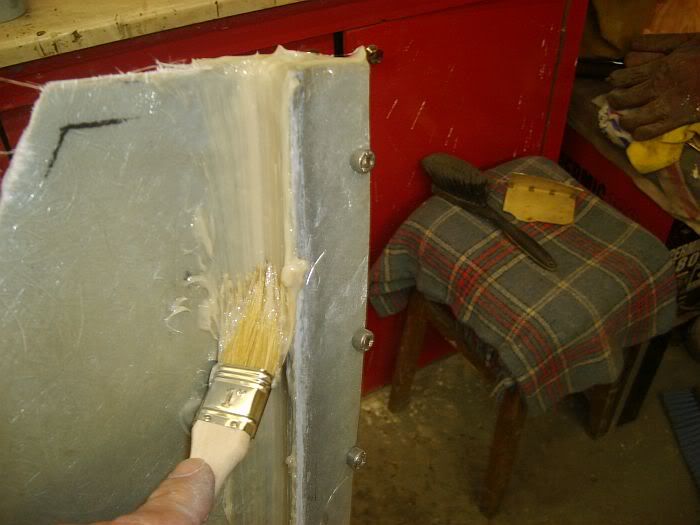

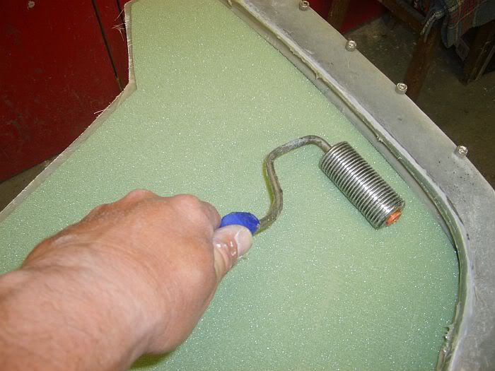

The bonding agent is just a jelly that turns rock hard once catalised and allowed to cure.
Once it was mixed up I 'buttered'up the internal radius and then ran over it with a brush to make sure that the jelly went right into the radfius at the front.
With that done I then used a body filler spreader to skim the base of the splitter with the crestomer and then placed the foam on top of that and then rolled it as flat as I could.
After that it was a quick splash of jelly all around the front of the foam and then a bit of coving,again to get a nice radius and then a final lick over with the brush to make it all neat and tidy
This must now be allowed to cure for a day or so and then the last lot of glassing can be done along with the mounting braces and it will be ready to release from the mould.

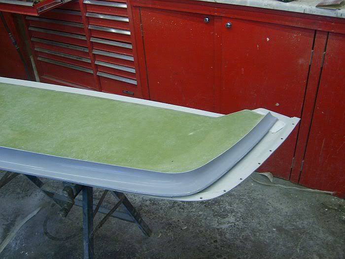

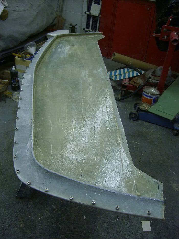

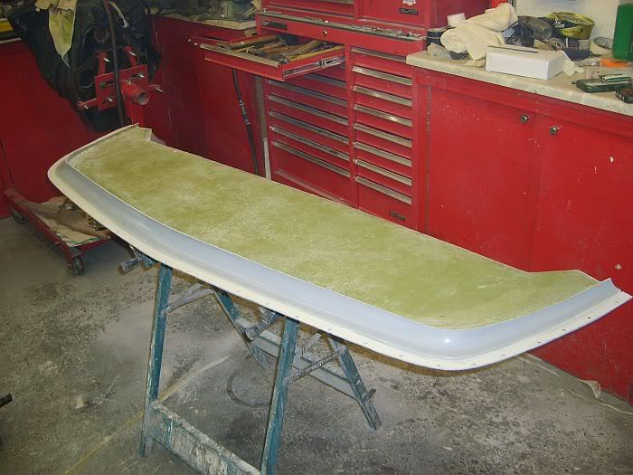

Having completed the last layer of laminate (you have already seen how the glassing is done so no need to repeat that process) I come to the really fun bit and see if what has been made is actually any good.

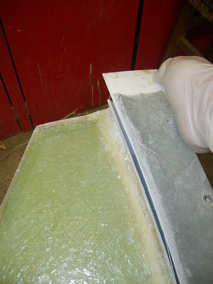

After releasing all of the bolts around the mould (it could be heard to release itself as it was unbolted) a body filler spreader was pushed between the top and bottom sections of the mould and it started to come away very easily.
Running the spreader around the front face of the mould resulted in the upper section poping off without drama and I was left with this.
Then it was the same again around the bottom section of the mould and I ended up with a fully released panel.
As you can see there is just a very small amount of gel flashing that needs to be sanded back to make the front radius good.
All of the prep work that has gone before is so important and you can see how ,at this stage ,it pays dividends to the final thing.

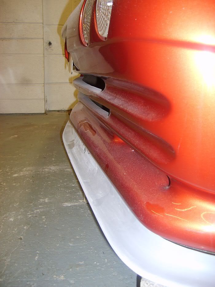

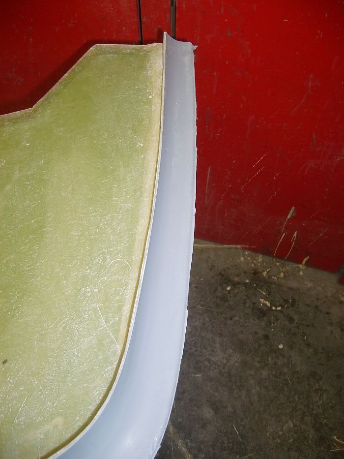

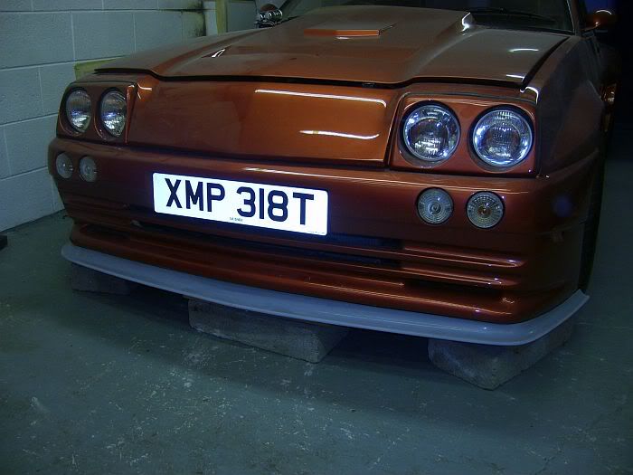

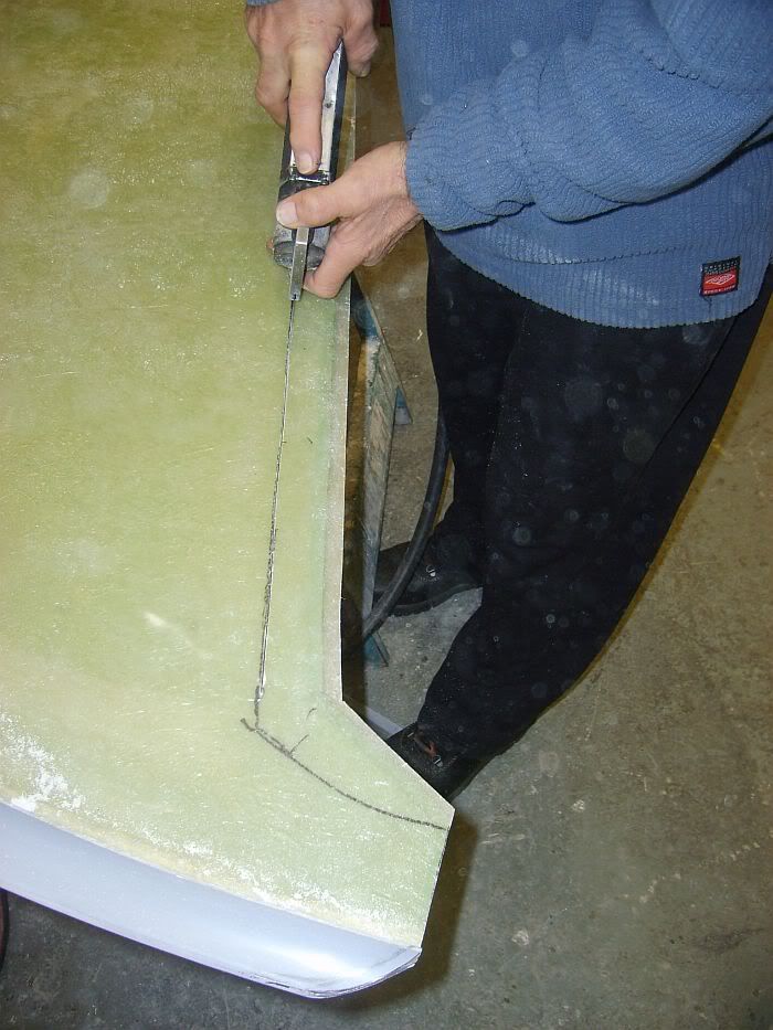

Offered up to the bottom of the car all looked good so it was time to scribe the final lines and make good.

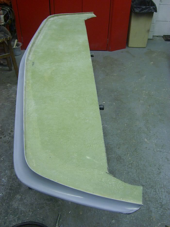

The trailing edges needed to be radiused a little to make it all flow and this is how it looks now.
The last thing to do was to profile the back edge to the existing panel on the lower section of the car.
All I need to do now is to get hold of some grommet strip and then I can glass in the mounting pads,let them cure and then prep and paint.
