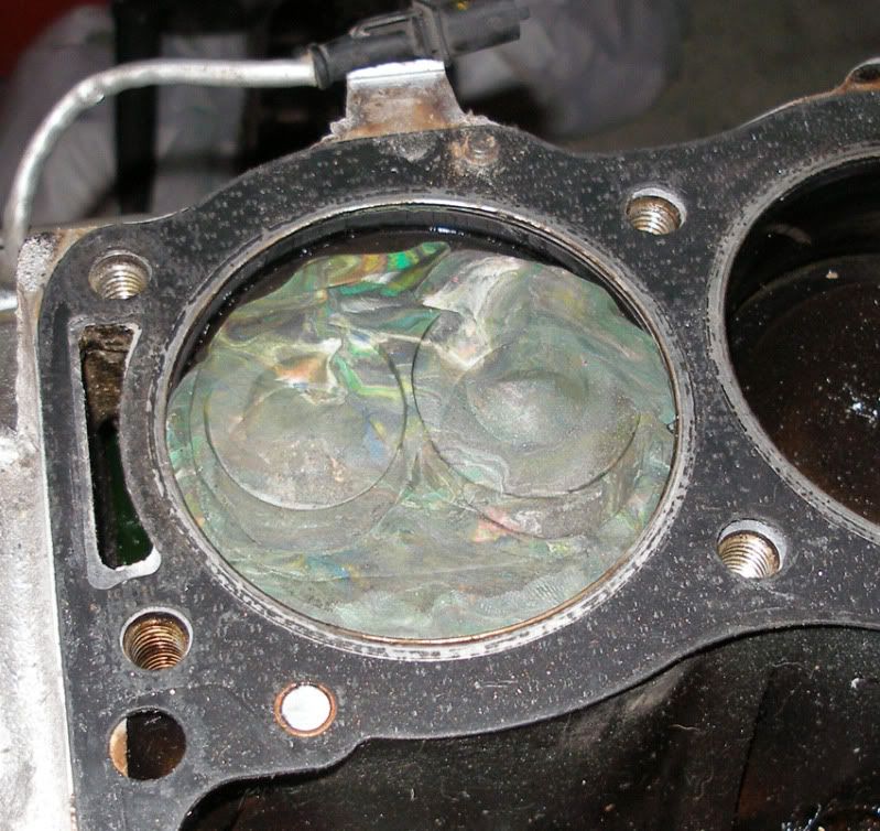

<a href="http://s76.photobucket.com/albums/j30/V ... sition.jpg" target="_blank"><img src="http://i76.photobucket.com/albums/j30/V ... sition.jpg" border="0" alt="Valve position"></a>
Photo shows SD1 and merlin valves, must be approx 10mm difference between thir position.

Now I cant remember how to do photos hope this works

Interesting picture, can see the valve position in relation to the centre of the bore but not the edge.
To check clearance remove the valve springs on one chamber and with some engineers blue on the valve perimeters refit the head with the piston at TDC and rotate the valves, that should show exactly where the valves are in relation to the pistons. If that isn't clear enough a thin layer of plasticine on top of the piston will show the valve pattern more clearly.
Check you have sufficient clearance for the lift of your cam + a tolerance of 1-2mm. for a bit of extra comfort.
You probably will not need to replace your pistons, unless you have other reasons for doing so.
Kevin.

Sorry its not very clear.
Pic is of an Old 4.6 short block. I put one piston near TDC and pushed in some plasticine, then removed a couple of valve springs from each head Then starting with the SD1 head I placed it on the block and tapped the valves with a rubber mallet to get an impression. Then put on the merlin heads and did same. Just to get an idea of where the new valves are in relation to my old cutouts. Think I might get away without additional cutouts but when the time comes i will have to do a proper clearance check.
