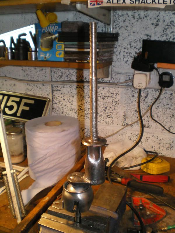

We just moved the gearstick forward to get it in the middle of the tunnel hole on my mates MGB by cutting it off and refitting as per photo.

i htink i mite have to go 4 or 5 inchjes forward tho.

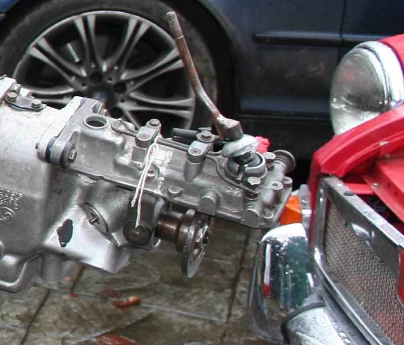

The MGOC supplied me with a shortened remote assembly. You can see the weld just in front of the string. A support just behind the string was also repositioned.
They cut it too short so I had to do a similar mod to Perry's but mine was not so neat. (The lever is in back to front in the pic, honest :oops: )
JC.

If you need to move the stick 5 inches further forward, surely you'd be better off with the Sherpa remote rather than the SD1 remote?
Image -JC.
