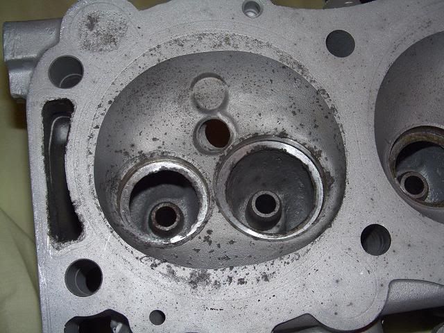

Just to touch upon the thread topic again :P Here's a pic of the worst of my buick heads. In actual fact the damage looks far worse in the pic than it actually is but to find these heads with none of these sympoms is rare. I saw a good pair that a guy in preston had and I believe one of the guys on here bought them.

That would be me :)

The ones I've been looking at are a bit worse than that Marcus. Like you say though, 40yr old alu heads aren't gonna be perfect!
