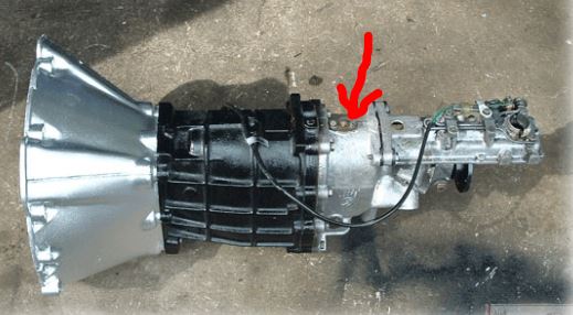

Post by Coops » Fri Sep 28, 2007 3:36 pm
Gear box identification
the identification marks can be found on an oval lug near the base of the box
G16A SD1 2000 (Could be 4 speed)
G17A SD1 2300/2600 5 speed
G19A SD1 3500 SE/VP 5 speed
G22A SD1 3500 Police spec 5 speed
G23A SD1 2600 Police spec 5 speed
G26A SD1 2400 Diesel 5 speed
G27A SD1 2000 Later model 5 speed
G28A SD1 Vitesse 5 speed
G30A Sherpa Range

Post by paulmanta » Tue Jan 15, 2008 6:39 pm
Sorry about posting this in a nice tidy topic but i have what i suspect is an LT77 box, It looks the same as an LT77 i am fitting to my Manta but when i went to try and ID this box from the oval flat area by the drain plug i found that not only was the number not there but the machined area was missing too, it was just a plain casting from the factory, i can find no other numbers anywhere.
Any idea what i have here ?

Post by paulmanta » Thu Feb 07, 2008 7:52 pm
Numbers stamped on the bottom of mine near where it joins the back nose casting, looking at the list it suggests its an SD1 police type. Nice !
