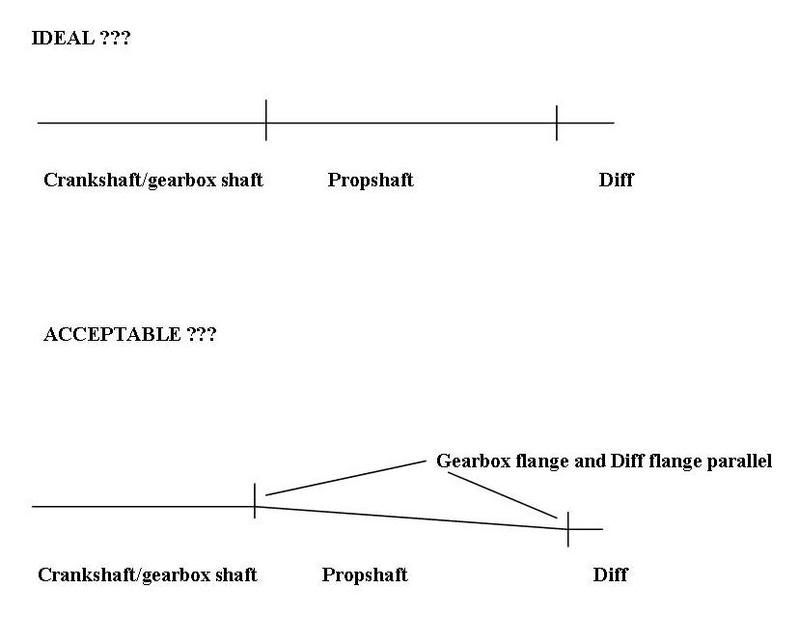

Seems to me that this is somewhat over the top and though it may well be the ideal situation, in practice is seldom achievable.
So, am I right in thinking that so long as the flange on the gearbox tailshaft is parallel to the flange on the diff and the prop is not at too steep an angle between the two then all should be well?
