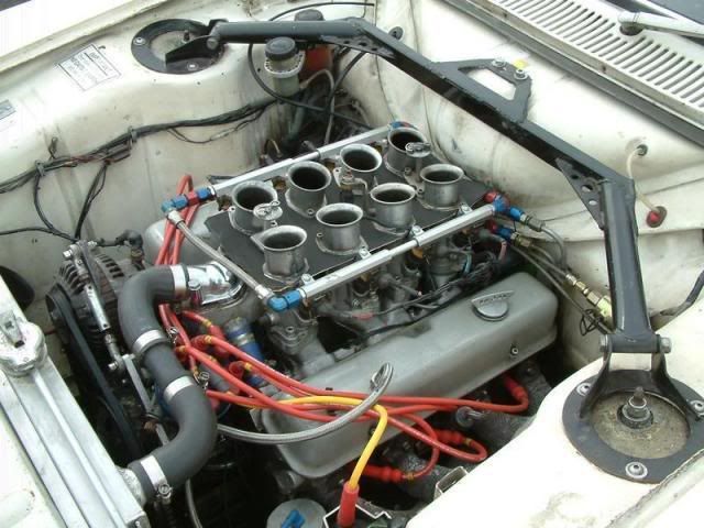

45s will be fine, 4x45s will easily support 375hp, Dells are much better than Webbers for staying in tune, but you do need someone who knows how to set them up. But if they are way out of range to what you need take a deep breath, it wont be cheap, there is 8 of everything to buy,
45s will give you much better throttle response over bigger carbs, and better fuel consumption as you wont be at WOT to overcome low gas speed flat spots, but the smaller carb will be much better to drive,
They will SOUND AWSOME, dunno if the sound on this clip is any good, but play it LOUD!! it was running a bit rough/slow there, thats why the bonnet is off, 3 runs later I blew up the engine
http://uk.youtube.com/watch?v=6ta5Ke6Xrho
water neck/thermostat I got around the problem by using a Moroso remote thermostat housing and welding 2x25mm pipes in at the same angle as the pipes coming out of the manifold, you can just about see the housing in the pic below joined with silicon pipe.
The fire thing is only seen on sidedrafts, normally set up badly so fuel drips out of the bellmouths onto somewhere in the engine bay and a wee burp from the carbs sends it up in flames, Im not saying they WONT go up in flames, any car that has peterol/spark in or near has the ability to burst into flames
Fuel pressure problems, I dont see why this should be any more of a problem than any other carb.
As such I dont run a normal style filter, I use a large airbox fed from the front panel with mesh filters in front of this, If I have the Airbox off, I have a set of 8 balls strung together I pop over the trumpets just to keep small birds falling into the engine

Thanks for the pic and the video!
I'll need to do some thinking!
