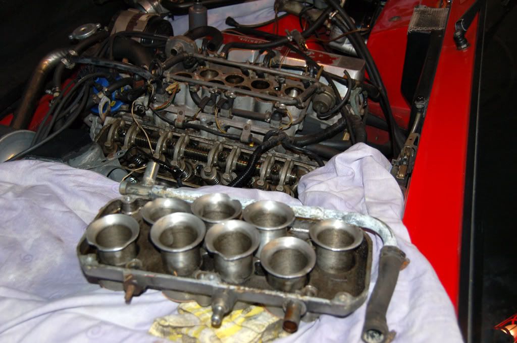

Hi all, just signed up to what looks like a great site. I found it as i have a bit of a problem at the mo with my TVR Wedge. It's a J.E. Engineering 4.5 conversion & I've lost compression on one of the cylinders & it makes a loud HSSSTT as you turn it over. I've just started stripping it down so being a relative novice I'll be welcoming any advice or tips.

I would go for head gasket failure, and it's very straightforward to strip the engine down enough to see.

Head gasket would be the first place I would look too but I'm hoping you can get the manifolds off without too much trouble. On the Chims and griffs its generally quicker to take the engine out then try to get the manifolds off in the car.

So far...
The culprit from the top;

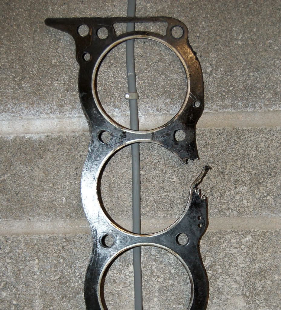

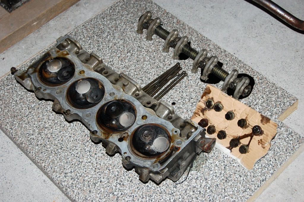

& the culprit is........

re - leaving bolts out - DONT DO IT !!
Post by ozrover »
Looking at the pics you have late 10 bolt heads,which dont have the outer bolts which can be left out or left semi lose.The gasket pictured has only 4 bolts around each cylinder,these heads are the redesigned ones which eliminate the outer row bolt problem.You need to fit all the head bolts and torque them equally.I have just stripped down a late 4.6 which had several loose bolts on late 10 bolt heads in the outer row center with similar damage to yours starting to form on both gaskets,though it was still running.

Only 10 bolts were in the head so I must assume that the problem bolts were left out in the first place;....

Ok from the last pic you posted they are 14 bolt heads but as you say thay have had the outer row of short bolts left out.Were there caps blocking off the holes for them?The gaskets in your pics are the later 10 bolt type meaning either tvr left the outer bolts out or the gaskets have been replaced at some stage.To be sure I would be fitting studs to prevent any chance of the bolts getting loose in the future.
