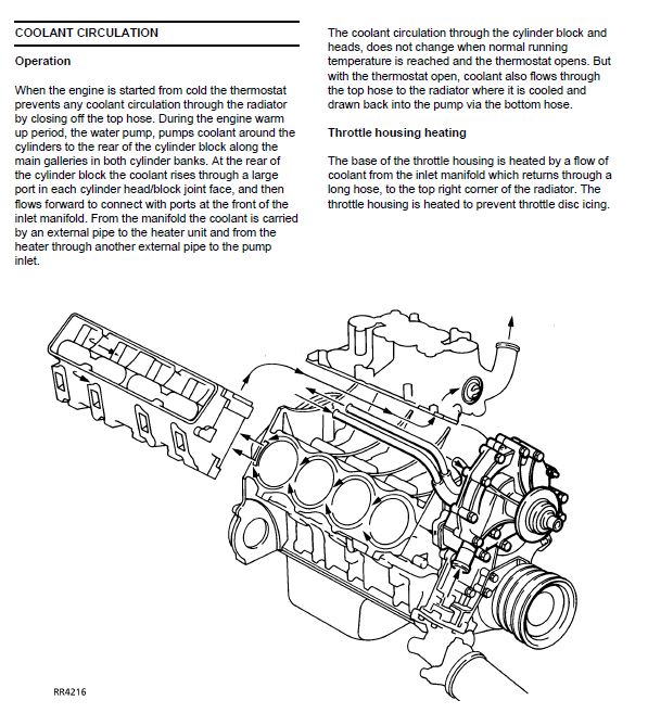

The coolant from the bottom hose on the rad gets sucked in via the pump. However, the the injection manifolds, the rear water ports in the head a blocked off......So, is there a way for the water to circulate from the rear cylinders to the front cylinders along the cylinder head. I cant help feeling that as the rear ports are blocked, and the pump and top hose feed to the rad is at the front of the engine, the water circulation in the rear most cylinders is compromised. It would make sense if the coolant could flow up into the head at the rear and then make its way back along the head to the thermostat outlet that feeds the rad.

I think I've answered my own question....
Seems coolant is pulled into the block via the pump then extracted from the block via a slot port at the rear of the cylinder heads. it then flows along the cylinder head to the front of the port in the cylinder head and out into the the inlet manifold.....

Think you got there in the end:
Re: Water flow around cylinders and heads.
Yeah, you've got it.
If the rear ports on the heads were not blanked off, then the water would come up from the block straight into the inlet manifold, missing out the heads entirely!
Once in the inlet manifold, it either goes forward to the thermostat, or out of the rear to the heater (depending on manifold!)
