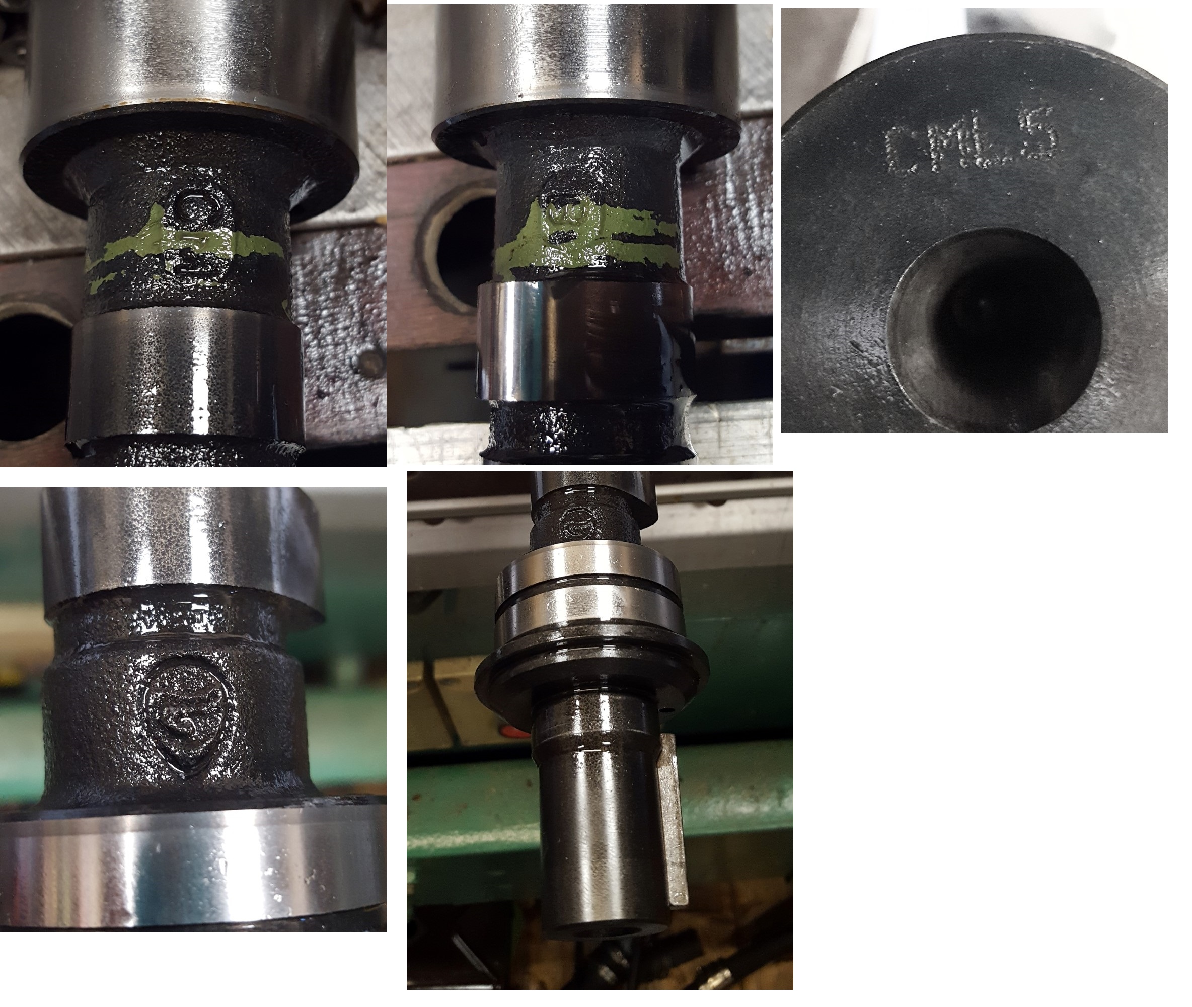

The 4.2 cam I bought several years ago came in a eurospares box with err5925 on it, but it doesn't match up with any of the specs from the rave post, inlet centerline at 117 and exhaust at 113, so I am waiting on another err5925 to arrive. The duration figures from rave are at about 1thou lift on this cam.

Both cams have green paint markings the same.
I seem to be getting the same figures with both, inlet opens 14 BTDC closes 84 ABDC exhaust opens 63 BBDC closes 29 ATDC
278 duration inlet with 117 ATDC peak, 272 exhaust with 113 BTDC peak
Neither match the supposed figures from Rave.
Not sure whether to buy a Cloyes timing set and advance it 4 degrees or stick with it as it is.

The specs from LR don't seem to match the cams that are actually supplied though, the measurements taken from both cams that I was supplied as 4.2 cams are in my post above, the intake duration I measured was 278 degrees not 272. I am hoping to get my 4.6 running soon after I get home at Easter.
