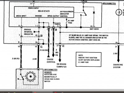

Thanks for your ideas everyone. The BMW sensor is definitely a reed switch with two wires and I don't think contains any additional components. In a BMW its connected to ground and the instrumentation and may be switching lower voltages/current than I am.
I've tried the Jaycar which on paper looks great, but it didn't even sync with the reed switch, so I bought a second one thinking the first was faulty and that was the same. Checked the signal and it swings 12/0v 7 times per revolution.
I think the idea of the transistor is a good one to try, the existing wiring is below but I'm really surprised at the lack of information on that Rover sensor Would you mind just doing a rough sketch so I get it right!

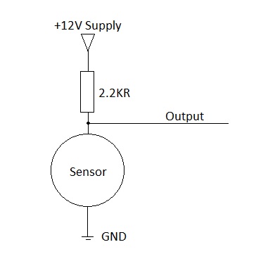

Adding a transistor will do much the same as your circuit. Just may help protect the reed switch in event of a short or whatever. I'll draw it out later.

If you have time it would be really appreciated Dave. I do wonder if I'm getting some sort of bounce/arcing on the Reed, so having the transistor as a buffer will help that side. Equally it may enable a more definitive swing on the output of the transistor if I can run more current through it.

Re: Speedometer and Sensor Compatability
Here's the added transistor:-
And all I have about the speed sensor.

That's really helpfull, thanks for the circuit diagrams, I don't know where you got the one for the pulse generator because I've spent hours searching and the very limited information was contradictory! Dave from the diagram whats your best guess of what the output might have been, a share wave similar to what I have now or something else?

Just realized you wanted debounce for the reed switch. The circuit I've posted likely won't help that. I'll dig out one that does - only a couple more components.FarnhamStag wrote: ↑Fri Aug 06, 2021 7:40 pm That's really helpfull, thanks for the circuit diagrams, I don't know where you got the one for the pulse generator because I've spent hours searching and the very limited information was contradictory! Dave from the diagram whats your best guess of what the output might have been, a share wave similar to what I have now or something else?
