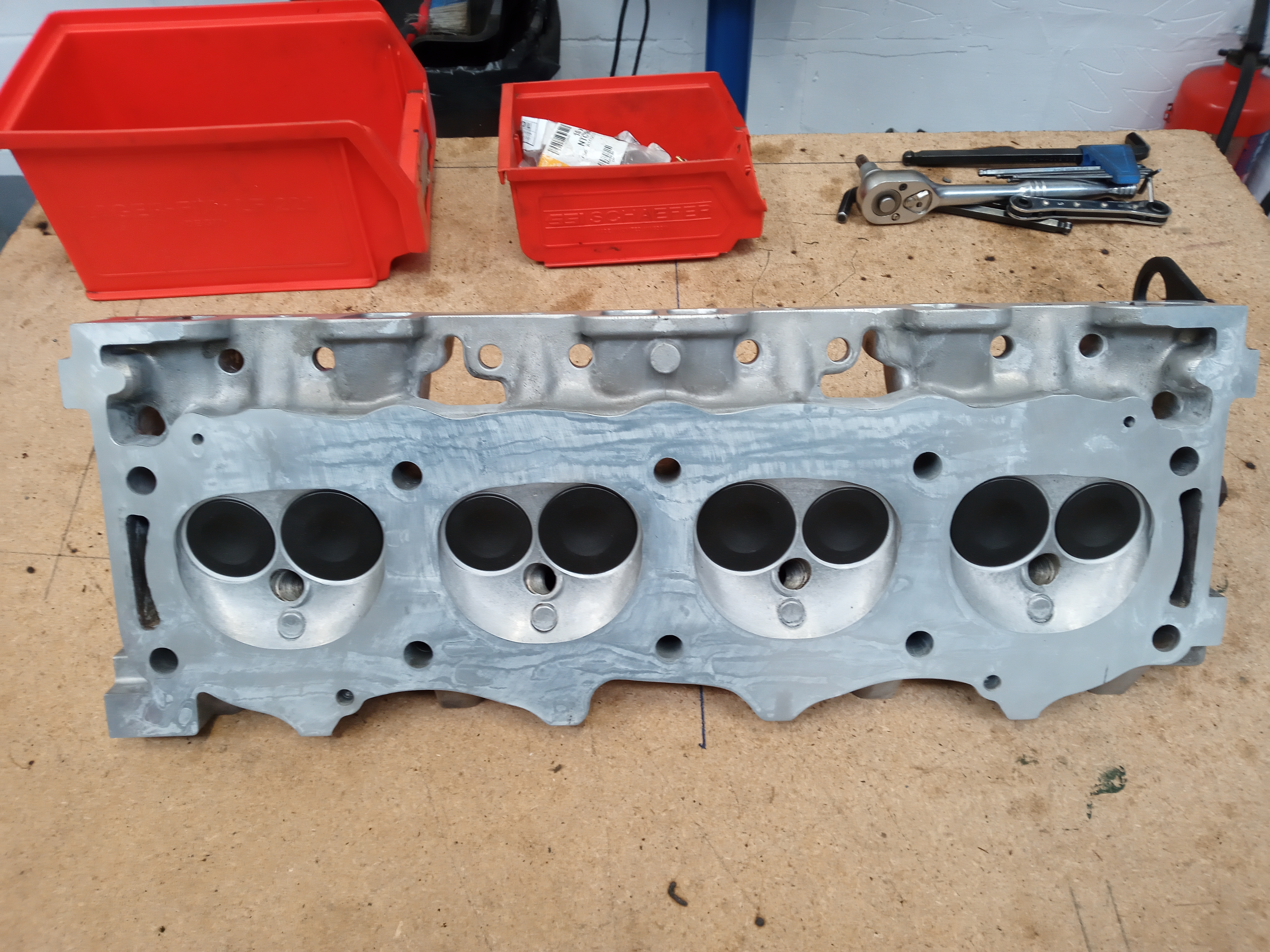

This is what I started with. The top head is as delivered and the bottom one is the other one after a clean up with fleet wash. Normally I'd get them hot tanked but that's not an option so lucky for me that I'm a bit OCD and have lots of free time.
I'm using a selection of carbide burrs in either an electric die grinder or my trusty Dewalt battery drill. The drill is a bit slow which does make the burrs chatter a bit but the die grinder can be very aggressive and it's easy to slip if you're not very careful. The drill is also much slower, but as time isn't a big issue, I can live with this. I started off with the exhaust ports and gave them a light clean over to remove the line where the casting core join runs down the port. I'm probably removing less than 1mm material here to clean up the port and the opening at the gasket face is still smaller than the gasket itself.
The inlet ports were treated in a similar manner and as recommended by others, some additional material was remove inside the port adjacent to the pushrod hole where the port is at it's thinnest.
