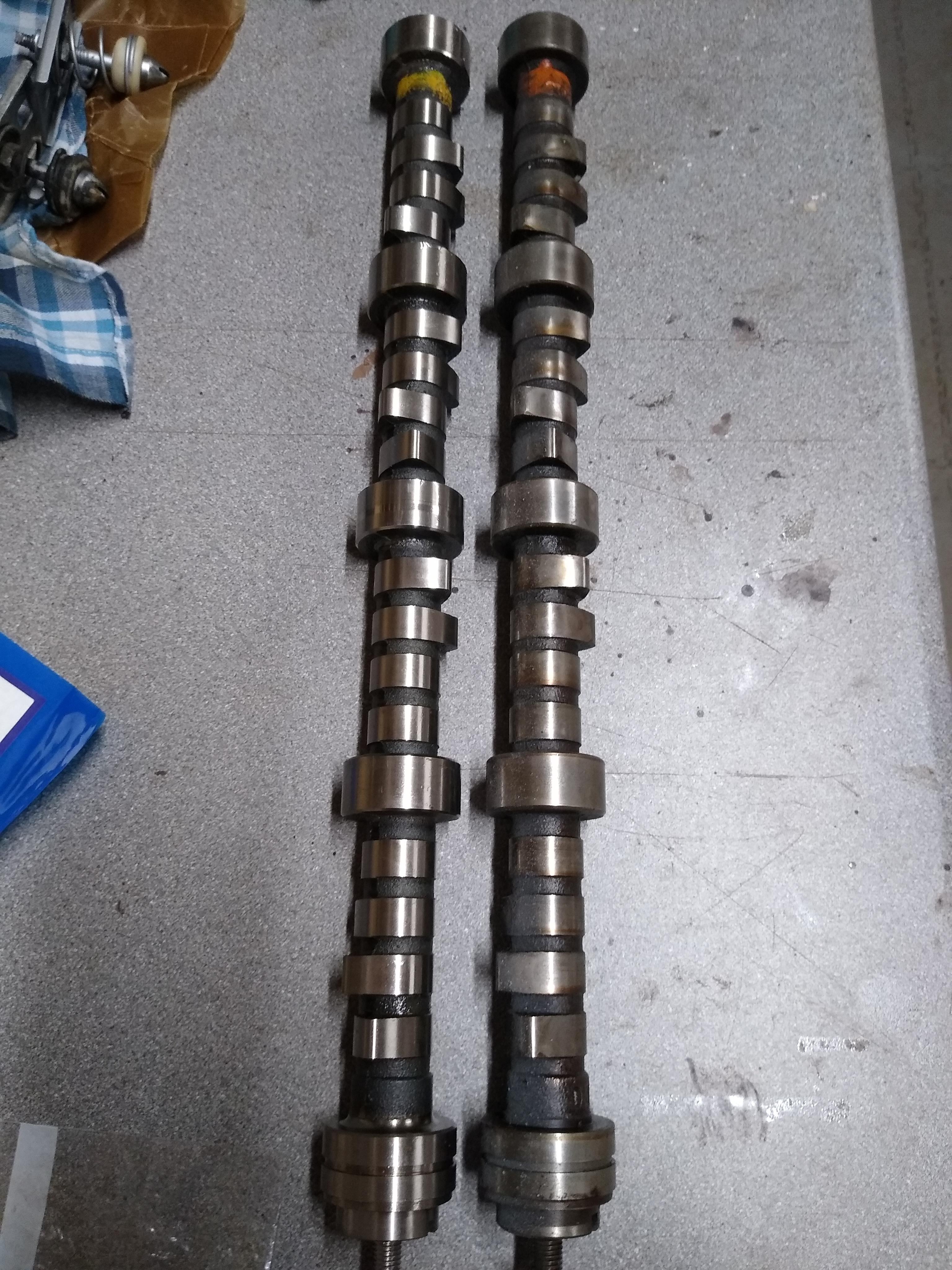

new to the forum and rebuilding a 4.0 GEMS engine. I have a new standard camshaft and the block has a horseshoe thrust plate.
There is 5mm end float which is a lot more than the workshop manual specifies.
There is no groove for the thrust plate to run in it just sits on the front of the block and the cam can move between the plate and the back of the block.

The original camshaft is exactly the same dimensions as the new one and the horseshoe thrust plate is the original one and I would expect it to have the same effect as a full circular one. The engine is a replacement LR one so the age is unknown. The only oddity is the different colour marking.

it is strange there is really no where else to look at the moment. There is nothing at the back of the block, no mounting point or spigot. There is no way of mounting the short nose of the cam to any thrust plate. All a bit odd.
