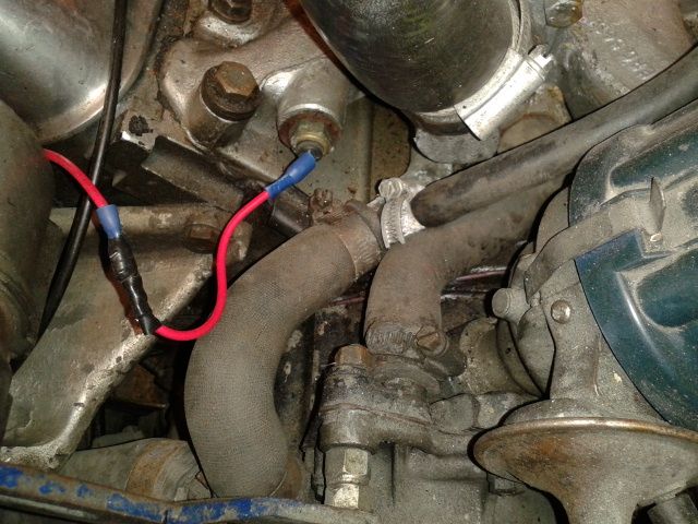

OK. If you have got room for that 'U', you can get flexible hose on there to wherever you want your heater. Just remove the U, and there are your two connections.
The small one with a bolt is the vacuum feed for an automatic transmission. Clearly not needed! You can hook up a vacuum gauge onto it if you want another clock on the dash that moves in an interesting way!!

Chris could I use just one of the rear connections and the one in front of the head?It would be easier to insert the heater valve in a pipe that was more or less in line with the heater cable rather than having to bend downwards if I routed the heater pipes direct.

The pic is a bit deceiving making it appear there is plenty of space available but I wedged the camera well down in the engine bay to take it.Bear in mind the original Wolseley engine in here was a puny 1500cc 4 cyl.The bulkhead has been moved backwards to squeeze the v8 in but still is maybe 4" forwards of a vertical line down to the heater pipes.

The upper connection of the two pipes in your photo is where you have a straight flange bolted to your intake manifold. The 90 degree fitting I have in my photo is fitted at this same point.
Posts: 5077
Muscle-Manta wrote:The upper connection of the two pipes in your photo is where you have a straight flange bolted to your intake manifold. The 90 degree fitting I have in my photo is fitted at this same point.
Yes, so use that one to feed the heater. Use Muscle-Manta's 90degree elbow if it helps.
Trace where the other pipe goes which should just be a straight run under the inlet manifold in steel to another flexible pipe to the water pump. Remove the flexible pipe, and reroute that connection wherever you like to give you the room for the valve.
Just bear in mind that if the thermostat bypass has been removed, that heater 'U' might be being used as a substitute, so if you put a valve in it, the cooling system won't work properly.
Maybe a pic or two of the rest of the cooling system would be in order.
