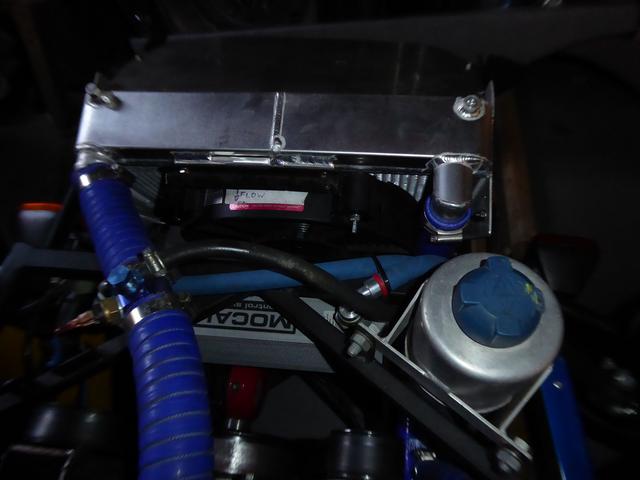

The fans are are both sucking from the grill, through the rad and into the engine bay. One fan is controlled by the MegaSquirt, the other is manual switch on the dash.
Hopefully the sketch and pic might help explain the current set up.
It's not overheating but running on the limit, both rad hoses are hot. Hoses are hard when running but soften on cool down so not liner issue?
Tried turning off the heater but no improvement. Would clamping the hose be any different?
Bottom line is, I don't know if it ever worked properly. The cars done about 800 miles since the re-shell/conversion but may have only covered short trips as the old flapper EFI was massively over fueling.
Not sure why it has two rad caps??
Mal

It's actually a Vitesse plenum that's had a section cut out and rewelded. The inlet trumpets were also shortened to suit. I gave it a clean up and respray while it was off the car.
If you look closely, you can see the TPS bracket that I made from the drawing you supplied me a while ago. Thanks again for that.

Looking at your layout, I suggest that you put a plain full seal cap at the top hose and not a pressure type. This will allow coolant and any air to flow up to the header tank from the onset of temperature rise.
Just to add, I've heard that MGBs run cooler in the summer when the heater is off because hot uncooled coolant is not then flowing back into the block and bypassing the rad.

Looks strange to me;
You have the small pipe on the right of the inlet manifold going to the coolant pump inlet.
This is normally fed to the high point on your cooling system to bleed any air out of the cooling system, this is acting like your thermostat bypass circuit, but any air in the system will just get circulated back into the pump inlet.
Also what type of rad cap do you have in the top hose?
From the way you have drawn it looks like you have designed an overflow type system, which needs a certain type of cap in the top hose (with a double seal). Once the coolant reaches the cap rated pressure the fluid expands into the BOTTOM of the catch tank. When it cools it sucks in this coolant back into the system.
Your tank looks like it has the inlet port at the top? does this have a dip tube internally to the bottom of the tank?
Can you share more photos of the tank arrangement? and pressure caps?
madmal007
Posts: 12
Joined: Wed Apr 07, 2021 7:44 am
Re: MGB V8 EFI Cooling Problem
Post by madmal007 »
The small pipe from the pump is the supply to the pre heater on the plenum chamber, the return from the pre heater used to go to the small inlet connector on the manifold. I have bypassed the pre heater so connected the pipe from the pump straight to the manifold.
The radiator caps are all standard.
The expansion tank has a bottom connector that goes to the top hose but its not so easy to see from the pics. The top connector on the expansion tank is the overflow.
I've fitted a new alloy rad, which was larger than the rad I removed, so I'm now not even sure that the existing rad was the correct one. Either way, it has improved the cooling. I've also relocated the front number plate as it was completely blocking the air flow to the bottom section of the rad and the oil cooler. I've also rewired the fans so the MegaSquirt controls both fans rather than just one.
Hope to get out today for a test run.......
