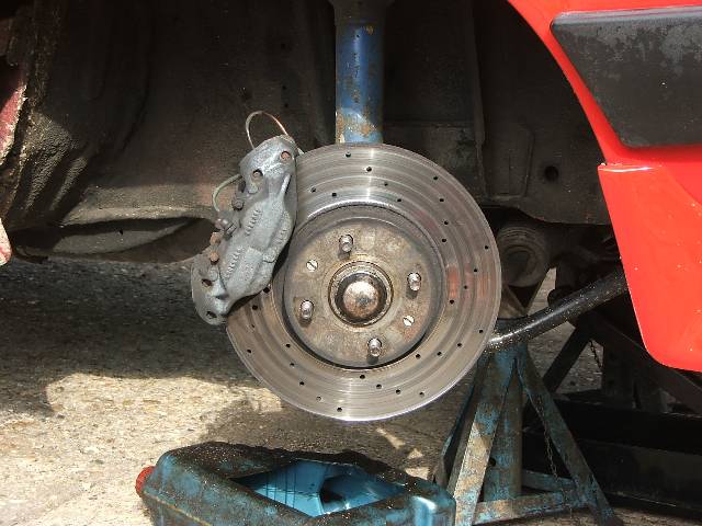

Old brakes before removal:

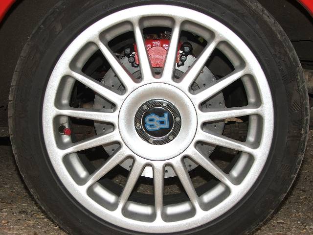

New 315mm cross drilled and vented disc fitted, along with center hub locating ring:
Wheel and new alloy 4 pot Brembo calliper fitted:
and another side view: (they are 16" wheels)
All i can say is:
the 4 pots we took off were great and stopped the car great,
BUT these are fooking animals and stop you on a sixpence,
All i can say is:

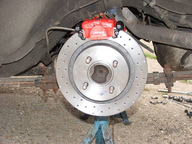

the rears got the treatment today:
New rear caliper brackets, along with even longer wheel studs:
New vented cross drilled disc fitted:
New vented caliper now fitted too:
End view of vented disc:
Pic with wheel refitted:
