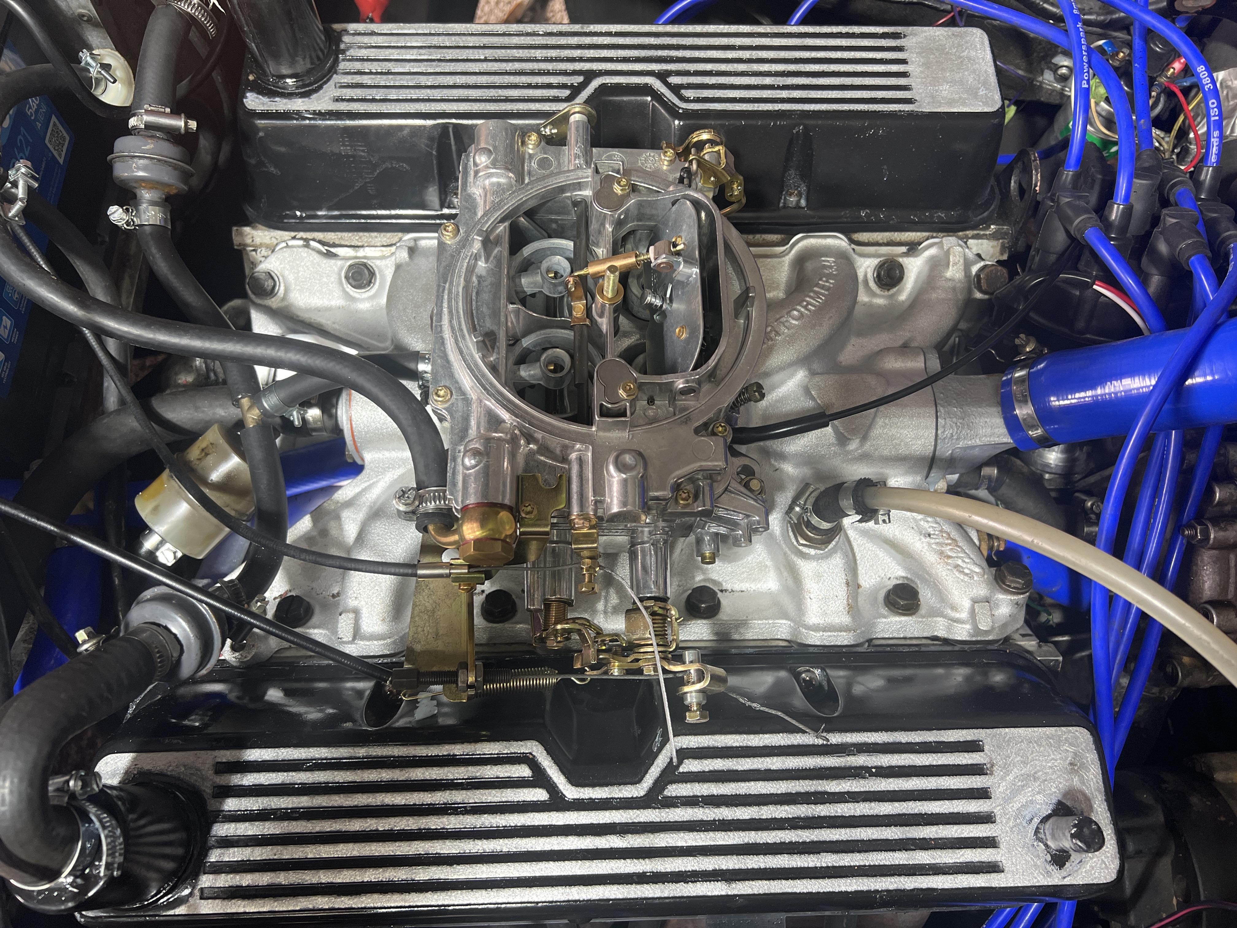

Well, I learnt to do a lot in the last few weeks! New cam, followers, pushrods, inlet manifold, carb, dizzy and ignition system.
Runs like a dream (so far!)
